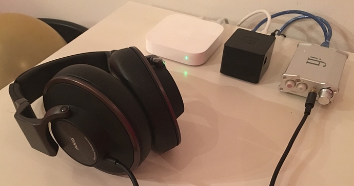

Following the footsteps of the great @andybob and his adventures in NAA-land, I got myself a iFi nano iDSD to get a taste of the DSD upsampling features of HQ Player. The nano is a nice, little DAC/Headphone amp combo (up to PCM384 and DSD256) that sells for an agreeable €225. Perfect for a nice cozy headphone zone, so I can filter my heart out without annoying my family.
Since Cuboxes are dirt cheap at the moment (the Cubox-i1 sells for €30 over here, the i2 for €40), I got myself one of the mysterious little black cubes (i2). Installation was uneventful as expected: flash Signalysts Cubox image to SD-card, plug in network, USB DAC and power – and the NAA immediately appeared in HQ Player.
I will eventually build my own install based on Armbian just for fun, but for plug & play Jussi’s image works gloriously.

An Airport Express in Ethernet bridging mode. I had a spare one laying around – the power plugs I intended to use introduced unwanted noise, so they were thrown in the bin rather quickly.
