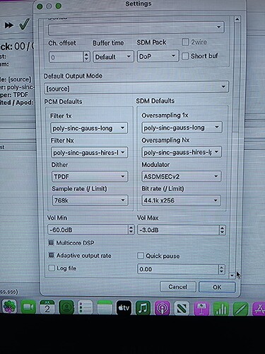

Nothing to configure on the Pi, unless you are already running another Pi with same NAA image ?
It’s easy to get Roon to play to HQPlayer but thats step 2. Step 1, need HQPlayer to see your NAA and DAC
All the times I’ve had an naa not show up it was network or firewall related and the naa was not being discovered by hqplayer. One thing to note, sometimes if prefs are open, to get the backend device to update/refresh, you need to switch the Backend to something other than what your on and then go back to what you want.
Is the naa showing up in your routers active dhcp leases?
I’m not sure if it matters for naa, as it usually messes with incoming connections, but is the Mac firewall enabled in Security & Privacy? If it is enabled, Is hqplayer allowed incoming connections?
Are you using little snitch or hands off? If so are they blocking any connections?
