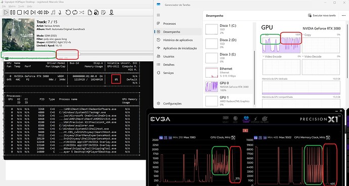

Hello, so, I tried reinstalling Nvidia drivers and installing HQP 5.10, It didn’t helped…
I noticied that the music start stoppping or stutering as soon the GPU hits 95%~ on Windows Task Manager, however, when running “nvidia-smi -l 1”, it show exactly the opposite, as soon as it hits 90/100% on Task Manager, it drops to around 8% on "“nvidia-smi -l 1”…
Do you have any idea what could it be ?
Also, the GPU clock and the GPU Memory Clock all goes down as soon it hits 90/100% on Task Manager too
Green = normal playback
Red = stutters or just stops playing as a whole…
I don’t think it’s a power problem as my power plan settings are all set to max performance.
The GPU is not overclocked or undervolted, it’s all stock.
The log file of HQP also don’t show anything special, it just logs when starts playback, don’t show any errors.
Your limited counter is at 16, so at least volume control is turned too high for this content. Please at least never turn HQPlayer volume higher than -3 dB. Because even for regular content, you will need at least 3 dB of headroom for inter-sample overs. When it begins triggering limiter, it becomes much heavier, because it needs to reprocess fairly long portion of already processed data, possibly multiple times in row.
So set your HQPlayer volume to -3 dB, if it still triggers the limiter, turn it down in 1 dB steps until it stops happening. You can then leave the volume there. But keep eye on the Limited counter for some time, since it depends on the content.
Overall, those settings are not particularly heavy and shouldn’t cause any issues with your hardware. Resource monitor in Windows Task Manager can show pretty bogus GPU load information when CUDA is in use, nvidia-smi is more reliable. But it also depends on the load graph sampling interval how it coincides with the load pattern.
That was exactly it.
Thank you!
For some reason I had it at 30dB lol
Working perfectly now!
