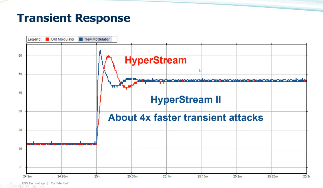

  • His transients plot is really interesting - how does EC modulator step response / transient plot vs non-EC modulator plot look? I assume HQPlayer EC modulators have an improvement in transients ! Maybe the key improvement?

Not that one, but I’ve seen similar things before.
They use 64 while my DSC1 design uses 32. But otherwise similar.
I think that is what I’ve been also saying. Major problem of PCM.
Here’s some with my older non-EC modulator version and DSC1 DAC.
7 kHz square wave at DSD256:
You can also see it is nicely stable:
But Mytek Stereo192-DSD DAC did it already in 2011.
