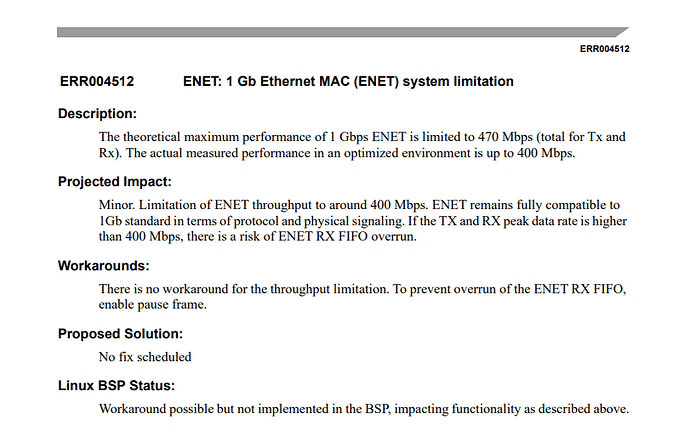

Usually if you get such dropouts in a setup like yours, it is due to networking problem between sonicTransporter and Rendu. Since Rendu hardware has limited network bandwidth capacity, it requires properly functional ethernet flow control (802.3x). This is also needed for reliable functioning in any case. Otherwise there can be too much packet loss. Flow control ensures that there is no packet loss.
On a gigabit network, Rendu hardware can reach 400 Mbps speed, but only when flow control is properly functioning. Otherwise the achieved bandwidth can fall well below 100 Mbps due to packet losses and resends.

Roon uses different kind of network traffic pattern. And in addition Roon artificially limits the bandwidth usage as a hack to work around such network issues. The issue still exists, but it is less visible.
I’m not fond of brushing such things under the rug by making hacks, since the packet loss issue would still exists, just with less pronounced network stalls.
This is documented in NXP’s iMX6 datasheet and errata document:
802.3x Flow Control is also known as pause frames. This functionality is auto-negotiated by involved networking equipment. However, it requires that the networking equipment supports it. For example if you have a smart switch involved, this functionality is configurable. Default settings depend on manufacturer and switch model (and sometimes firmware version). So if you are using a smart switch, you always need to carefully go through the configuration. You cannot expect that such would work properly out of the box with default settings.
