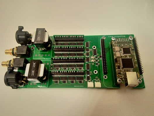

Well, actually it’s not new, it’s just not so popular.
All information, gerbers etc are on his website.
I have not seen anyone posting a feedback about it. If you compare it with 2.5.2, this one has its own ndk clocks and swappable modules with resistors array
Ah I was hoping to not see audio transformers when you wrote “new”. So not for me

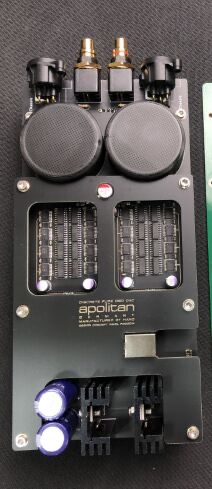

There is a number of non public revisions … probably with active output. Few times Pavel had a new development, and before the research can hit release, entire branch is being bought out with copyrights etc and goes into market looking like this:
Who knows… but it’s not confirmed. And even if someone is up to make a such DAC it would be very challenging. The power supply for the output would be awful.
You see, the power consumption of the AFIR matrix goes up together with frequency. And you have to compensate somehow the decline of voltage… passive output performed best in all tests. An active output would require current stabilisation etc, it’s not like you just throw in an Sparkos or Burson and your done.

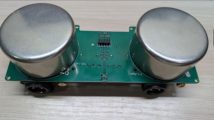

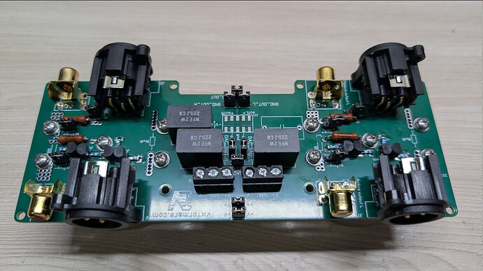

I went another way. For my custom DSC project i choose ultimate output out there…
Ordered this finished board… high output impedance is handled by active buffer, but the output itself, still remains passive.
what is the actual measured output impedance, in ohms?
and where can i see full tech details?
does the supplier share freq response? Not of the transformer, measured from DAC output.
On the diy forum, the person who craft them has its own thread, just search for Output transformers for DACs.
They are outstanding and the price is without reason but… i just need best sound in town.:face_with_peeking_eye:
