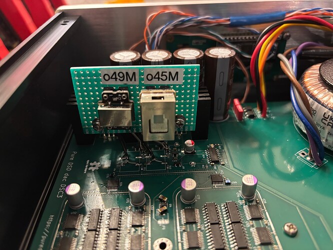

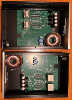

Who made your DSC3 ? And did they detail changes over DSC2?
Any photos of internals?

The same buddy who made me the dsc2!!
Here are a couple of pics of the internal and me testing between the Crystek 957 clock and the Ian Canada SC pure clock

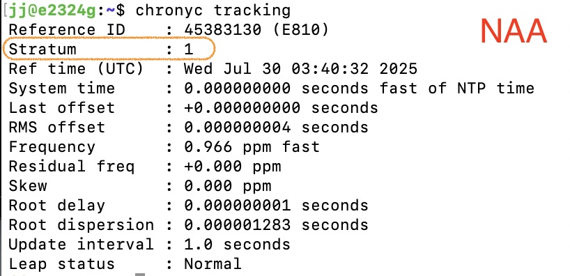

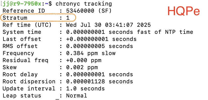

Time zone shouldn’t matter. NAA OS and HQPlayer OS run on UTC. And now includes NTP sync. In particular if you use net trigger, then time zone doesn’t matter. But also the time trigger is based on UTC regardless of time zone settings.
How accurate is NTP sync ? Will it be possible to stream to four pi NAA, connected into the same network switch ? for multi channel purpose of the same data.
Considering all four pi + reclocker hats are located in the same case, and its possible to share 1 mclk signal.
It depends on how long it’s been running and the hardware you have. NTP takes a while to stabilize clocks on a computer. But in many cases net trigger is better solution.
Given the way many audio drivers work, set Buffer Time to 1 ms for most accurate start.
Eeek, you were to fast…
Thanks for the answer. I suppose if one pi cant handle 4 reclocker hats, using a pi board for each hat is possible, with a shared ocxo.

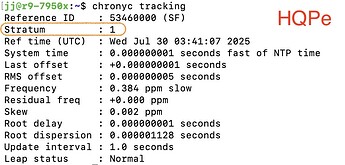

In theory, your NTP clients can have at least stratum 2 accuracy if you have a stratum 1 NTP server locally. My HQPlayer server and NAA client are all stratum 1 grade (with direct GPS + PTP time sync). FYI.
