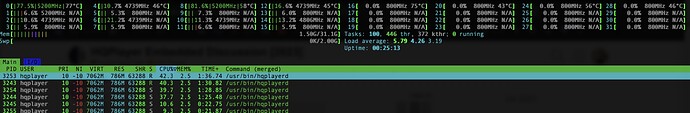

On server type of OS I just run ā€œsensorsā€. But on desktop OS I run for example GKrellM. When I see cores sticking at ā€œcriticalā€ temperature level constantly I know it is being thermal throttled. I have cooling set to ā€œquietā€ profile. So the CPU easily runs around max temps.

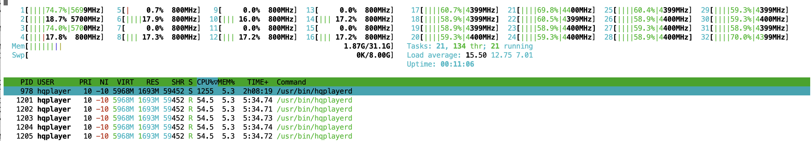

The 2 main p-cores run a little hotter but it looks like in general more processing is being offloaded to e-cores - they are running at up to 70% whereas before they never went above 50%. The result is overall lower thermals, never going above 70C even with 192k source.
I thought everyone recommended the _amd build for latest gen Intel? Somewhat stumped but whatever! I recommend everyone running Ubuntu 22.04 on 14th gen Intel to at least give the intel_amd build a try.

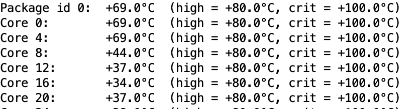

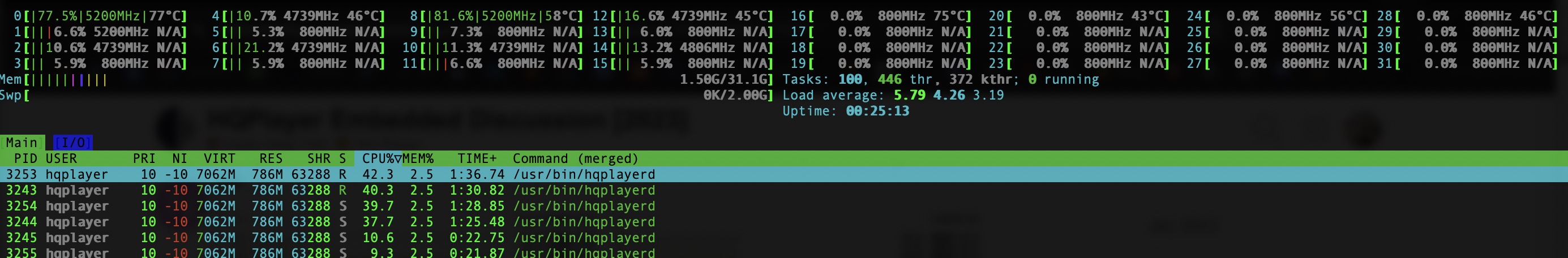

fyi, if anyone is interested, I was able to get all of the core cpu temps to line up and output correctly in htop on Ubuntu 22.0.4. 3 things you need to do:
  1. install lm-sensors of course (sudo apt install lm-sensors)
  2. enable ā€œAlso show CPU temperatureā€ in htop (F2/Display options)
  3. and the slightly tricky part - create a custom label file for sensors so that the core labels start at ā€œCore 0ā€ and increment to match htop screen. For an i9-14900 with 8 hyper-threaded p-cores and 16 e-cores, it likely looks like below, and should be placed in /etc/sensors.d (file can be named anything)

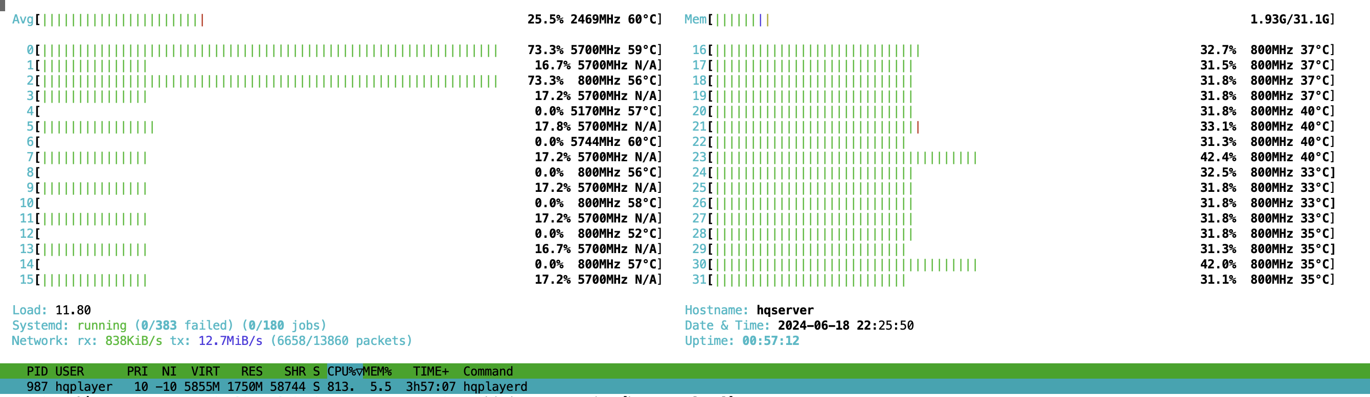

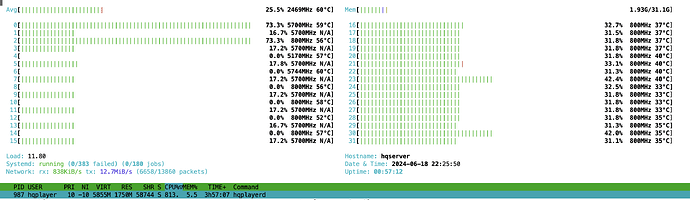

Result is each core’s cpu%, frequency, and temperature is shown in htop. I have mine configured with the hyper-threaded p-cores on left, e-cores on right, and overall cpu, frequency and package temp on top.

Wow, That is cool! Thank you for sharing!
As these temps were always ā€œmessed upā€ in htop display I was always using i7z for monitoring. There it is per core not per thread…
Many thanks!
Can you also share how to make it look like your example?

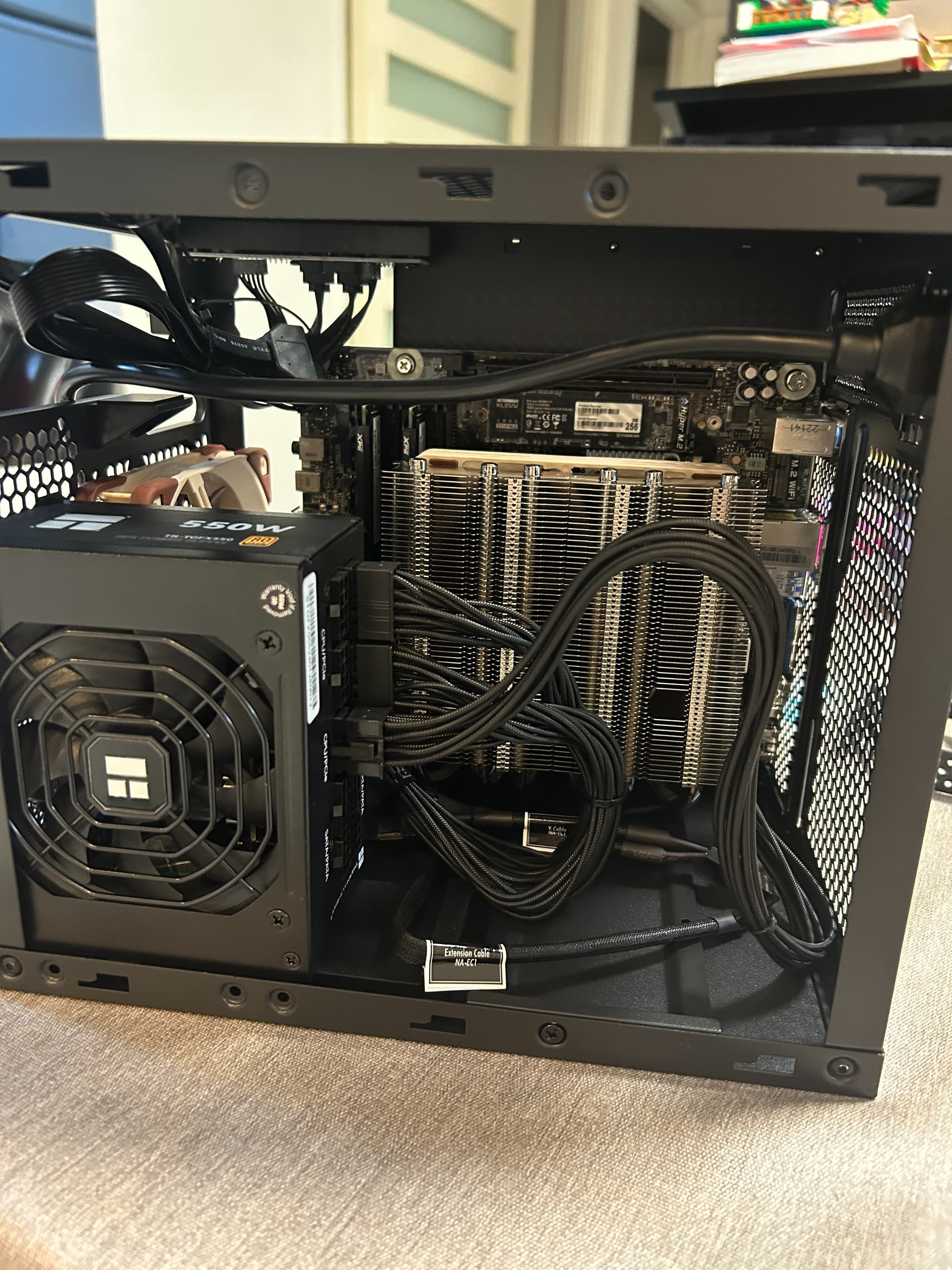

Also I’ve upgraded my Deskmeet ITX-B660 to a Sugo 16 with a Noctua NH-L12S, It’s a total game changer! no more thermals!
I know the case can fit a GPU! but I’m quite satisfied for the long run!

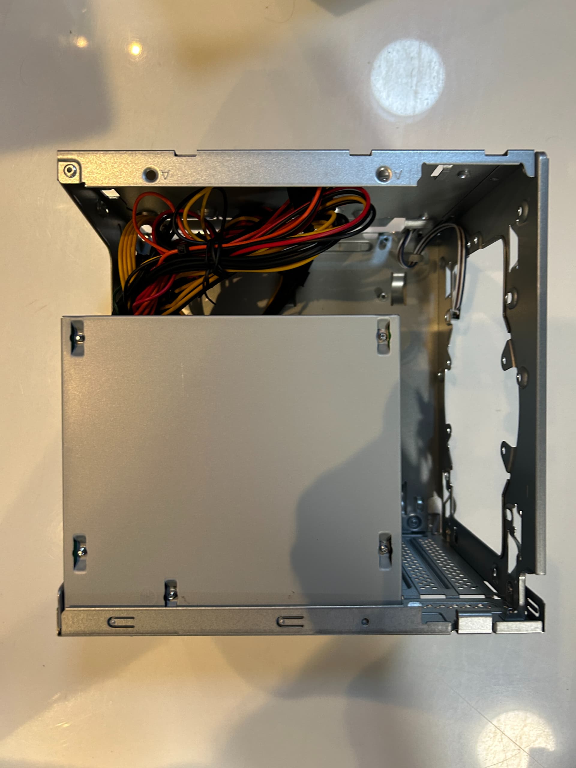

The empty Deskmeet case! More like CPU oven!
Sure here is my ~/.config/htop/htoprc.
