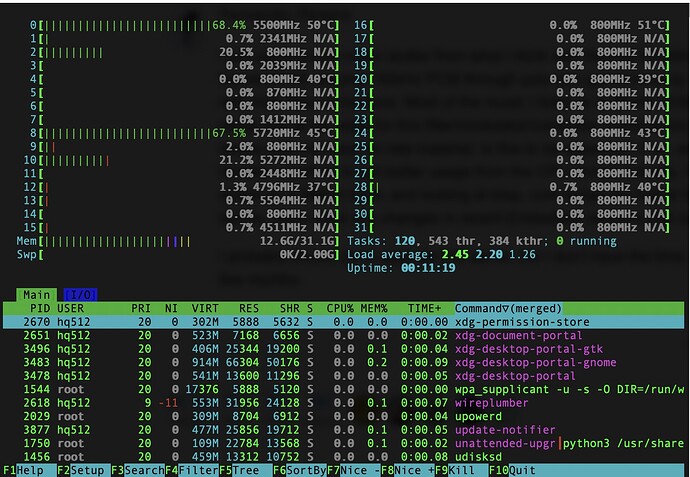

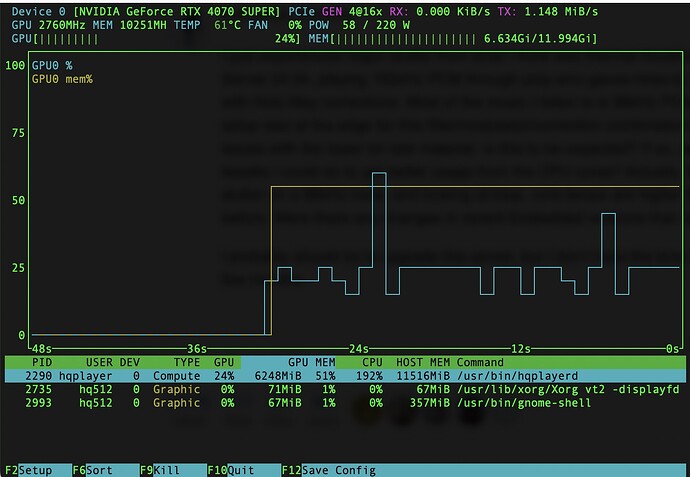

So, decided to upgrade to better cooled, more recent CPU, GPU. Iām considering i9-14900KS + RTX 4070 TI Super OC. Is that a balanced combination? Iāll mostly stay at DSD256 + DAC corrections for Holo May, occasionally experimenting with DSD512.
Due to the way stereo in FM radio works, I would suggest for example poly-sinc-mqa/mp3 or poly-sinc-gauss-hires.
That should work for both DSD256 and DSD512 with DAC correction⦠Assuming no particularly heavy convolution filters or something like that. Some parametric EQ should work fine though.
One more question: any benefit in more than 32GB DRAM (6000MHz)?
You have a beast computer for such needs , Iām already matching the requirements you mentioned with i9-14000 + MSI 4070 Super. Just if you do Sinc-L x DSD512 + DAC correction make sure your GPU has 16GB RAM, otherwise will be ok. Saludos!
Memory is so cheap that itās worth installing at least 32GB.
