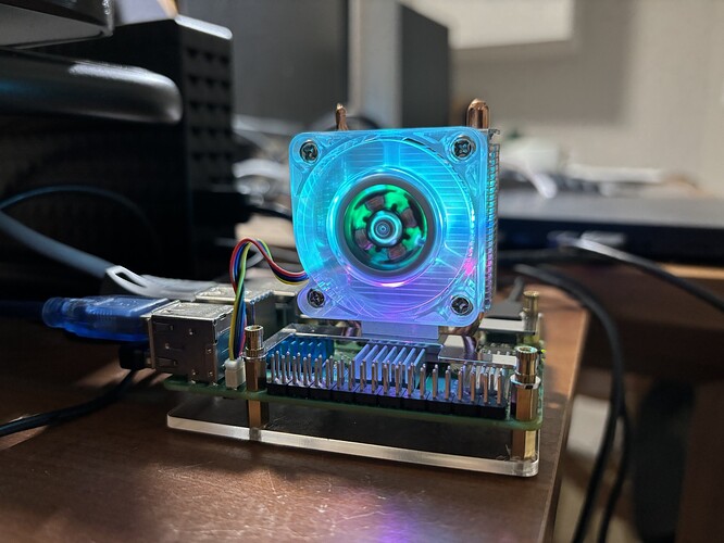

My rpi5 running hqplayer desktop (embedded will be even more efficient) is capable to run dsd256 (native or dop) with 7EC light or dsd512x44 with non EC modulators, default filters and 2s filters with audiolense convolution. Still can’t run super modulator or of course dac correction. Here I am testing the setup with the Signalyst hqplayer DSC2 dac to my Dayton audio tube amp in my home office setup…
Pi5 still has WAY more processing power than a DAC chip and thus can do way more. Likely also things like simpler headphone or room correction, etc along with the upsampling. Depending on how tight upsampling settings are.
