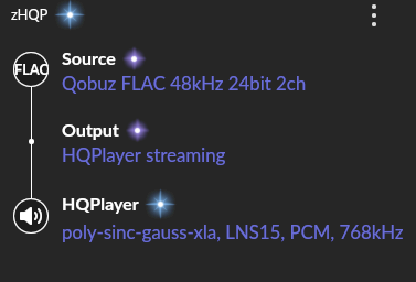

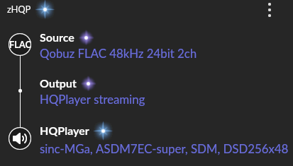

One odd thing… it’s trying to start every new track in PCM, as reported in Roon, but if I stop / start the track again it reports correctly.
New track does this:
play
Then, I hit stop and play, and before it starts advancing it shows this:
stopplay1
And when it starts advancing, audio heard, it updates to this:
stopplay2
This is every new track when I select “play now”. Tracks advancing through queue seems to work, at least most of the time. I’ll reboot everything, I’ve tried rebooting the HQP machine didn’t fix, and see if it fixes itself here in a while when I have more time.

Now, the really odd part is the queue seems to be fixed, it stays in SDM as it progressses through the queue, but starting a new song after the idle expires…
not only does it play PCM but the main screen of the web config has changed to PCM. I need to set it back to SDM before it plays SDM again.
I rebooted HQPlayer machine, NAA Pi, and Roon.
Something certainly weird here and inconsistent.

I think you’re in the right area. It goes to PCM after idle. I’ve not found an exact amount of time but, as example…
Sat down to play the start of a playlist first time today and it went to PCM. Stopped playback, waited about 10-20 seconds, started it again and it used SDM. All was good for a few songs then had to take a ~5 min phone call so stopped playback.
After my call, hit play, it went to PCM. Finshed that song, next song PCM. Stopped for 10-20 seconds, hit play, went back to SDM. It’s good on SDM now.

I already announced 5.9.2, but now I finally managed to reproduce and fix the issue you described. So need to make another release, doing 5.9.3 builds now…
I was able to load this late Friday. Been listening randomly and all good from this little bit of testing. Thank you.
