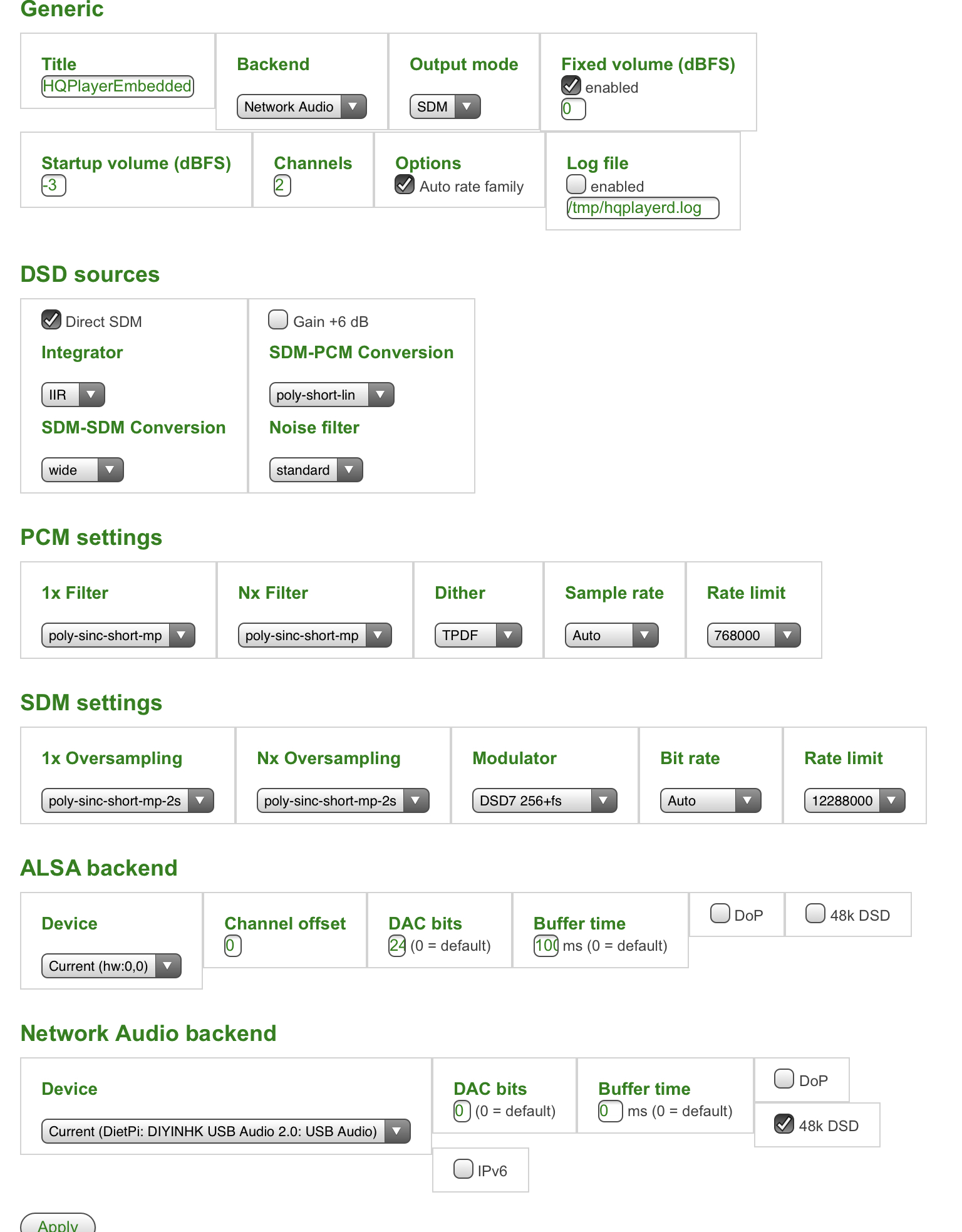

Give HQP poly-sinc-mp (not short, which you already tried) a try also, if you can?
And can you share a screenshot of your complete HQP settings. Just to check what else you can try.
I know you posted some other screenshots when troubleshooting but I don’t know which settings you ended up with, for doing your comparisons with Roon.

I used the same filters for comparison in Roon and in HQPe. For comparison I chose the filter that I prefer in Roon. Of course, it was possible to go through a lot of options with various combinations of filters and modulators in Roon and HQPe, but this does not allow a very limited testing time of 30 minutes to be done - it is simply ridiculous. To conduct a full-fledged testing of anything in audio, you need to be able to listen to it for at least an hour or two in a row without haste for several days and not thinking about the fact that now the music will soon break off and you should still have time to listen to something. It distracts from normal listening without letting you relax.

I don’t know if they are the same filters but the reason I asked to try poly-sinc-mp is that maybe it is closer (or better) to the Roon’s smooth + min phase you like… Maybe, maybe not but I thought maybe it’s something to try.
Also try that with ASDM7 modulator…
I see your fixed volume at the top is 0dB. The recommended is minimum -3dB, to help avoid clipping (depending on tracks played). -6dB should be safer.
-3dB is fine 99% of the time for ā€œFixed Volumeā€. I would set ā€œStartup Volumeā€ to 0dB.

For me this is unacceptable since I listen to DSD on my DAC in Direct DSD mode without intermediate transformations including changing the bit depth to change the volume.
And when testing I used the Mapleshade label’s audio record without compression and artificially raising the volume to the maximum.
You can setup output mode to ā€˜auto’. DSD playback should then always be in ā€˜Direct DSD mode’ and your PCM content will be up-sampled to DSD256 per your current settings… I think - @jussi_laako can double check if I’m wrong/right.
No problems. I have too many recordings that clip with -3dB so I now just leave it at -6dB and don’t worry about it. I don’t want to be checking track to track, or album to album.

No, that would play PCM as as PCM. But if you enable Direct SDM and select SDM as output mode, then DSD sources are played unprocessed and PCM is upsampled to DSD.
