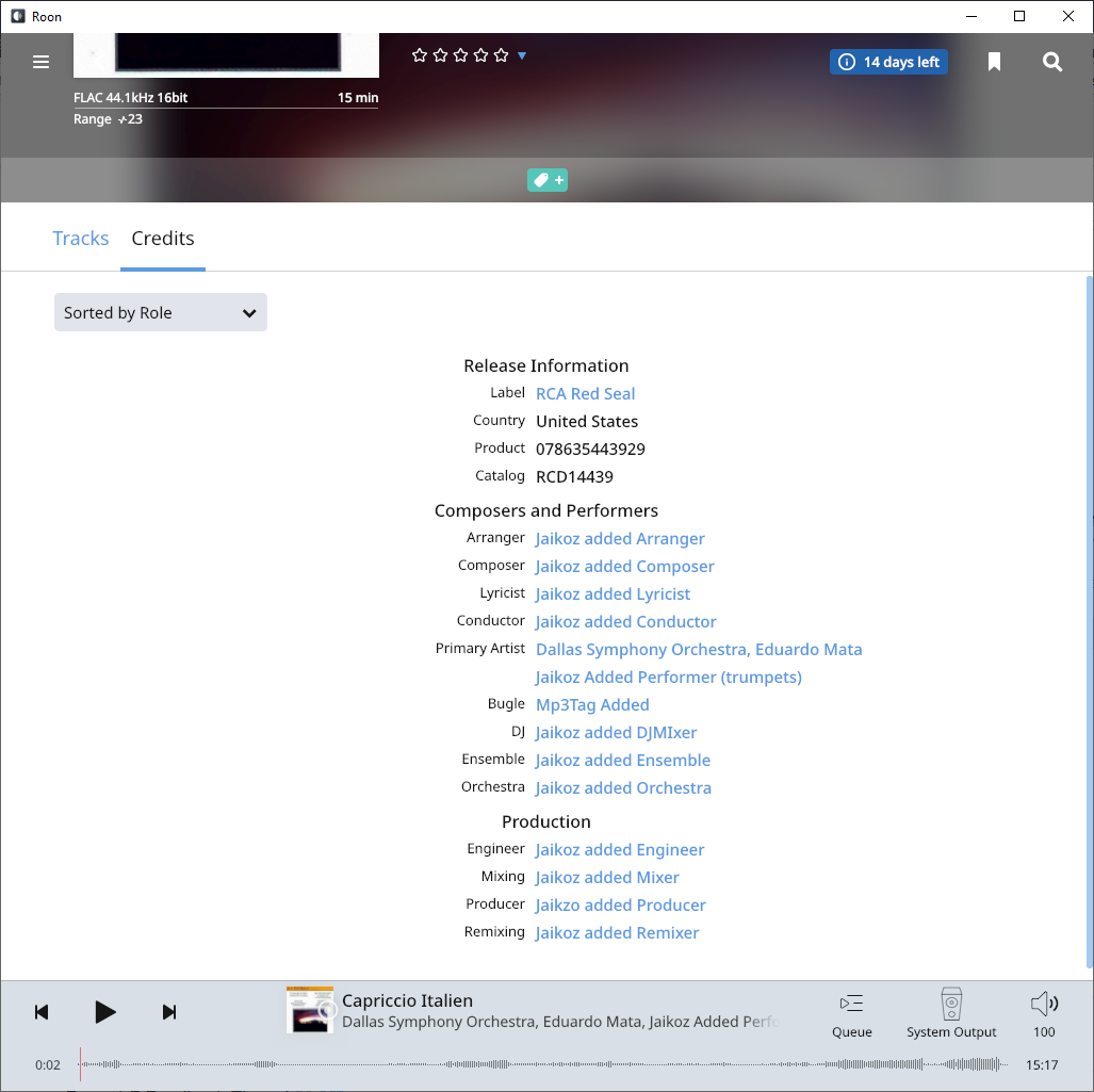

You can see here the credit data when I added all the data using by Jaikoz tagger, except for INVOLVEDPEOPLE which isn’t currently used by Jaikoz and instead I used Mp3tag
It doesn’t seem to recognise:
CHOIR
but if it is added to INVOLVEDPEOPLE (i.e Mp3Tag Choir (Choir) then it does come with role Choir/Chorus
Mp4 has the same results and same issue, but resolved in Mp3Tag using itunes style involvedpeople tag (dont know if case sensitive)
ID3v23 doesnt have problem, but has different problem
Lyricist
DJMixer
Remixer
fields are not picked up by Roon. Jaikoz adds DMixer and Remixer to IPLS frame maybe Roon expecting own DJMixer and Remixer field. Lyricist is stored in the standard ID3 TEXT frame, so @support seems like a bug in Roon ?
