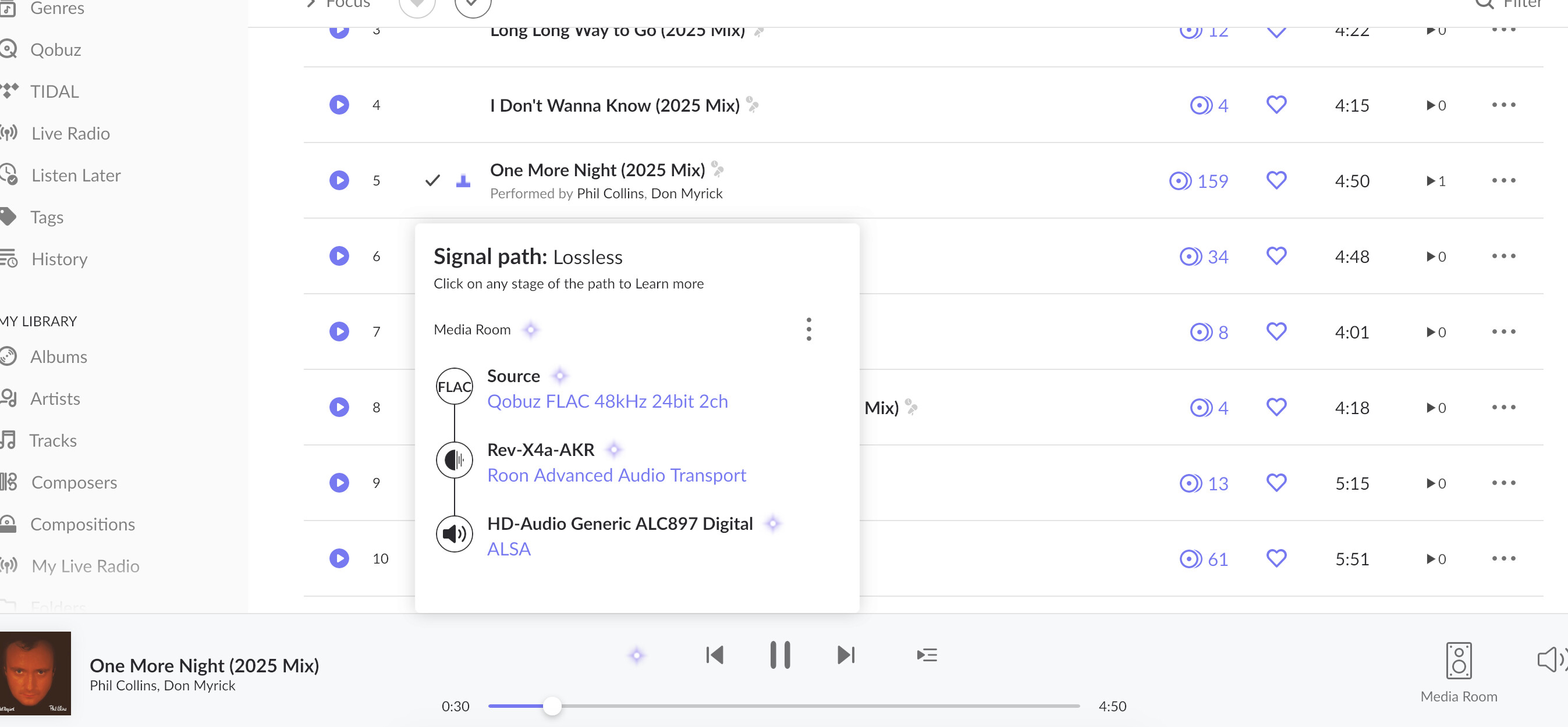

Can you provide a screenshot of your signal path showing it only playing at 48/24?

This is not the root cause of the issue, but inputing >48 kHz audio is superfluous, as the Dutch & Dutch internal DSP sample rate is a static 48 kHz for all sources. As such, Roon DSP ideally should be configured to sample rate convert all sources to 24 bit 48 kHz.
I couldn’t find a setting in the web menu to change the DSP sample rate, but to see if this was the case only with analog input data—ie , to see if the analog input’s A/D converter runs only at 48kHz—I fed the speaker AES/EBU digital data sampled at 96kHz and repeated the on-axis frequency-response measurement. The result was the same: a sharp rolloff above 20kHz and a Nyquist frequency of 24kHz. As a final check, I set the 8c’s analog subwoofer output to full range with the website app and analyzed its analog output signal while I fed the speaker 96kHz digital data. There was no difference. It appears that Dutch & Dutch’s DSP operates at a fixed 48kHz sample rate, and that digital data with a higher sample rate are downsampled.

Yes, that is correct - good point! I have adjusted the sample rate to 48/24 and it is playing everything now. Thanks!
