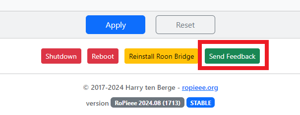

Hello @Will_Butler . I suggest that you use the “Send Feedback” feature so the logs are accessible to Harry in case he has time to take a look. The DAC should be powered on and attached before you do this.
On the Advanced tab:
Screenshot 2024-09-10 103735
Post the identifier in this thread.
Thank you.
Identifier is:
0be4efb4e553acb4
