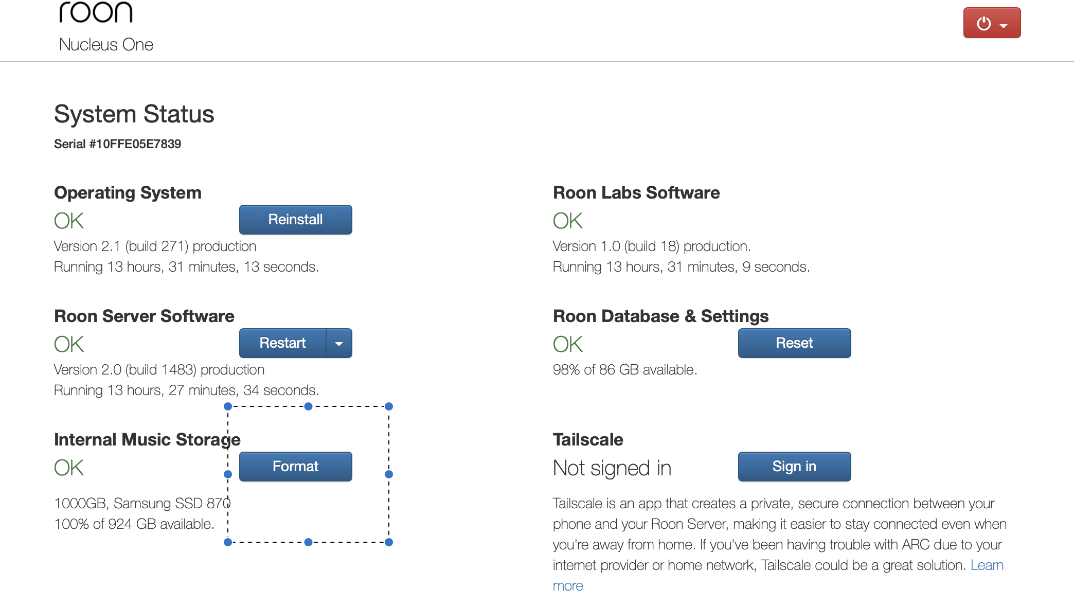

Where do I go to format the internal storage in the nucleus one webUI?

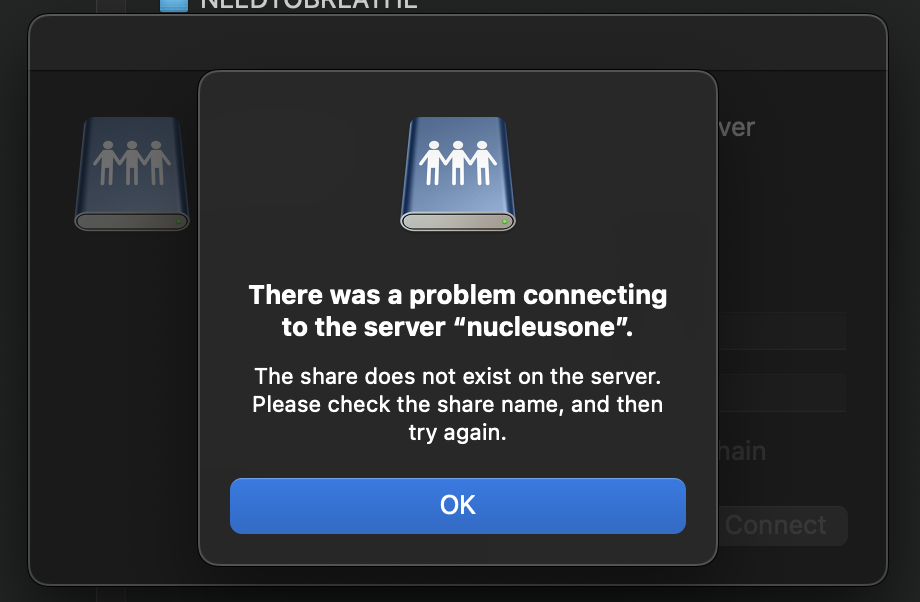

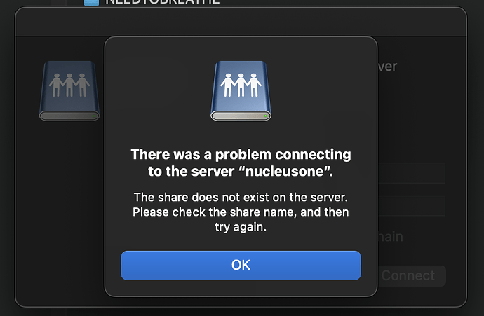

I get an error message when trying to login to the “nucleusone” in the mac Finder after plugging in this address: smb://nucleusone/Data/Storage/InternalStorage. I tried guest and login with guest as username and password and I get the same error message.

Try smb://nucleusone or smb://Nucleusone.
Guest Login with guest as user and password ndeed.

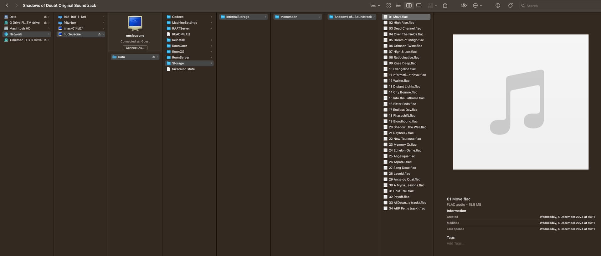

Your Data folder should be mounted then and one of the folders in it will be Storage with Internalstorage inside.
You can have your USB drive connected to your Mac or Nucleus.
Here’s the mac path to the SSD on my Nucleus One if that’s helpful

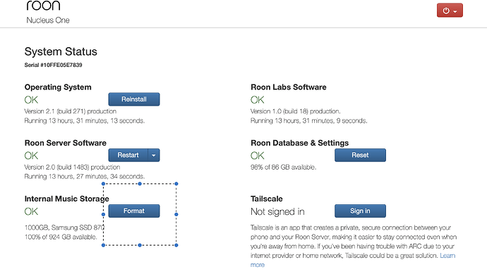

Here is where you format the SSD
I dont think the “internal music storage” section is on the web gui as an option. But I see everything else.
It’s not visible until an internal 2.5" SSD or HDD is installed and then it will appear with a “Format” button. The drive first needs formatting before it can be used to store local files…
