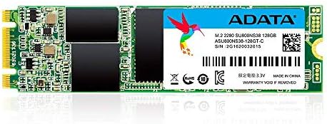

Finally, I’m trying to work out if I should just make use of a space 128GB SATA SSD for the ROCK install or pony up for an M.2 NVMe. Is the latter likely to yield a significant performance difference for ROCK?

An SSD is sufficient, but I suspect an M.2 NVMe runs cooler. Dunno. An M.2 will fit in a slimmer case. The price difference between the two choices is negligible.

I think Danny said no. However, if you plan to have local music storage (instead of NAS or USB HDD) it’s best to leave the SATA port for 2.5" music HDD and use the m.2 slot for SSD for Roon database.
No. SATA III SSDs top out around 500MB/s sequential. That’s already 80 times the bandwidth of the worst-case music files (DSD512) and closer to 2500 times the bandwidth for redbook audio. NVME is total overkill. Also, if this is for your boot/system drive, NVME requires UEFI boot, and as I recall, ROCK still doesn’t support UEFI – only legacy BIOS booting.
NVME MIGHT be a performance boost while analyzing a library. But even then, its not purely IO during analysis, so the CPU might hold you back from exceeeding SATA III SSD speeds anyway. And analysis is typically a one-and-done operation per track, so not something to spend a lot of extra money for…
I put ROCK on a NUC w/M.2 NVMe. The thing it has going for it is a smaller form factor and hence slimmer NUC case. 128 GB for $22, why sweat it?

Just pulled the trigger on an order for a NUC8i5BEH and a couple of sticks of 4GB DDR4 RAM for ROCK. I was going to get an NVMe drive too but they’re almost all 240GB now and I struggled to find a decent 120GB unit for a suitable price.
Initially I ordered a Kingston SUV500M8 120GB m.2 drive but it dawned on me that it’s unlikely to be any quicker than the SATA SSD drives that are sat in my house in an unemployed state, so I cancelled this. In my mind, by the time SATA SSD drives fall to the price where it’s sensible for me to consider having one for the actual music library, I’d be willing to buy an m.2 NVMe for the boot drive at that point.
