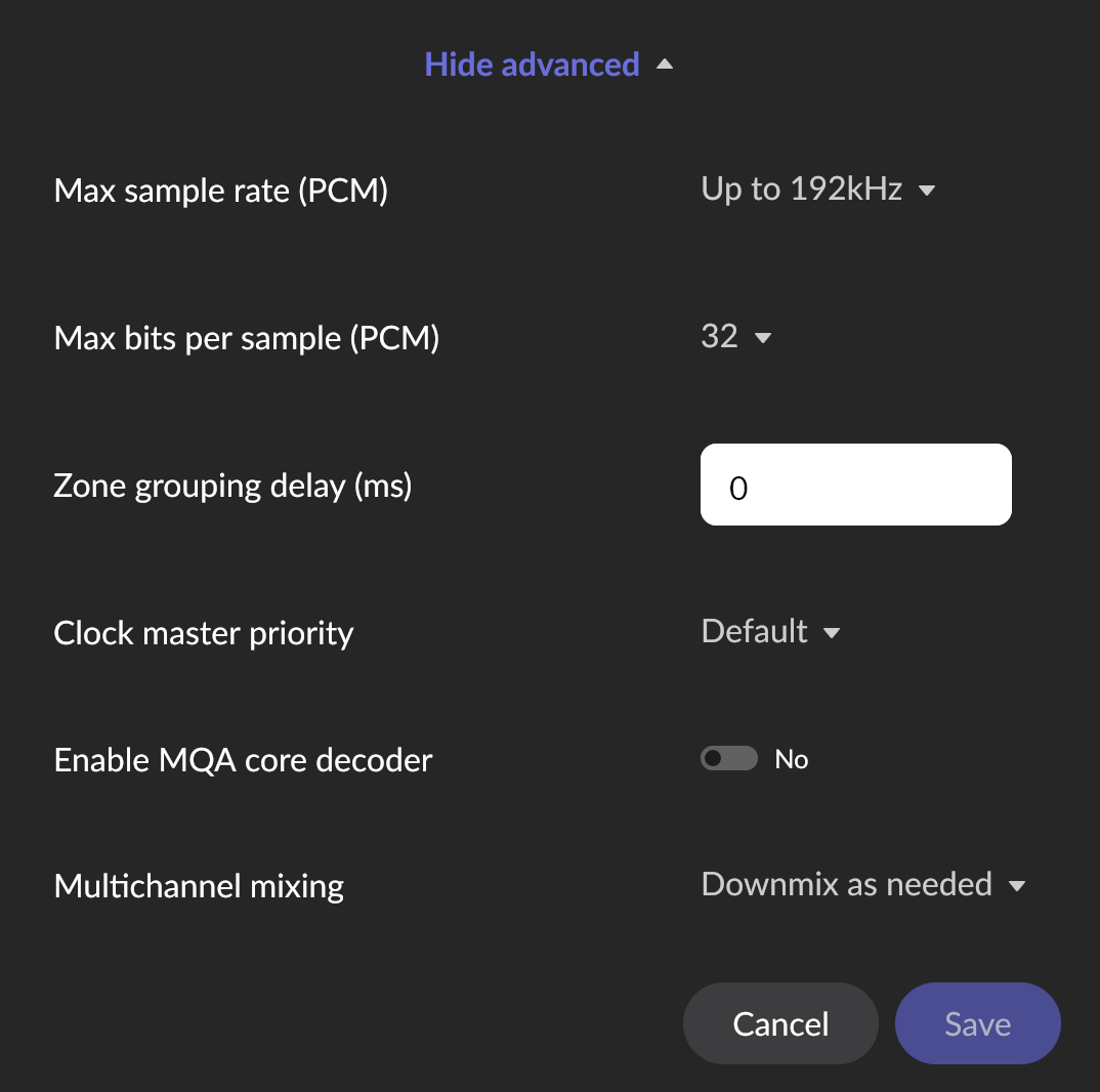

Solved the problem with the following:
In the configuration for the U2 in Roon - I disabled the Enable MQA Core Decoder option within it. Now, everything is working again. I had that option enabled as I was subscribed to Tidal initially for a couple of years before moving to Qobuz, it’s not needed at all now.
Cheers,
Correction to my earlier comment. After a bit more testing - on / off - (i.e., coming in to use the system). It wasn’t disabling the Enable MQA Core Decoder that resolved the playback issue. It was initiating some control change on the zone that then led Roon to go ahead with transmitting to that zone.
Yesterday evening, I had both the amp & lumin off. I turned on the amp, then turn on lumin, - pressed play to listen to music. No sound came out. I made the change of disabling Enable MQA, and then music started playing.
Today after starting up the amp, then lumin, then pressing play, - no sound came out, and the same issue occured. So, then I enabled the MQA core decoder, and, it started working - playing music.
So, I guess another approach to resolving the issue would be to just make a change to the zone as opposed to transferring music from one zone to another.

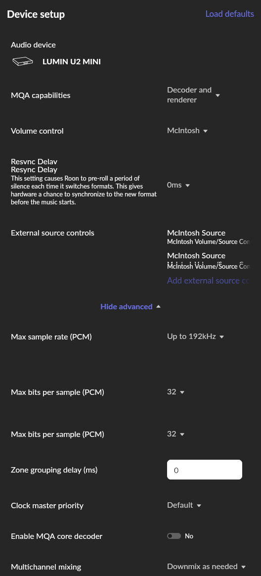

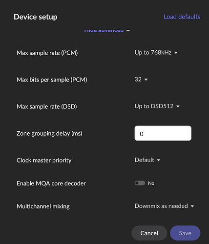

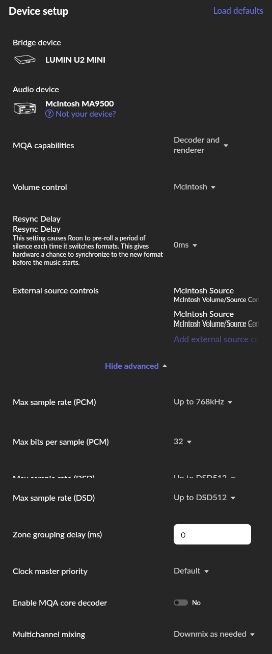

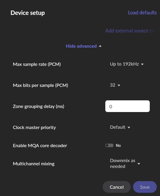

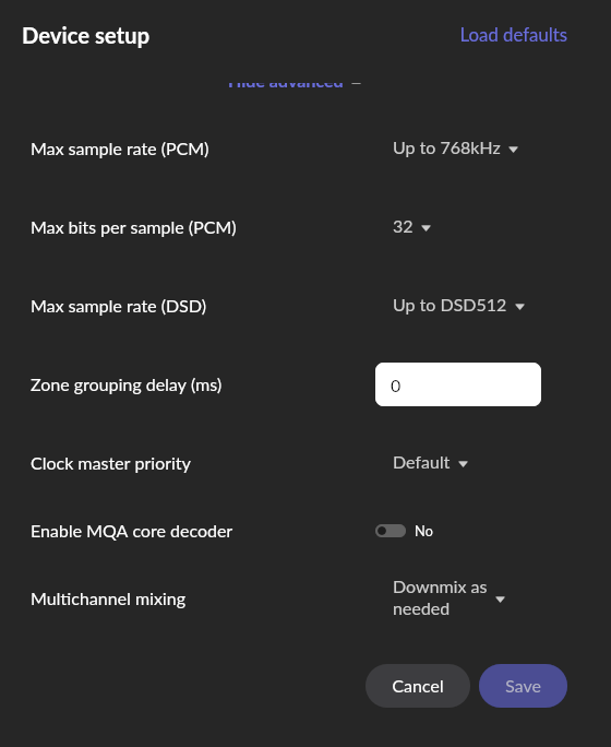

See below correct identification of the capabilities of the streamer - and amp. This is the case after restarting Roon Server. Let’s regard this as a fresh beginning.
I’ve placed the amp in Standby then Lumin. Waited 15 minutes. Started up the Amp, started up Lumin.

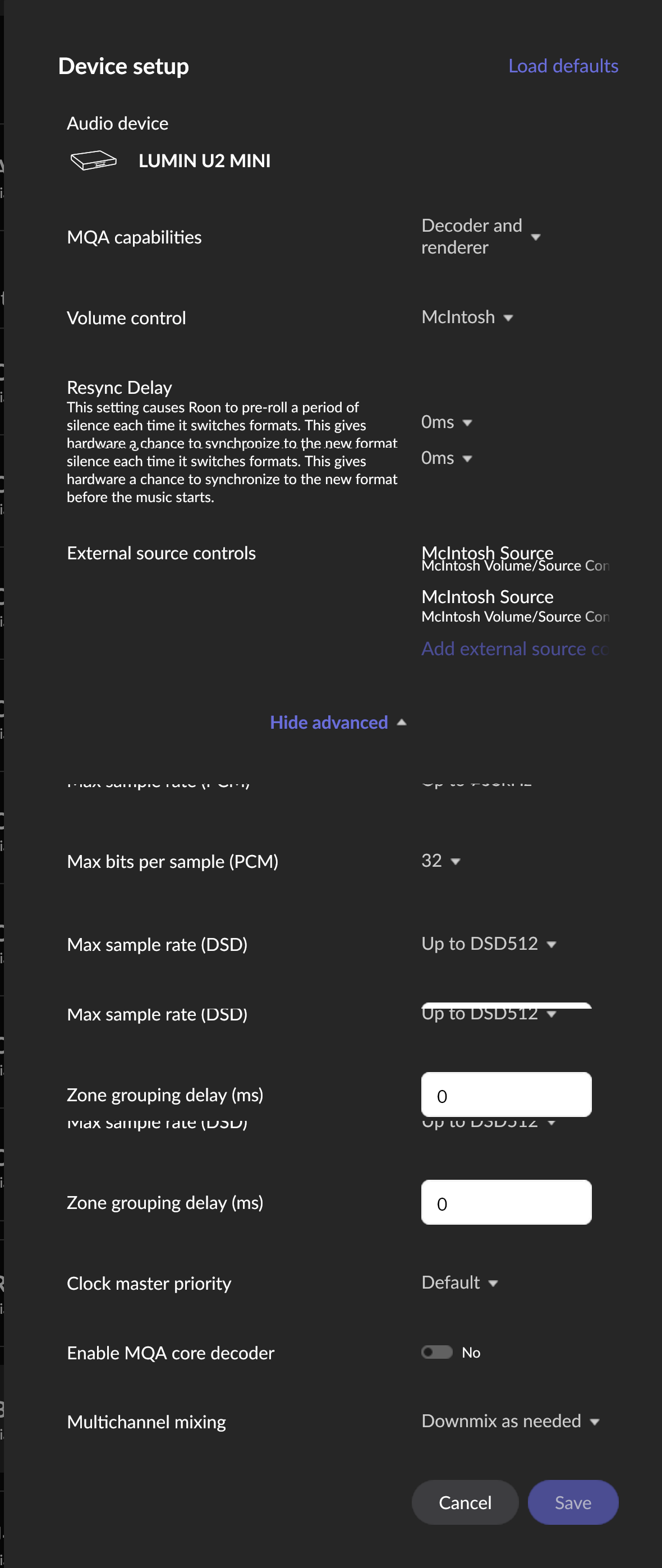

Pressed Play to listen to music - and music played, but, when I look at the audio-zone, see below, streamer and amp capabilities were reduced.
Other occasions when it did play after starting up the Amp, then the streamer. Pressing play to listen to the zone, the amp was no-longer identified and only the streamer was visible.
To correct the reduced capabilities of the streamer & amp, - I have to restart Roon Server.

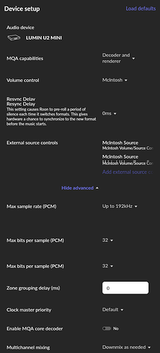

Thank you for the prompt response. By reduced capabilities, see my earlier post on 28-Feb. it provides the screenshots and description of the issue, and below are the excerpts of the zone. Same equipment, nothing changes.
This behaviour happens because when myself or Roon places the equipment in standby mode - off, and then turn them back on again. The zone capabilities are reduced. The trick of turning on the amp, then lumin - used to resolve the issue that the zone capabilities remain, but recently, that has stopped working and I need to restart roon server.
See below images for reference as well. Image 1 is reduced
image 2 is after restarting the roon server.
I’m running Roon Rock - Version 3.0 (build 274) earlyaccess, Roon Server Version 2.67 (build 1660) earlyaccess
