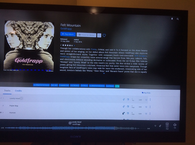

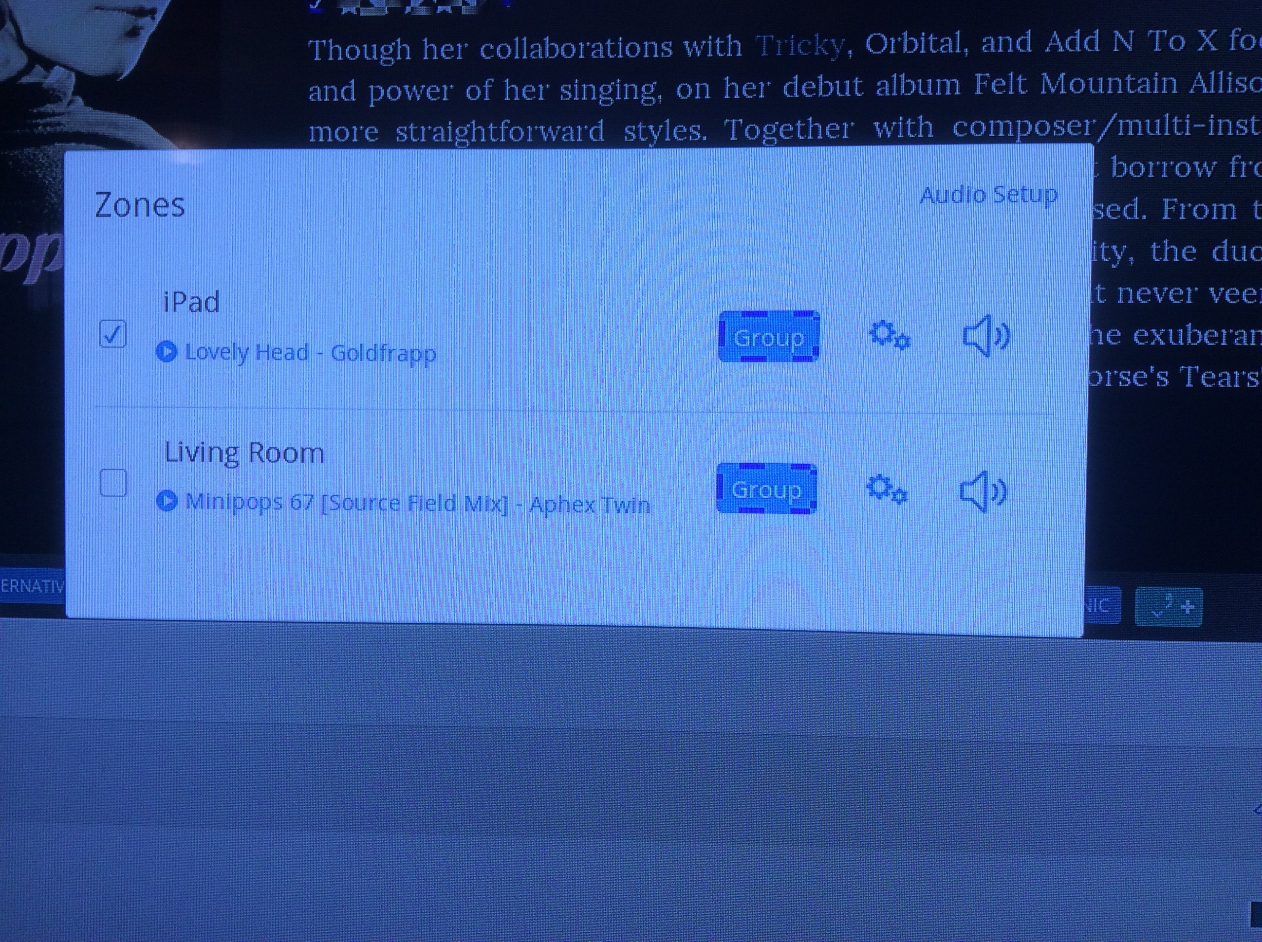

I’ve taken a screen shot on my iPad, obviously that only shows one song. I can’t take a screenshot on the Mac mini, because that’s playing via TV, but I’ve taken pics of me holding the iPad in front of the TV, so you can see both screens. Also taken video of a speaker & you can clearly hear both songs. Just need to work out how to post them? Do you have an email address I can send them to?

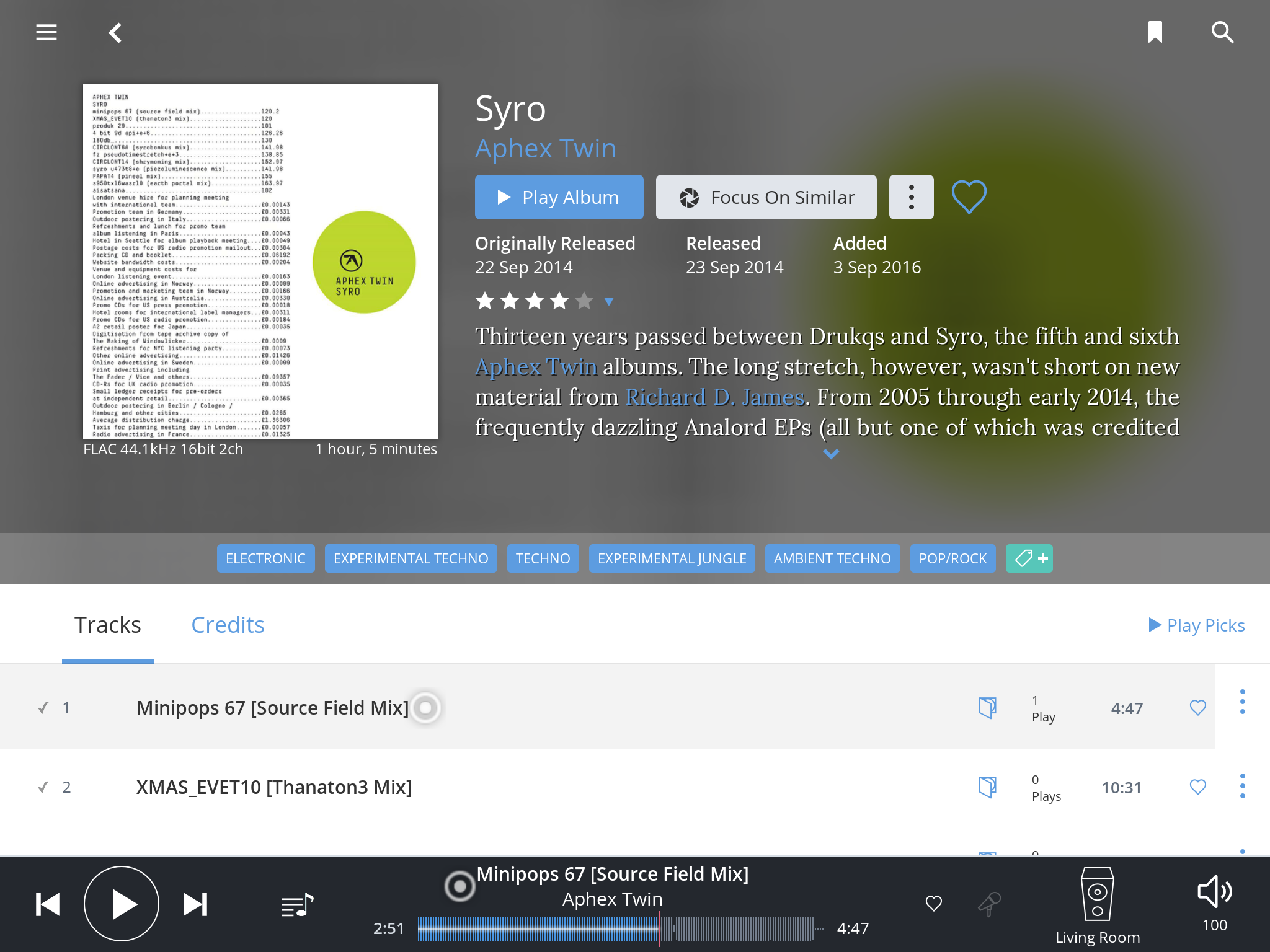

Basically, I was listening to music, controlled from my iPad.
I went to change the track from the Mac mini. It just played over the top.
The attached Pic shows my TV & iPad together, showing different tracks playing.

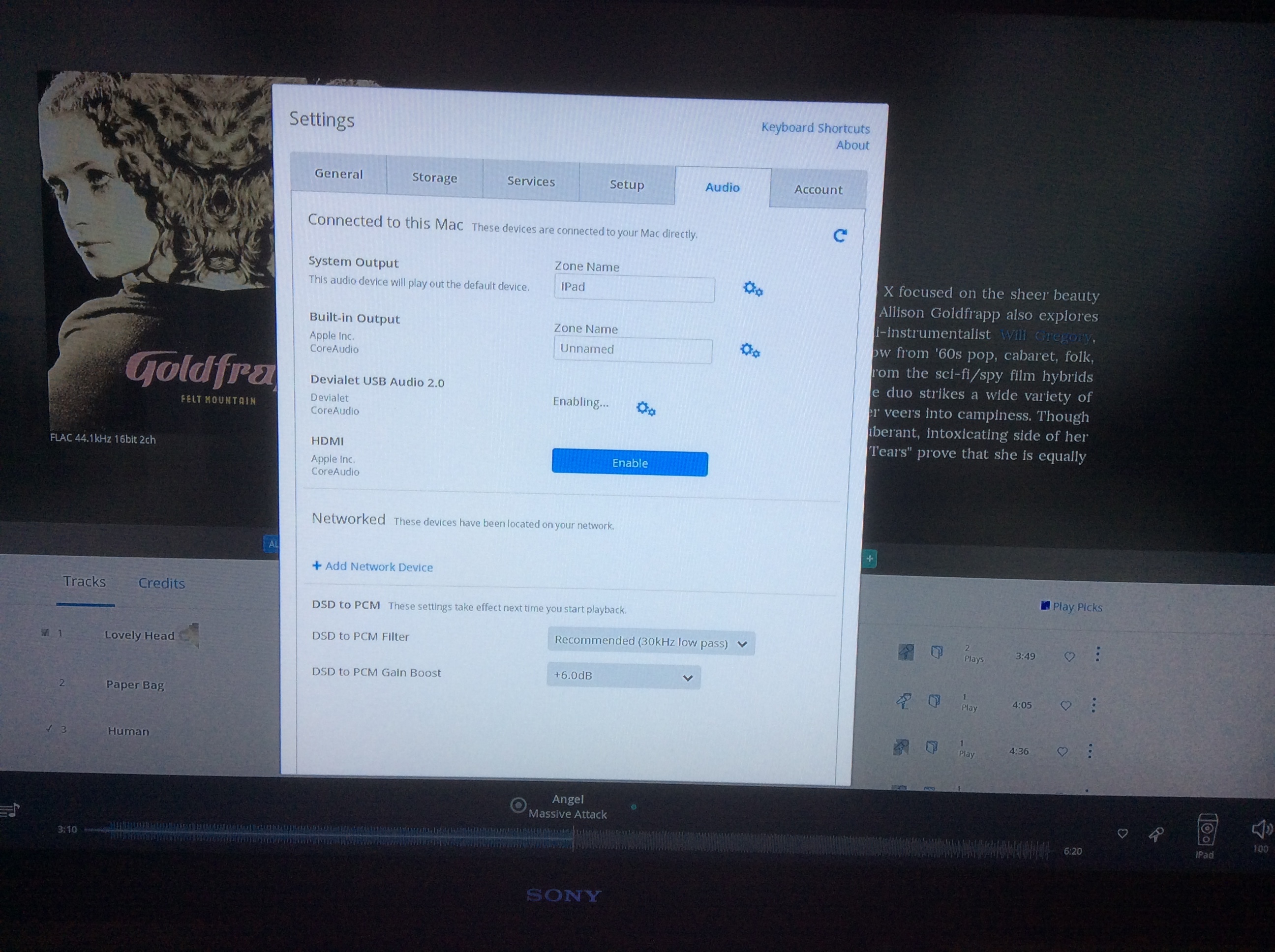

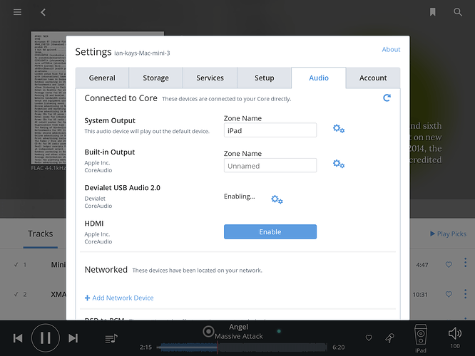

May I kindly ask you to please provide screen shots of the “Audio” tab found in settings on your core machine (Mac Mini) and your remote (iPad mini2) as well. Thanks!
-Eric
This is the iPad display. How do I find the Audio tab?
Hamburger menu (three horizontal lines top left) > Settings > Audio

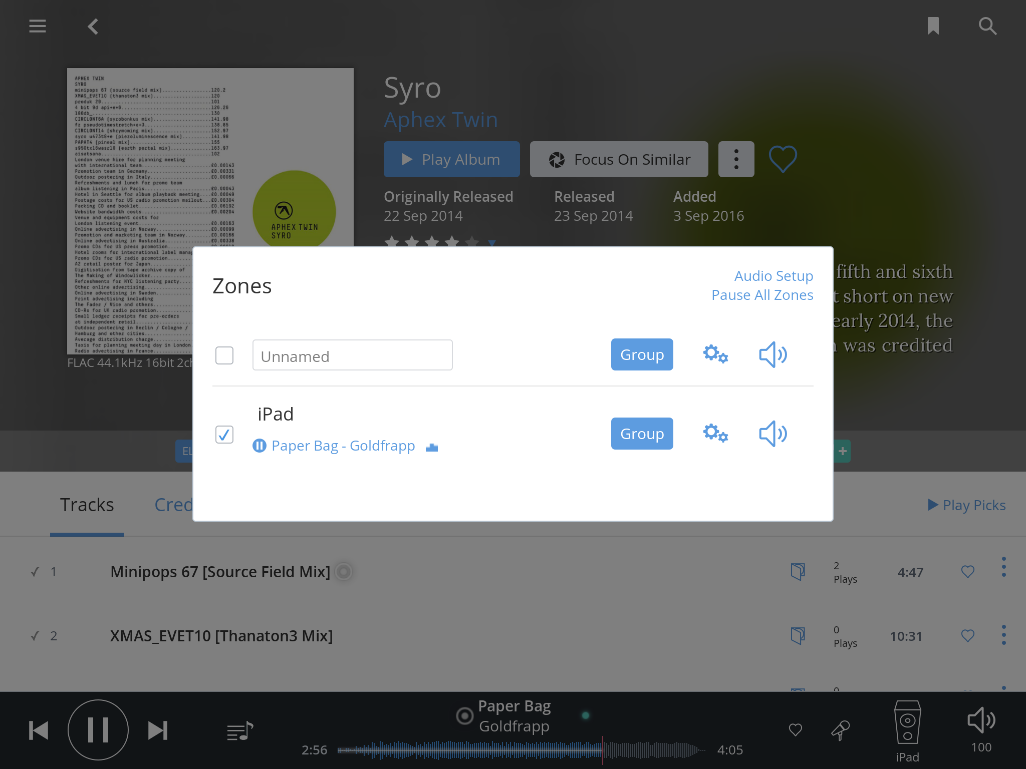

Just clicking on the Zones icon. I saw that the TV (Mac mini) was displaying “iPad” and my iPad was displaying “Living Room”.
I went to make them the same & now the Living Room option is gone. I just have “iPad” & “Unnamed”.

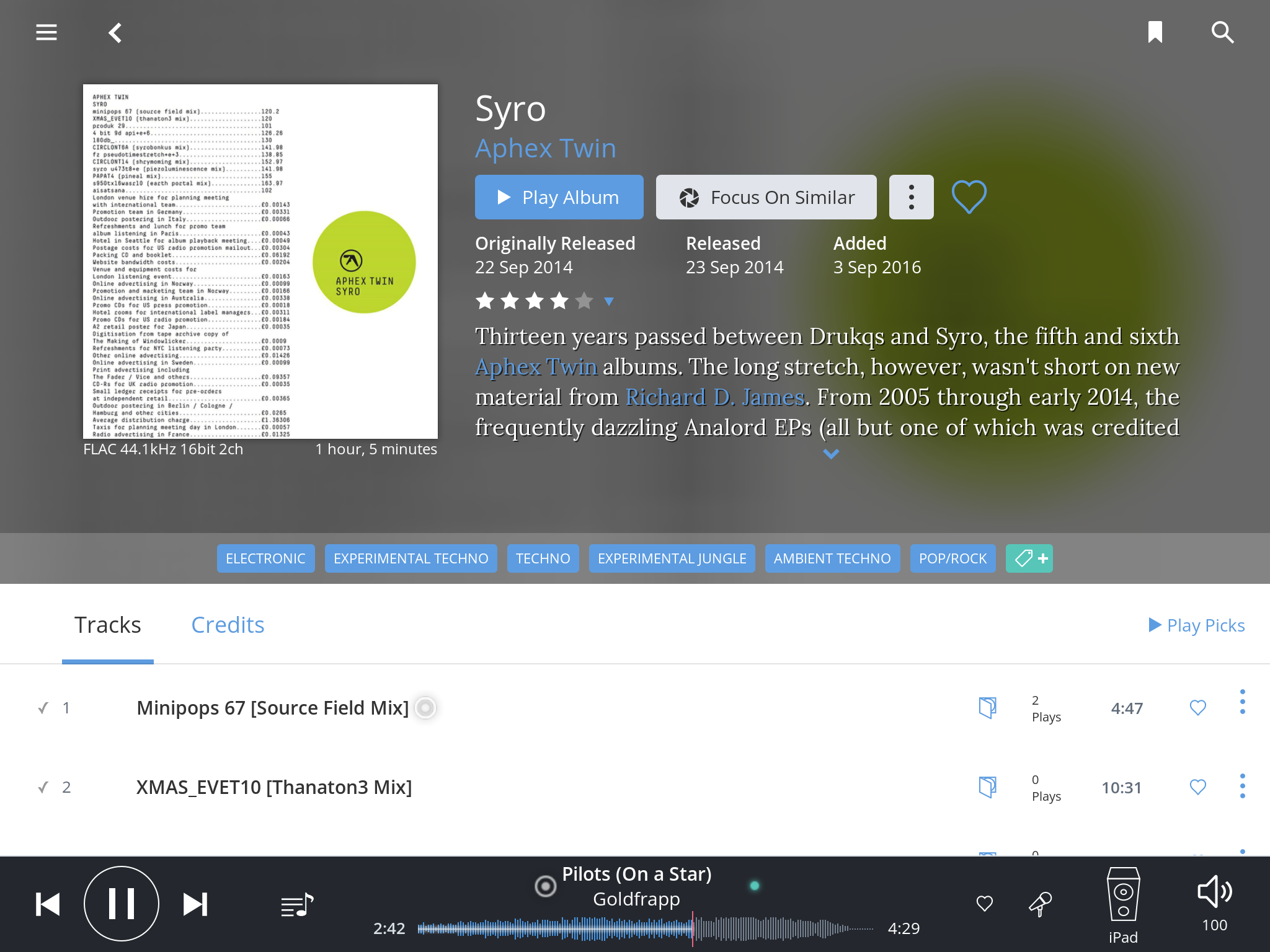

My iPad appears to be working properly now to some extent. When I press Play/Stop etc… It’s controlling the track on the Mac mini, but you can see the iPad display is confused. Showing Aphex Twin up top, but the Goldfrapp track below.

Please put up a screenshot of your Audio tab (see my post above on where to find it) – it will most likely clear up the confusion. :slight_smile:
In your last screen shot you are looking at the Aphex twin album and the bottom of the screen is showing what is playing…two separate things altogether.
The bottom bit of screen showing what we call the ‘play queue’ can show you any play queue that you have in your system (think multi-room for example).
Your screen shots show different zones…the zone you named iPad is curious as iPad isn’t a music zone itself. The iPad is just a handheld Roon remote effectively. It can control any zone you have.

The top pic is the TV/Mac mini.
Bottom pic is the iPad
I don’t actually remember naming a zone iPad. Not saying I didn’t, but don’t remember doing it…
