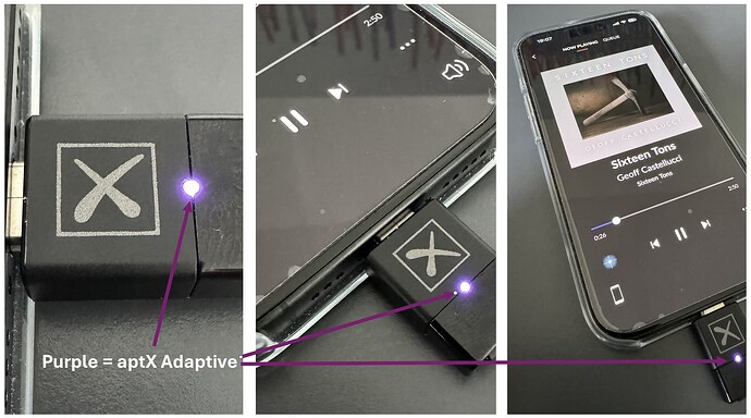

I have this adapter designed originally to get pictures or any other data OTG  from the iPhone to USB 3. It has to be this one, otherwise the iPhone wonât work because due to a matter of power. Then I connect the Sennheiser BMD 600 and that is it! Aptx Adaptive from the iPhone. I have been using it with Roon on my IPhone since December with no issues at all. But the key it is that iPhone to USB 3 adapter that consumes very low power. I got in in Amazon Spain but it is available in Amazon all over the world. This the link:

Thank you for sharing. I ordered the exact same dongle and it works like a charm, in my case with a Sennheiser BTD 600 and Focal Bathys.

Do you have a UK link to that lightning to USB cable? I have the Apple version but it gives me the âtoo much powerâ error when using it with the BTD 600.
Nope. Couldnât find it in the NL store either, so I just ordered it from Spain. Took a few days, but arrived in good order.
Thanks, will give it a go.
A quick update and some success! I was trying to replicate what @Mathesis_Corp_SL had set up using the Apple USB 3 camera adapter but not having much success at first. The components in use were an iPhone 14 pro, Apple USB 3 camera adapter with the lightening power port and the Sennheiser BTD-600 (I was after the Aptx Adaptive codec to feed B&W Px7 S2 headphones). Despite using a genuine Apple power supply I kept getting the âinsufficient powerâ error. I also noticed that the phone wasnât charging either. I swapped in a 20w 3rd party charger with the same result.
I then switched out the iPhone for an old iPad mini (2nd gen), which was running ios 12. I had the original 12w charger for this device. Plugged it all together and hey presto, everything charges and works fine. So the take away seems to be that the genuine Apple USB 3 adapter is very fussy about being paired with the Apple power supply that is matched to the device, even though the wattage may be lower than that from a 3rd party charger.
With that sorted I set the private zone in Roon to ânoâ and enabled the option to keep the screen alive. That now enables me to control the iPad Mini endpoint from my phone or any other Roon controller.
Hope this helps for anyone else pulling their hair out with Apple and Aptx and thanks to those on here who nudged me towards this solution.

Dear Tomas, I have never used Spotify. The process I described, which is Aptx Adaptive it has been used exclusively to be able to use Roon at home on my iPhone 13 and play music with my Senheisser Momentum 4 with the quality that the Aptx Adaptive Bluetooth connection is capable of, well above the AAC format to which the iPhone is limited. Outside the home, I use the same procedure but directly with Qobuz and now Roon ARC.
The key is not to go through the AAC bottleneck that all iPhones impose. To do this, with a special Lightning connector (iPhone output) to USB-c for transferring photos, you can extract the music streaming without any damage. Then the Senheisser BTD600 dongle is responsible for transferring the streaming to the headphones via AptX Adaptive, preventing it from being capped to AAC format. Et voilĂ ! Ya estĂĄ y funcionando sin problemas.

Thank you so so much for all the information you compiled. It took a bit of finicking but everything is running perfectly on my iPhone 13 Pro!
