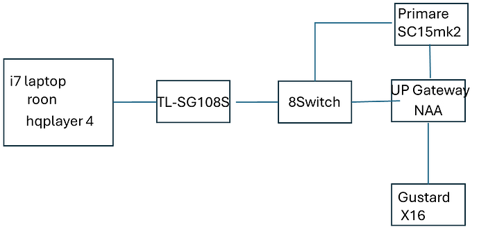

A crude block diagram is:
As you can see there are two switches. The hifi is in the family living room and shares space with the TV and other devices so I have tried to isolate the hifi on its own English Electric switch. All ethernet connections are CAT 6.

That looks normal. But can you please enable log file from HQPlayer settings, and when the issue happens that you feel you need to reflash the image check the log file, or send it to me?
Because the ramfs image you are using has nothing ever written to the storage. When it is booted up, it runs solely from RAM and the OS image on the boot media is only accessed in read-only mode and decompressed into RAM during boot. So I cannot understand why it would need to be reflashed.
sinc-L is certainly among the heaviest ones, so I would suggest to set for example poly-sinc-ext2 as filter for testing until you know that everything is working without dropouts and such. If there are too many potential places for the problem it is much harder to locate.
I would also suggest to play just some local files using standalone HQPlayer, without Roon, for testing purposes. IOW, so that the setup is as simple and as minimal as possible. And only then if it works, change only one thing at a time and see when it breaks…
