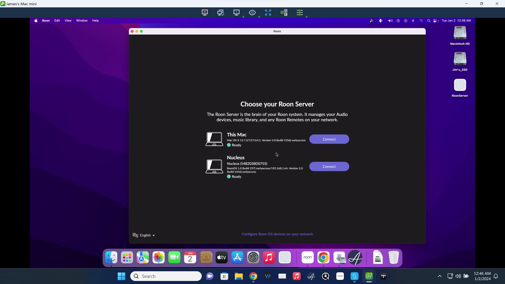

Another Mac in my home office has the full Roon application installed, as I use it to play music in my office. When I first installed it, it asked if I wanted to use my Linux Roon Server or I wanted to use the Mac on which it was installed. I chose the Linux instance. I didn’t get a Roon Server instance installed and its outputs disappear from Roon when I quit the app.

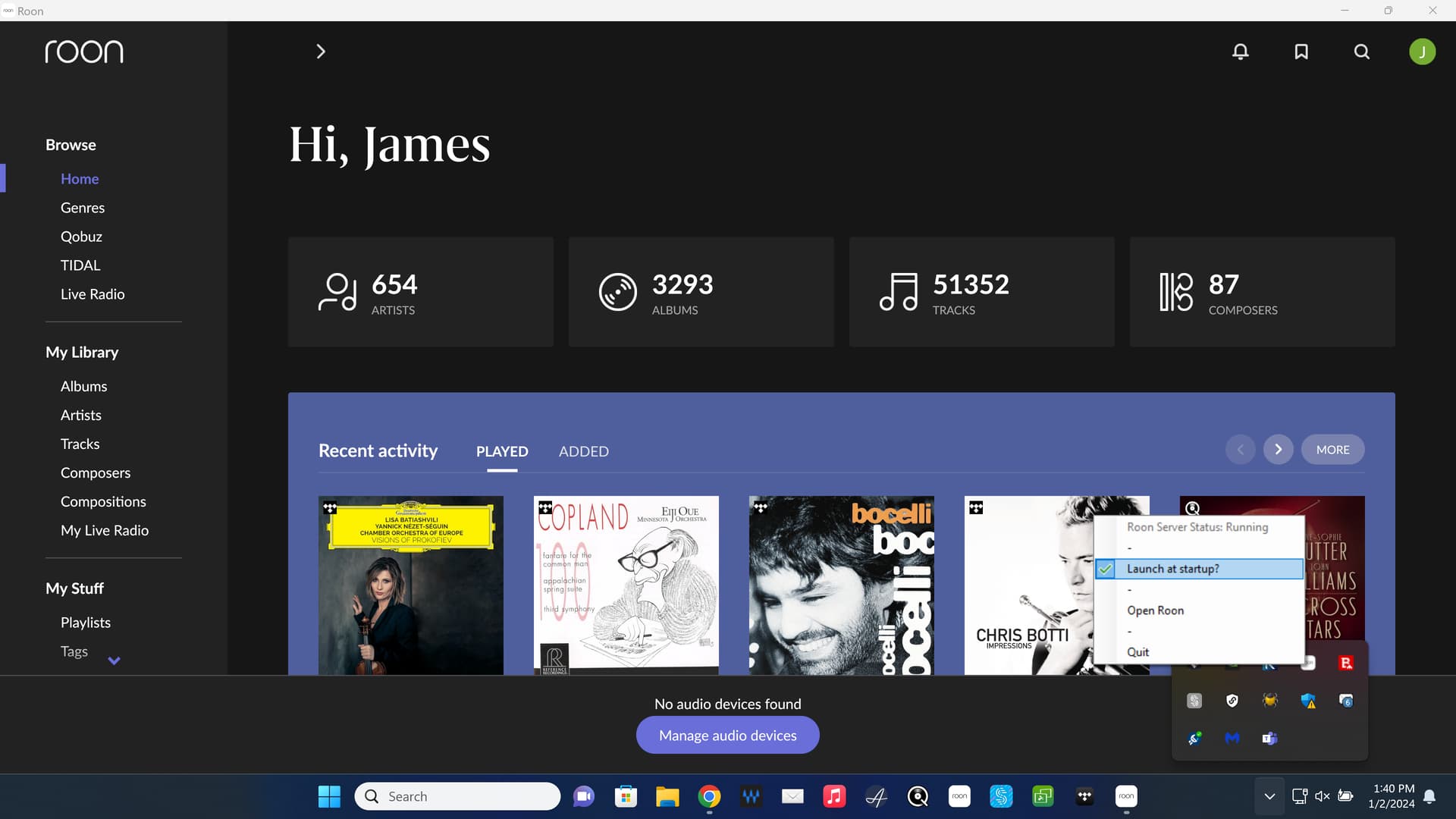

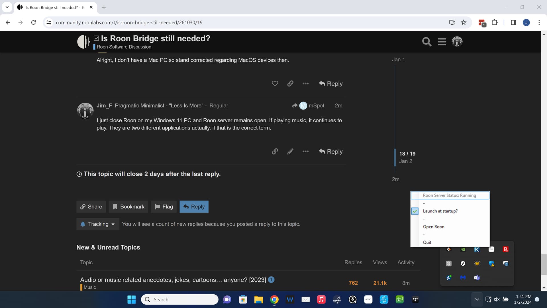

I just close Roon on my Windows 11 PC and Roon server remains open. If playing music, it continues to play. They are two different applications actually, if that is the correct term.
I was addressing the OP’s question which is a different scenario. It is when Roon server is already running on another machine and you open the Roon desktop app on a computer to use only as an endpoint. On Mac, you can close the UI and it continues to work as an endpoint. On Windows, I don’t see a way to close only the UI without also shutting down the endpoint (the server is already running elsewhere and didn’t start up on this machine).
