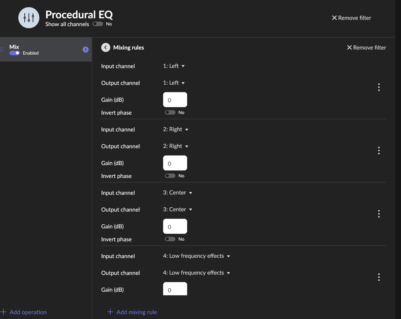

THE EASY WAY (PROCEDURAL / IIR EQ)
Under device settings.
Set the device as Multichannel mixing: 7.1, 5.1, 2.0
Note, Roon only offers options for 8 output, 6 output, and 2 ch output USB interfaces. 4 channel devices don’t work…
Select channel mapping only.
Use the Roon DSP engine.
Insert a Procedural Mix function. Mix stereo to the channels required, by select the correct input for each output. Up to 8 can be assigned.
Then simply insert the Procedural EQ required, and assign it to the channels needed. Multiple Parametric EQ’s can be applied here, to any combination of channels. I.e. this is where you insert a high pass on channel 1 and 2, and low pass your subs, I.e. channels 2 and 4.
You should now have a working crossover. No need for loopback, inside your interface. The interface should be set to 1 to 1, straight through, with USB audio assigned to the channels.

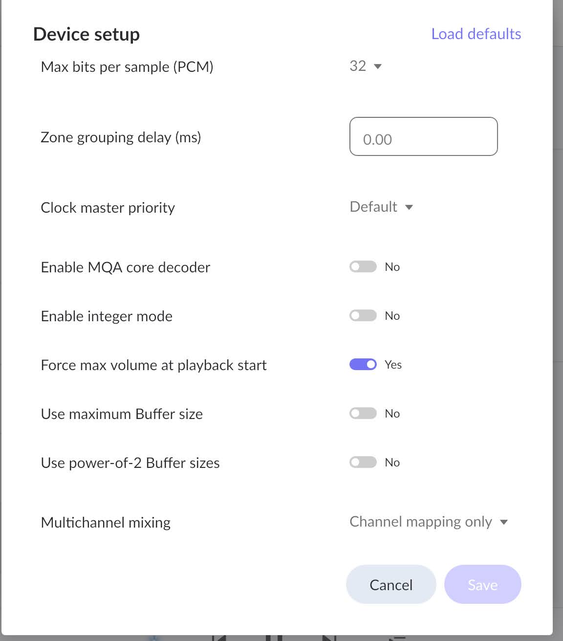

Finally getting around to trying this and I don’t have the Chanel layout option…I see this?
I think it doesn’t work because Roon doesn’t know the details of my device…it has 8 outputs, but Roon thinks it just has 2. I tried to route left to output 3 and right to output 4 which should send sound to the sub, but it doesn’t.
