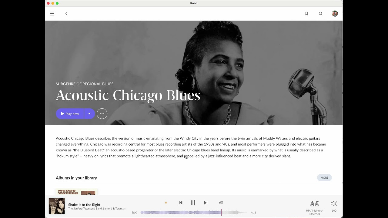

Here’s the performance on my DS918+ - I am curious - is this slow, fast, average? It’s playing music while I am doing this, BTW.
That’s way faster than my docker / ROCK on 918+ ever was. Way faster. It’s about the same as my 7i5 NUC/ROCK.
Slower than what I get I never see the Roon logo between pages on any remote.
It looks like pretty snappy performance to me. I’d be happy with that. :+1:
What are you running on?
Rock on on a 7th gen i7, 16gb Ram
That vid shows basically no delay or very negligible in the actions / work flow taken. Looking at the spec of the 918+ its a celeron? I’d say the performance based on the vid is very good.
However, being that is only a snap shot of some navigation. If the performance remains like that and doesn’t bog down after continued use, DB backups are fine, edits, updates etc… (as Brian pointed out), I guess I wouldn’t worry about it.
