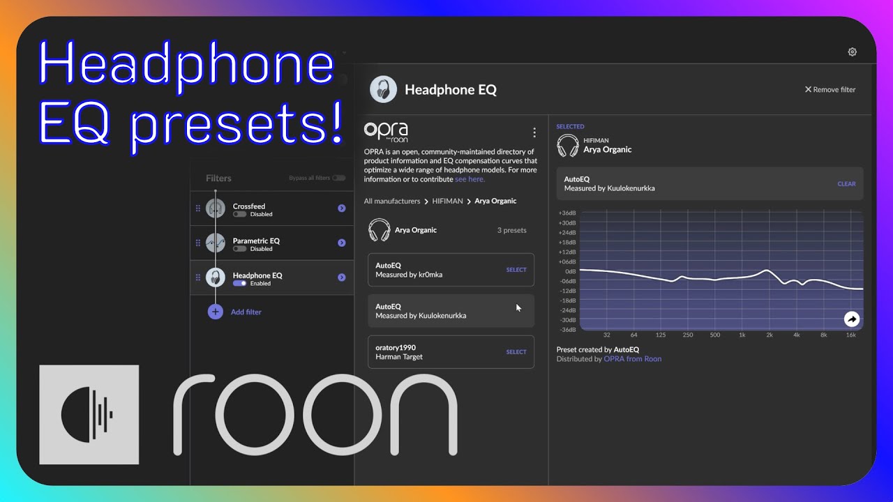

The Aussie guy on Passion For Sound has just done a great overview of Roon OPRA by the way
A link maybe ?

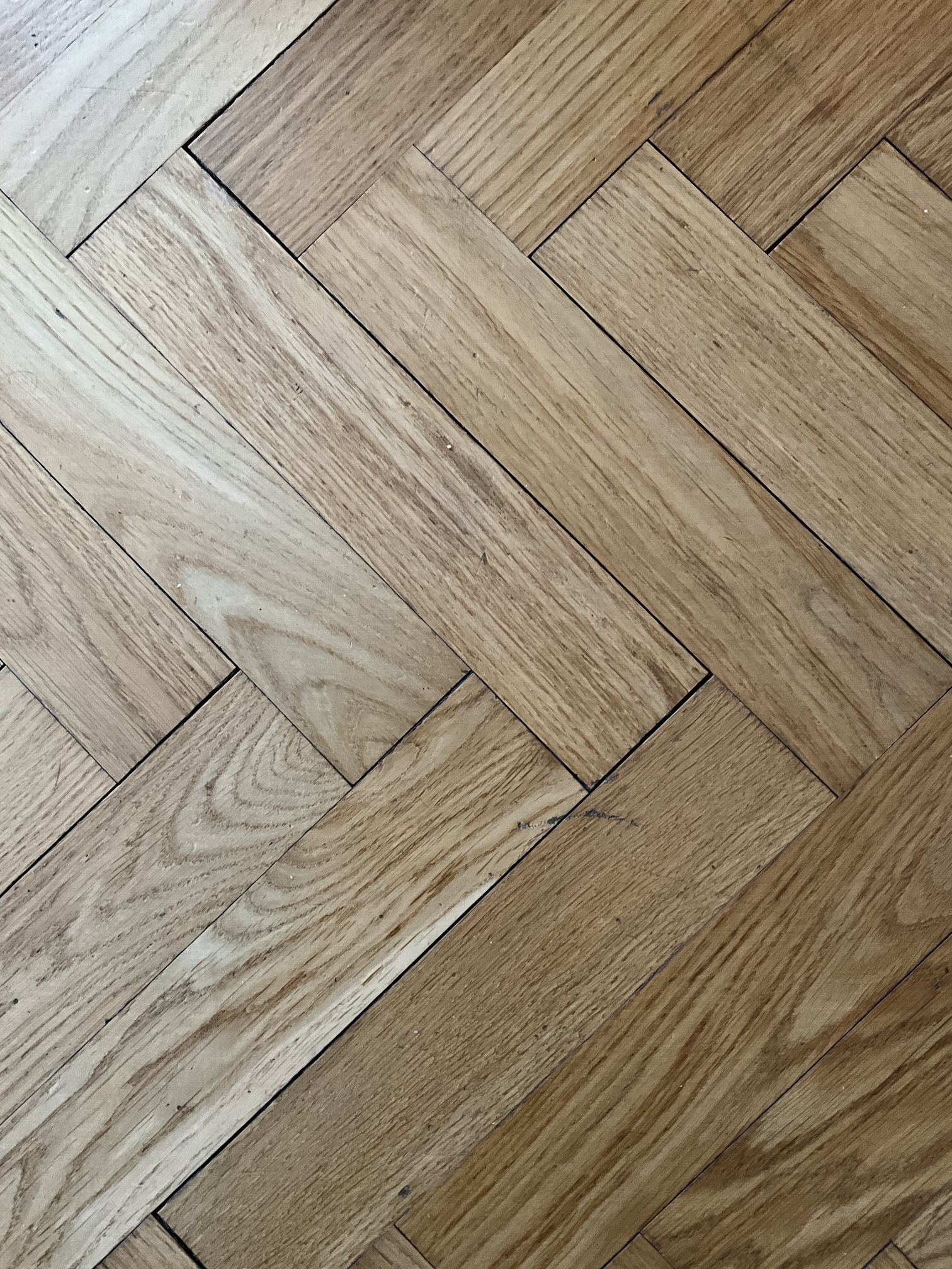

One notices on a lot of pictures, that flooring differ a lot through our various listening rooms. You will almost never find a floor with hard/shiny tiling in Norden (Swe/Fin/Nor), but rather variations on wood. And i assure you that this will have a significant impact on the sound, as but one example.
My floor as an example...
Here you go…
I was hoping for the seminar at last weeks CanJam NY, it’s an official Roon presentation
The Opra seminar from CanJam NYC, which I attended, was not about to use Opra but rather more about the Opra open source project and how headphones are measured and how headphone EQ are made using those measurements. However it was still a very useful and informative seminar. I still haven’t seen any updates as to when and if the video of the seminar will be posted.
That’s more what I was hoping for OPRA itself is easy to use , its what’s behind it that interests me
