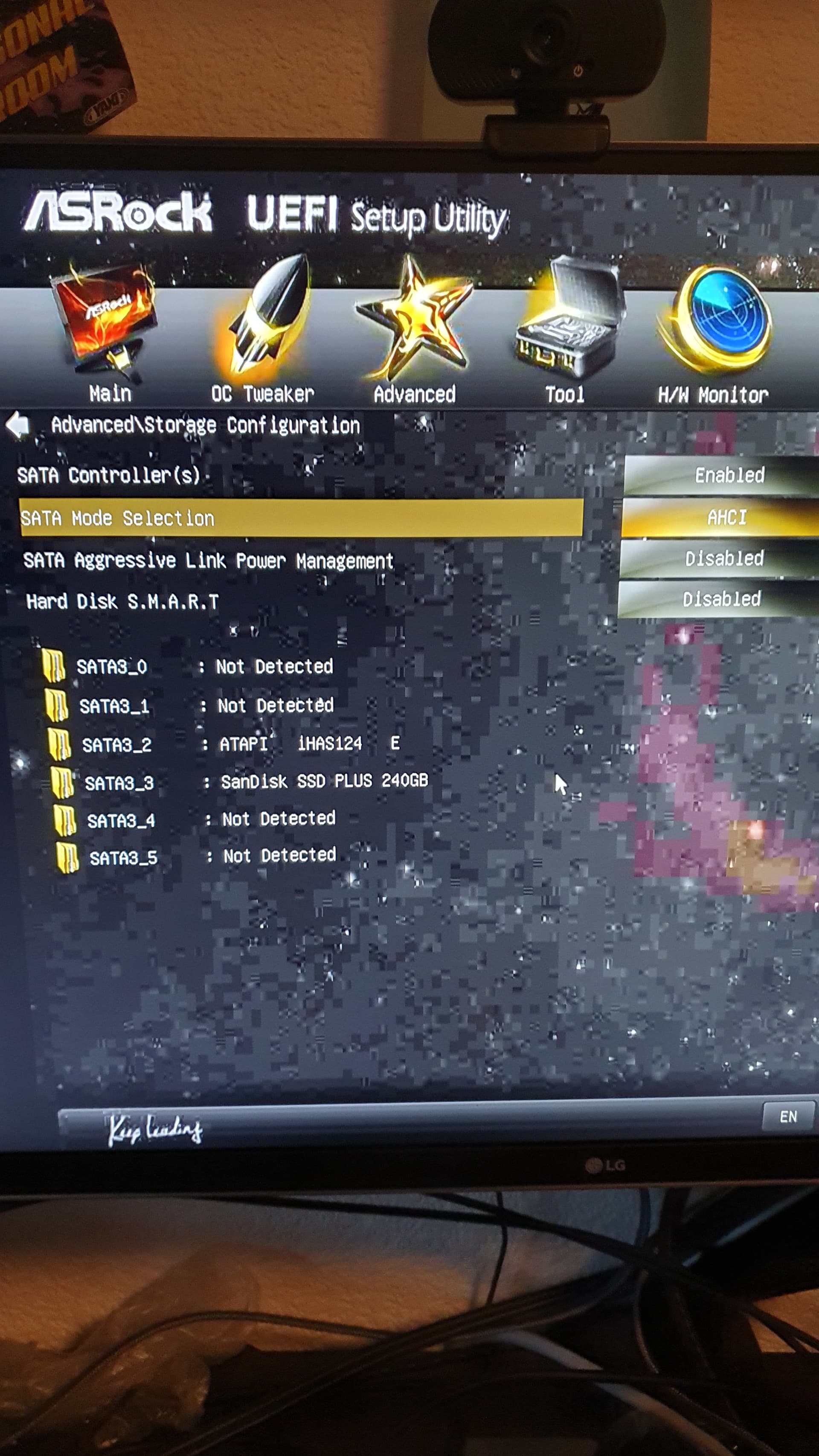

Although the SSD is recognised in Bios and is defined as primary, nothing happens.

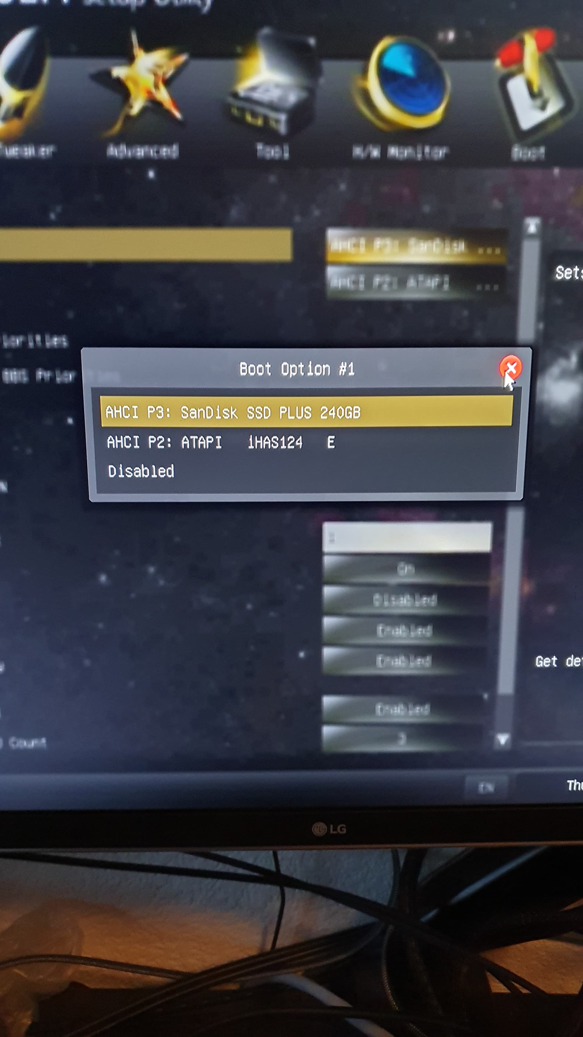

Although I have set the SSD hard drive in Bios primary Boot.

UEFi is switched off I think, I have to look again.
I also only have an SSD hard drive in the PC, so nothing that would get in the way.
Although the installation was completed successfully, and the hard drive can be selected via the boot menu without a USB stick, it does not start.
Either it really doesn’t work, or I may have activated something in the bios that is preventing it.

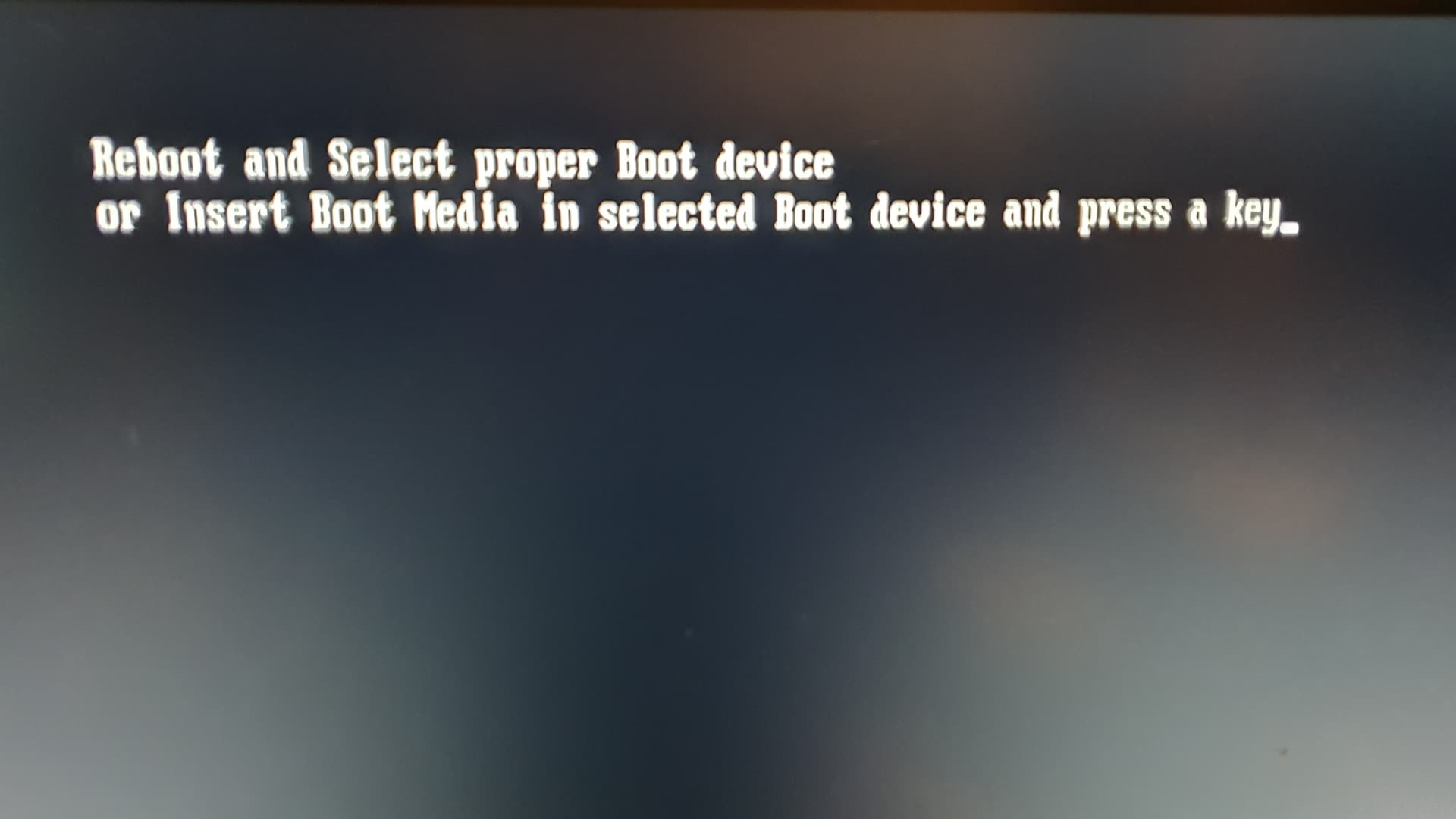

PC shuts down after installation, pulls out the USB stick and gets the same error message as with ROON Rock:
I’m starting to get the feeling that the hard drive might be defective.
Even though it is still recognised in Bios, nothing seems to be written to the hard drive.
That’s a bit strange, but unfortunately I’ve also had various bluescreens with Windows due to hard disc problems, but strangely enough I’ve always been able to fix it.
The ROOn Rock file also asked me if I wanted to delete everything on the hard drive that had Windows on it, but now the question is whether there might be a partition problem.
As of now I have no operating system on the hard drive.
