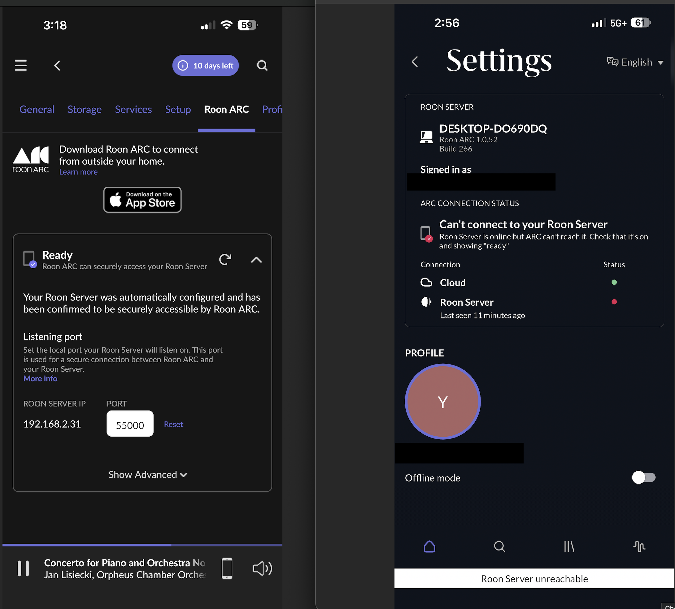

I am currently trying out Roon and I love it so far. Unfortunately, I hit a huge issue yesterday and I haven’t found anyway to overcome it: my ARC app on my phone won’t connect to my Room server anymore when I am outside my home network.
It worked perfectly fine for several days, but suddenly it stopped working. Here is what I double checked:
- My port forwarding is setup correctly. (And I redid it and tried again with a different port just to be sure. Also, the forwarding is a manual rule, UPnP is turned off. )
- My Roon server ip is static and hasn’t changed.
- There are no changes in my firewall.
- In my Roon server’s config, Roon server says it’s ready and working (see second screenshot. I took it from my Roon Remote on my phone, but it’s the same on my server directly, I double checked)
- The connection to Roon cloud is fine, but it says the server can’t be reached. (See first screenshot. The server is ready, if I switch to my home network, it works)
- It was working on my mobile network before perfectly. I used it with Car Play several times.
- I restarted my server (Roon and the physical machine).
- I reinstalled ARC from scratch on my iPhone (15 pro max with the latest iOS version).

My Roon server is on a Windows machined plugged directly into my Bell Gigabit router. UPnP is disabled and I setup a manual port forwarding. My Roon server has a static ip. I checked the troubleshooting post for Bell routers in the documentation, but it didn't help.

I checked, and I am not on CG-NAT.
Also, I don’t think it is a port forwarding issue. I just tried to set up a simple HTTP server on port 8080, and I was able to access it from outside my home network without any issues (without Tailscape, of course).
Is it possible there is some issue or bug with ARC? If I am able to forward correctly an HTTP server, I don’t see why it wouldn’t work with ARC. Or am I missing something here?
