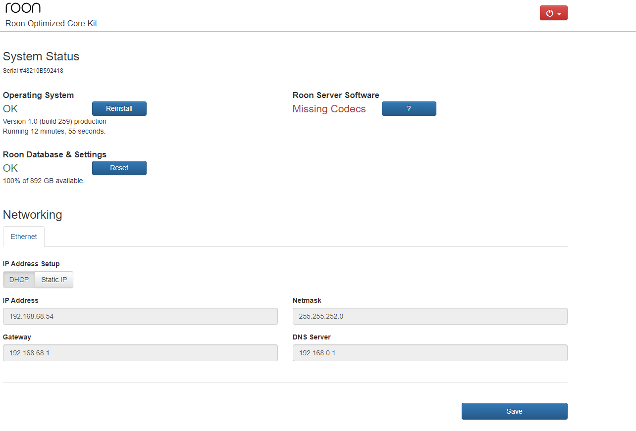

I'm new to Roon. I've purchased a NUC12WSKi7 and a lifelong subscription of Roon. I'm trying to follow the instruction given in the "ROCK Install Guide" and it goes okay until I reach the point of "Installing Codecs". I'm able to successfully connect to the Samba share "smb://rock/" (Linux) or "\\ROCK\" (Windows) and place the "ffmpeg"-file in the "Data\Codecs" directory (untared/unzipped). However, it keeps telling me in the html userinterface that I'm "Missing Codecs" - I never reach the point were the Roon Server can be restarted... Any suggestions, thanks in advance?

Hello @BlackJack. Thanks for you reply. It’s my understanding that ROCK can only be reached via the web-interface, is that correct? What’s on the web-interface is what I posted yesterday, I can press the upper right red button to reboot ROCK - tried out without success. I guess the blue button with the “?” should turn in to “Restart” when it’s realized that the codecs is in place, but this never happens…

Yes, the file was untared/unzipped and is called “ffmpeg” only. However, it turns out that it has to do with the properties of the file itself. When set correctly the “Missing Codecs” disappears from the web-interface.

You don’t need a server reboot just a web page refresh. Is it working now since you mention the “Missing Codecs” button is now gone.
So, now the web-interface looks like described in the installation guide, I guess Roon is running. However, I cannot connect to it from any of my remotes (iPad, Android phone), I keep getting the message: “Waiting for your Roon Server…”. Any ideas how to move forward from here? :slight_smile:
