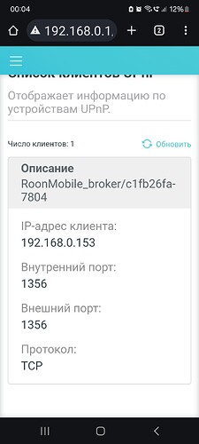

Thanks for the quick response. I did it many times.
My router is Archer S80. Internet provider https://www.seven-sky.net Nucleus is connected to CHORD COMPANY EE 8 Switch EU. I don’t us vpn. I have the ports forwarded on both.

If the switch you’re using has network address translation capabilities, then I recommend bypassing that unit entirely and just hardwiring the Nucleus to your main upstream router.
Additionally, the port you’ve chosen in your screenshot is commonly reserved for ISP activity. I recommend augment the port integer in Roon Settings and any router port forwarding rules.
You’ll also want to inquire whether your service provider has implement carrier-grade network address translation.
