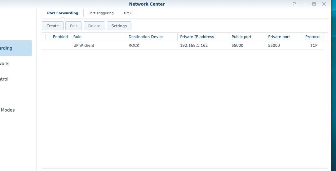

I have a Draytek Vigor 120 in bridge mode
I have a Synology RT2600ac with upnp enabled
the core is running on an intel nuc

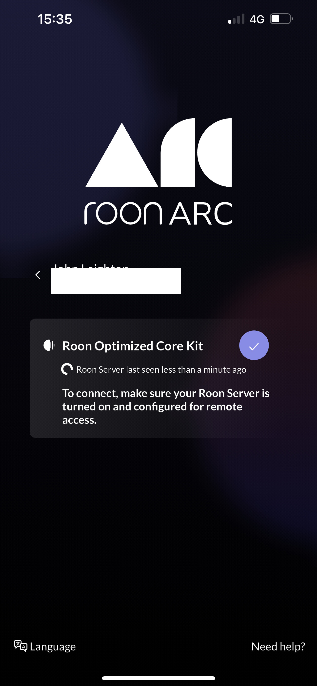

The port forwarding is correct and the Roon application says ARC is working but when I connect via 4g it won’t connect.
The Broadband is Plusnet fibre
also its a static IP
draytek vigor 120 (bridge mode) Synology rt2600ac intel nuc core connected with cat6 cable

it appears my success did not last for long. maybe I logged on over wifi last night. I tried today and it hasn’t worked.
I have changed the port to 55002
tried VPN over 4g, Roon ARC could not find server
there is no VPN on the Roon Server
there is no second ethernet or wifi
no other firewalls or antivirus.

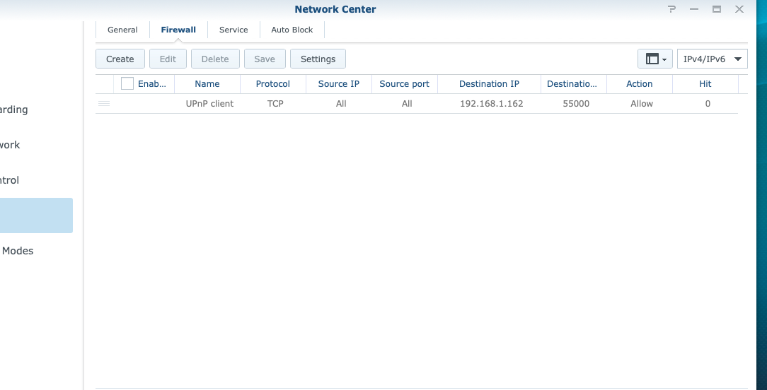

I configured the port manually and made a manual firewall rule, didn’t work.
when I try to connect over 4g Roon ARC says “online and ready”
but when I try to connect it doesn’t

Let’s also try setting up a manual port forward instead of using UPnP. Your Synology router will likely have an option to create a TCP port forwarding rule. Build one pointing to the IP address and listening port in Roon Settings → ARC.

Hi
I tried connecting on another mobile network (o2) with a different phone (iPhone SE) and ARC connects on 3g. So I’m guessing there must be a problem with my network (three) or my phone (iPhone 13 Pro Max). What do you think?
@connor
I tried factory resetting the phone but same problem persists.
Maybe it’s the network?

Yes it’s very strange it doesn’t work. I have tried manual port forwarding and checked the phone application for data over mobile. I do not have any other network range apart from the standard 192.168.1. X
I do not see why my mobile network would block the service, plex works fine and connects to an open port on the router.
