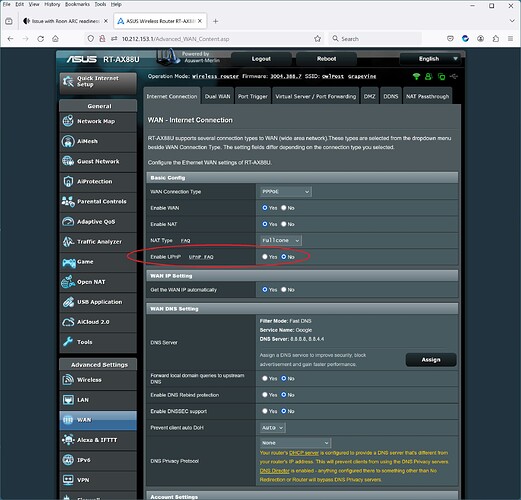

Here is the uPnP setting in the WAN setup:

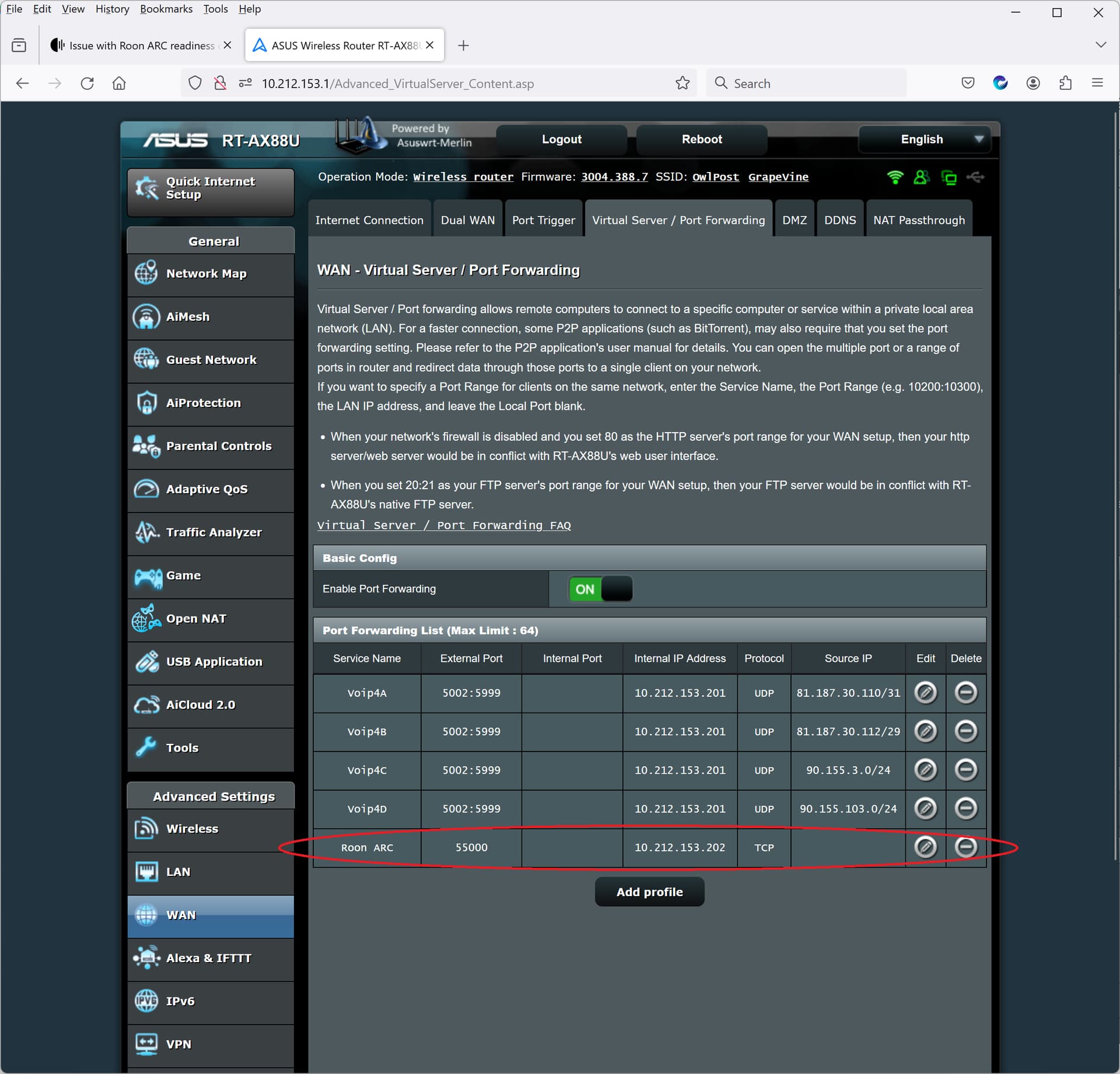

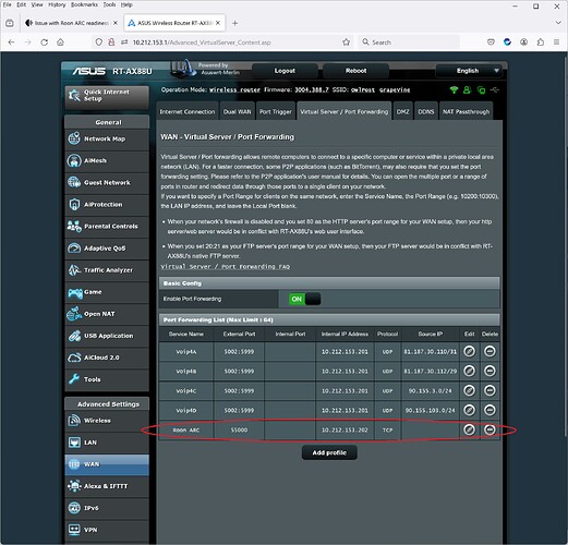

And the Port forwarding rule (The other rules are associated with my VOIP phone servce and have no relevance here):
Note:
  1. I use Merlin Firmware on my RT-AX88U but I don’t think that that would make much difference either to the layout of the settings or their functionality.
  2. I have set the lan side ip address of my router to 10.212.153.1 (for historical reasons) and so the 10.212.153.202 ip address is the normal ip address of my Roon server.

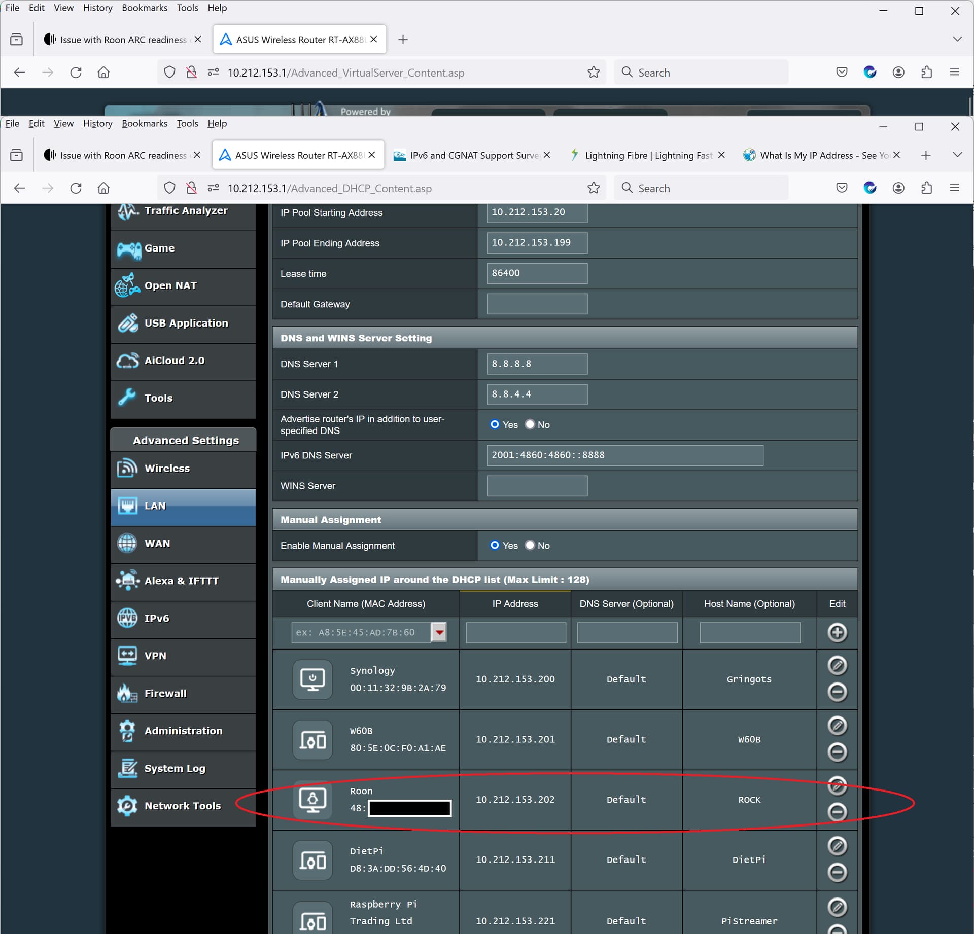

With an explicit port forwarding rule, it is a good idea to make sure that the ip address of the Roon Server does not change. I have done that with a DHCP reservation:

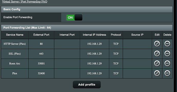

Thanks for your reply Wade.
So I have the same port forwarding rule
My Roon server is contained in my Nas which has a fixed ip address too.
Following that link reveals the same ip address as the Wan side of the router, so it looks like CG Nat is not in operation. So I’m puzzled as to why this happening and why it simply stopped working some time last week.

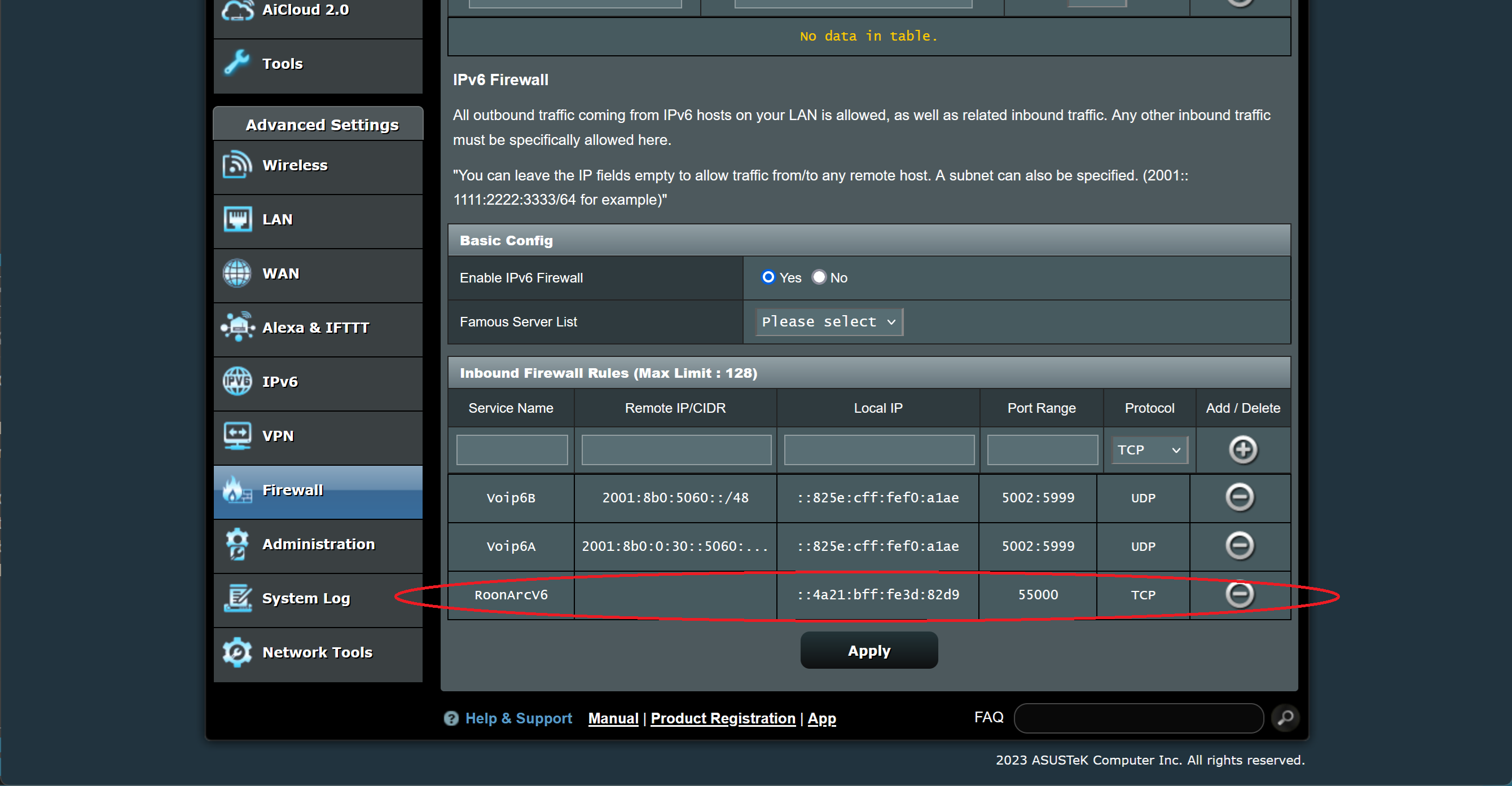

One caviat: When reading around to find out whether or not Lightning Fibre used CG-NAT, I read that IPv6 support may be added at some point this year. ARC can use IPv6 if it is available on both the home network and the remote network. However, it needs pinholes to be added to the IPv6 firewall on the ASUS as shown below:
The strange ip address in the highlighted RoonArcV6 rule (leading with ‘::’) is because BT, my ISP, use a dynamic IPv6 prefix, which means that my actual Roon Server IPv6 address changes periodically. The format used in the firewall rule illustrated, leading with the ‘::’, allows the device specific IP suffix only to be specified so that the firewall exception will continue to work when the ISP issued IP prefix changes - so I don’t have to keep changing the IPv6 firewall rule!
WARNING: Don’t enable IPv6 ARC connectivity unless you want to be able to use it. If you do, then,at present, any failure in IPv4 connectivity will go unreported in Roon → setttings → Roon ARC whilst the IPv6 connectivity is working - so if you find that ARC is not working over IPv4, you have to turn off the IPv6 firewall exception before you can see what is wrong with the IPv4 connectivity.
