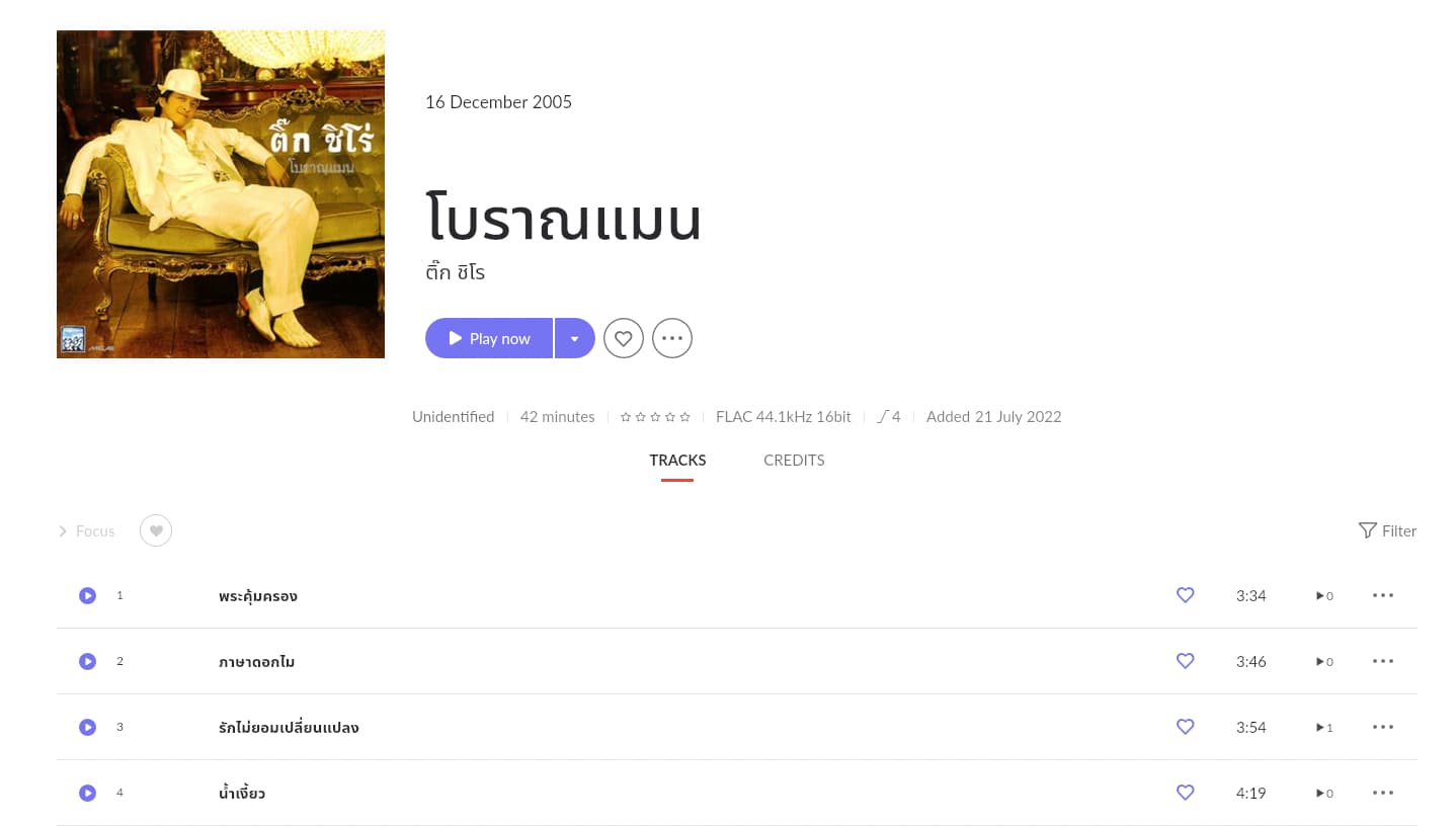

There seems to be an issue with how Roon fails to display some vows in Thai characters.
As the picture shown above, an artist name should be ติ๊ก ชิโร่. However, Roon omitted a vow which result for as ติ๊ก ชิโร. Same goes to the 2nd track. The track title is ภาษาดอกไม้ but Roon is showing as ภาษาดอกไม. Interestingly, the same missing vow is shown properly on track #1 and #4.

Thank you so much for your reply. I have uploaded 6 files that showing issues with the vows on Roon. They’re either having issue in the song title or artist name. You can check the metadata editor in Roon and you will see that it is somehow correct in there (usually I click on a pencil icon and copy the value over). Please let me know if you have any more questions or needed more file samples.
