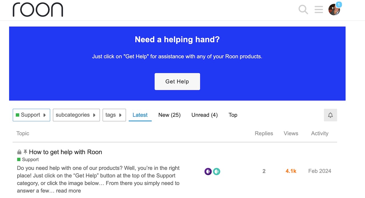

I believe the best solution is to contact Roon’s support team through this same forum by going to the support section, where a banner like the one shown in the screenshot I’ve included will appear. After clicking on “Get Help,” a long questionnaire opens, but it is worth filling out.
That’s exactly what I did on February 9. Within 24 hours, yesterday, Roon support reached out to me, asking me to repeatedly attempt to play music on my SOUNDBAR+ from Roon and then send them the Roon logs. They provided clear instructions on how to do this, along with a link to upload the files to their servers. The process is straightforward.

In summary, the best course of action seems to be to seek Roon support through this same forum, where you will see the banner pop up.

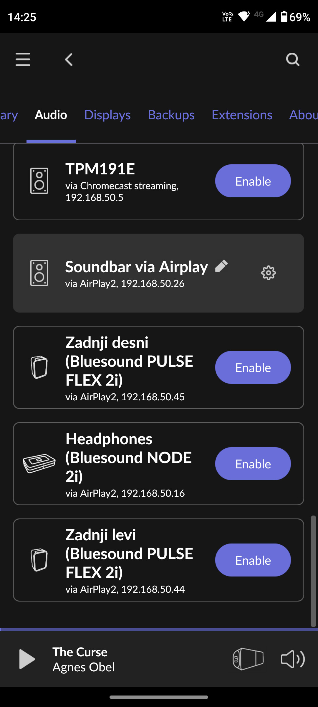

Are Bluesound Pulse speakers “truly” ROON endpoints? Anyone have success using these speakers without Bluesound NODE or NAD equipment. If on a wired network wouldROON (nucleus) play? After latest BLUOS update, ROON not working, cannot find server. Suggested to friend uninstall ROON Remote and reinstall.
Oddly enough, all other Bluesound devices appear in Roon settings for Airplay2 with correct icons, except for pulse sound bar +. It is correct icon for RAAT though it doesn’t work
It may be that there is a problem with Room not recognizing sound bar + anymore, at least not correctly. Funny thing is airplay 2 works correctly.
