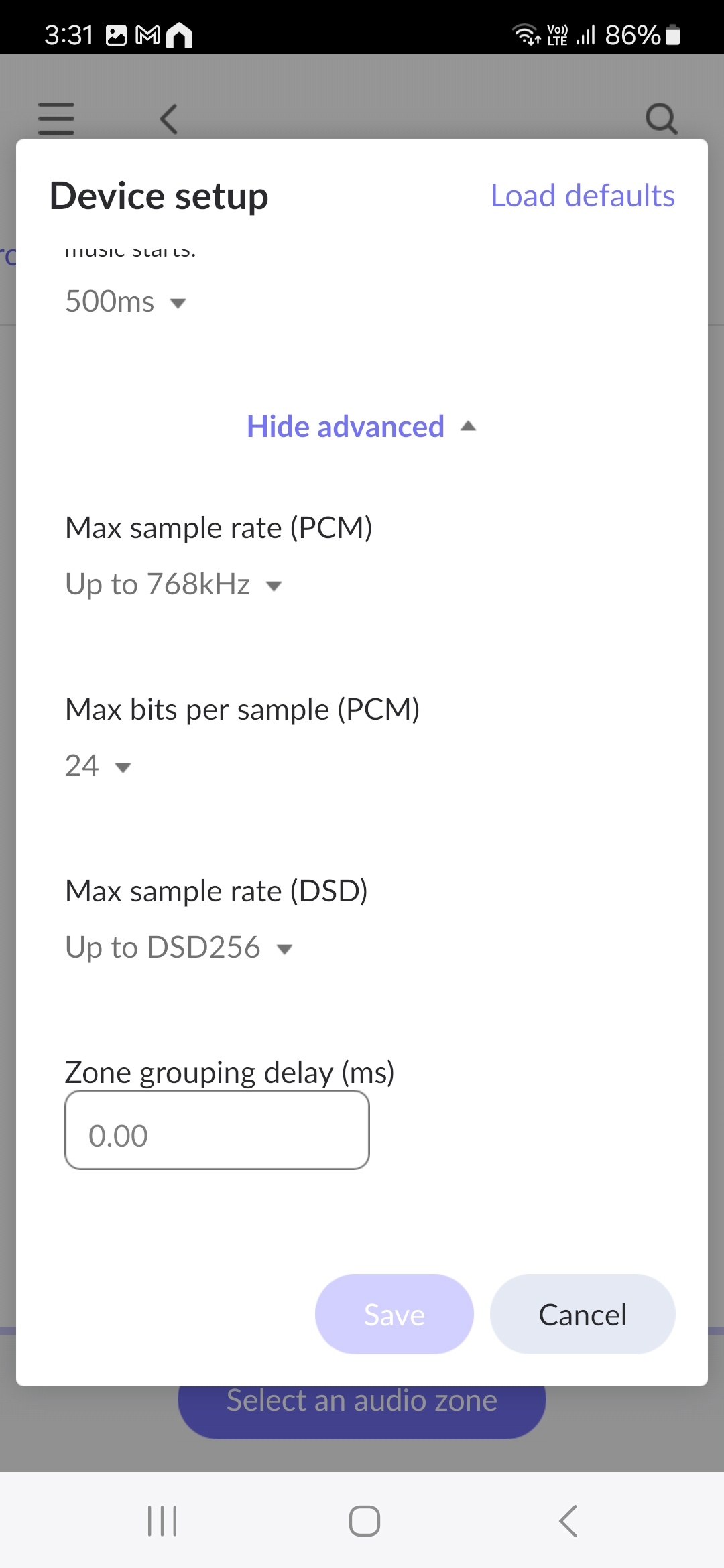

I used a Music server with OS linux, i used roon core and roon endpoint, roon endpoint connect to my MSB DAC reference by USB cable ( A to B) to Pro USB on MSB DAC. The problem is when i setup device on audio MSB Dac such as : 1/ DSD playback strategy can not play Native DSD; 2/ Max sample rate (DSD) is
DSD 256. while my Pro USB on MSB reference DAC support Native DSD and DSD 512. link from MSB product https://msbtechnology.com/dacs/prousb/. pls help me solve this problem. Thank you

Do you not see a DSD strategy section should be top of the settings? If so set it to DoP.
I have set it to DoP in DSD strategy but max rate sample up to DSD256, not DSD512, while my MSB DAC supported tup to DSD512.
DoP requires higher PCM rates than 768/24 to allow higher DSD encapsulation . This is a limitation of your DAC not Roon. DoP is an encapsulation method to allow DSD to be sent via a regular PCM stream as all DACs support this. It’s not converted just encapsulated it is the exact same DSD data as DSD Native. DSD64 requires PCM 96/24, DSD128 requires PCM 384/24, DSD256 requires PCM 512/24, DSD512 requires higher than 768/24.

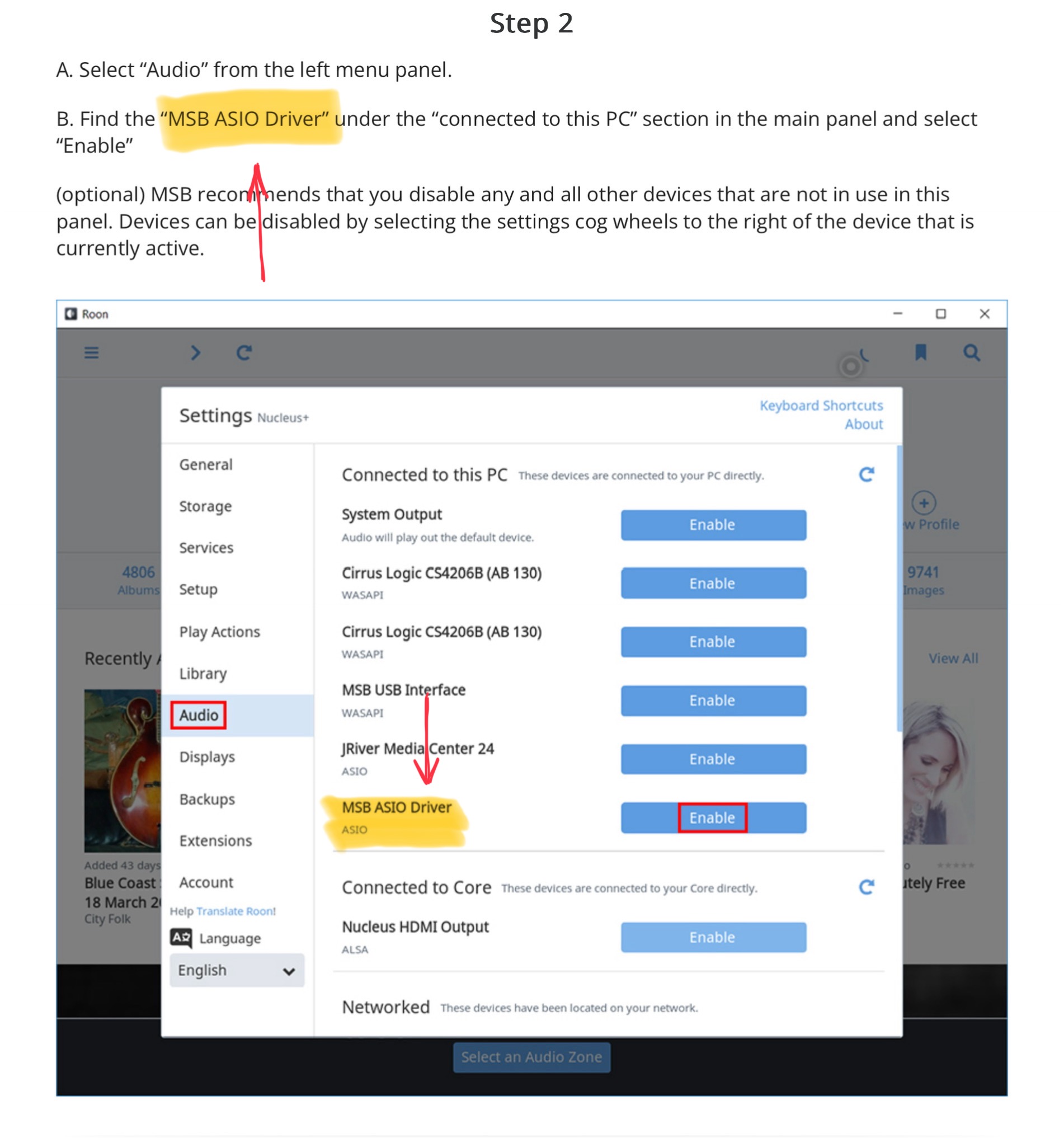

You can just setup a Windows box as an endpoint and use one of the very low powered Windows PCs to do so (about 140 USD here in the US). They come with Windows pre-installed. All you need to do is to install 1. Load The MSB ASIO driver and 2. Load RoonBridge for Windows. Plug ethernet into the Windows PC, plug USB out to the MSB.
