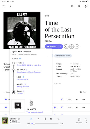

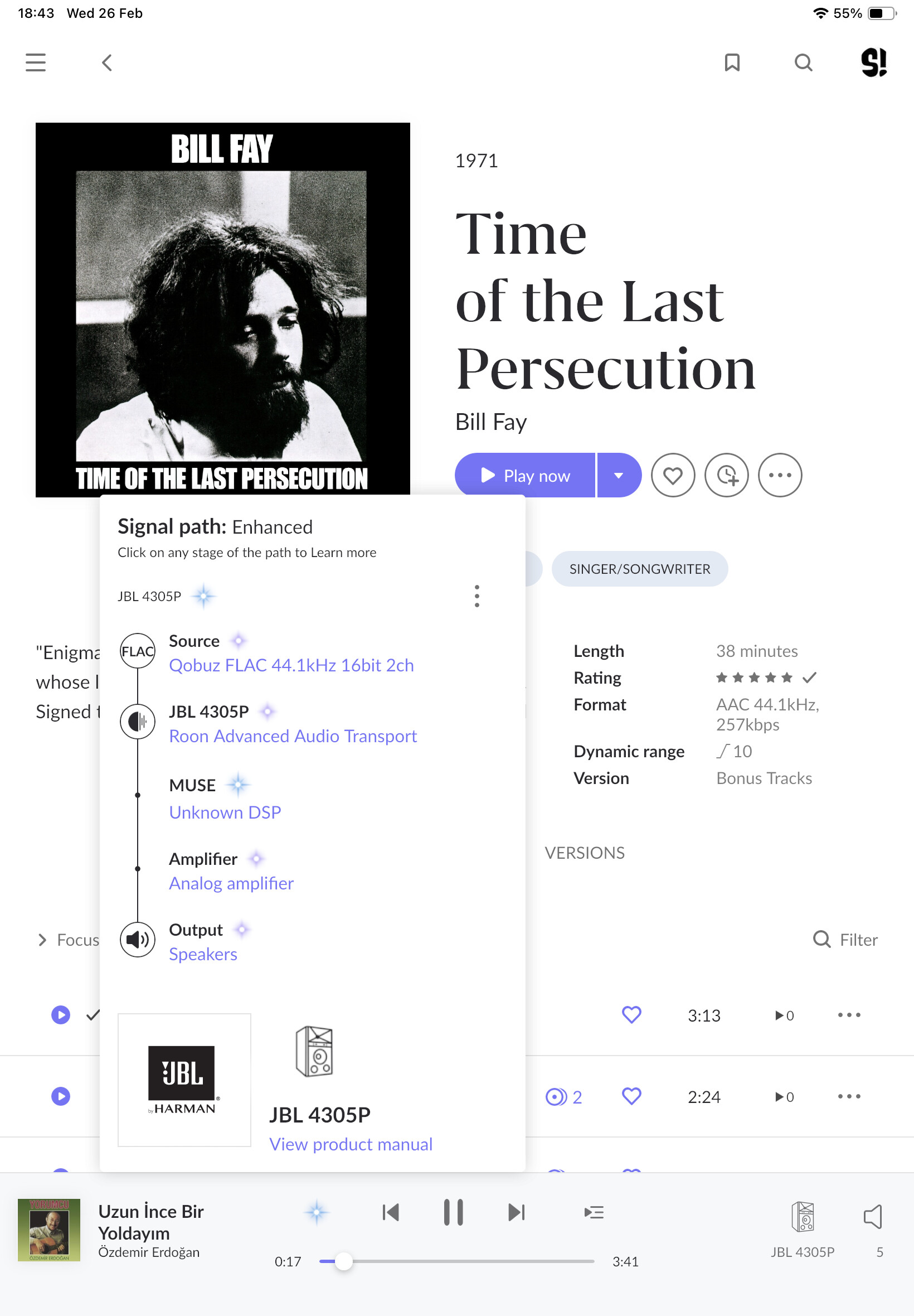

I am loving my 4305P. I am using my Nucleus as multi room. Down stairs it powers my Cambridge Audio CXN V2 and upstairs my new 4305Ps. I used my MacBook Pro, iPhone and iPad, and across all of these something strange is occurring. Initially I got lossless and then enhanced with Muse showing up as unknown. When I reset the speakers I am back to lossless, which sounds much better, but when I turn the speakers off and back on it’s enhanced again. Help. I just want lossless with no dsp.

Please post screenshots of the Roon signal path, ideally of both versions
The file is low res too.

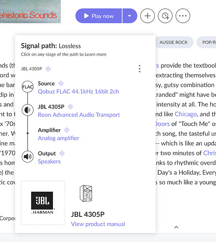

Will rest speakers when working in office. It shows lossless with nothing showing for Muse.
Looks like the DSP is happening inside the speakers. That’s not something you can control with Roon. I’m not sure why it says “MUSE”, but perhaps when JBL implemented Roon’s firmware as part of Roon Ready certification, they forgot to change the name of the internal DSP?
Yes Jamie Madden at Roon said the same. Shame, as they are louder and sound better without the processing. I guess I just have to reset every time I turn them on.
This is what happens when I either reset the speaker using the button on the back or power off.

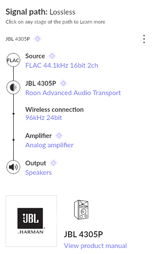

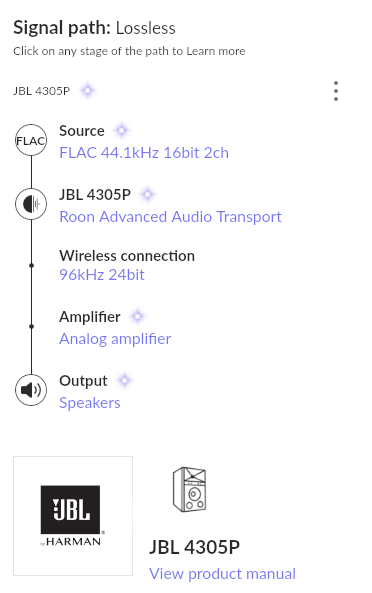

Hi. I’ve had this exact same issue. Every time the speakers come back from standby it would show unknown DSP. However, after the most recent update of Roon, I have noticed this has been fixed. It no longer shows MUSE Unknown DSP even after standby. Not sure if you still have the JBL 4305P, but if you could also check.

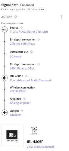

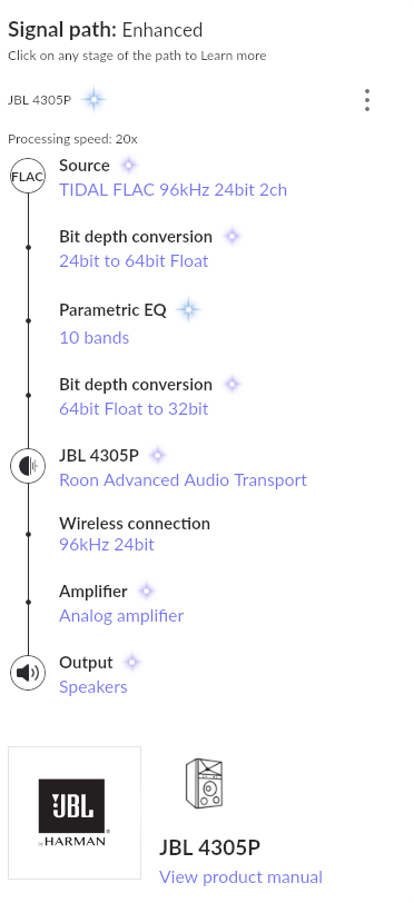

Mine was showing enhanced because I was using Parametric EQ. Qobus shouldn’t make a difference as mine was showing that “MUSE Unknown DSP” when using Tidal or music on HDD. Anyway, here it is without EQ.
