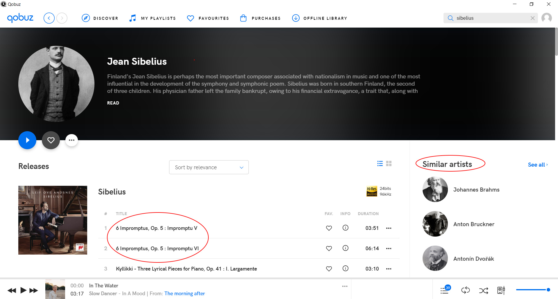

But I find this a lot. Not every time but a lot. Has Qobuz got no composer credits a all? I notice that on Qobuz when I do a search of a composer it doesn’t return a list of similar composers but a list of similar ‘artists’. I also notice there is no grouping of multi-part works. I am so used to rubbish meta-data that at first I just thought that was all it was and just filled in the gaps manually myself. But this is looking systemic. Is that thee case
