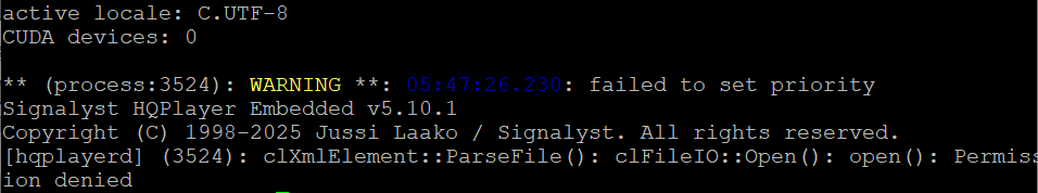

Today I connected the hqplayerd directly to my DAC (I used WooAudio WA7 because of its small size). The problem persists (left channel a bit earlier than right).
$ sudo tail -f /tmp/hqplayerd.log

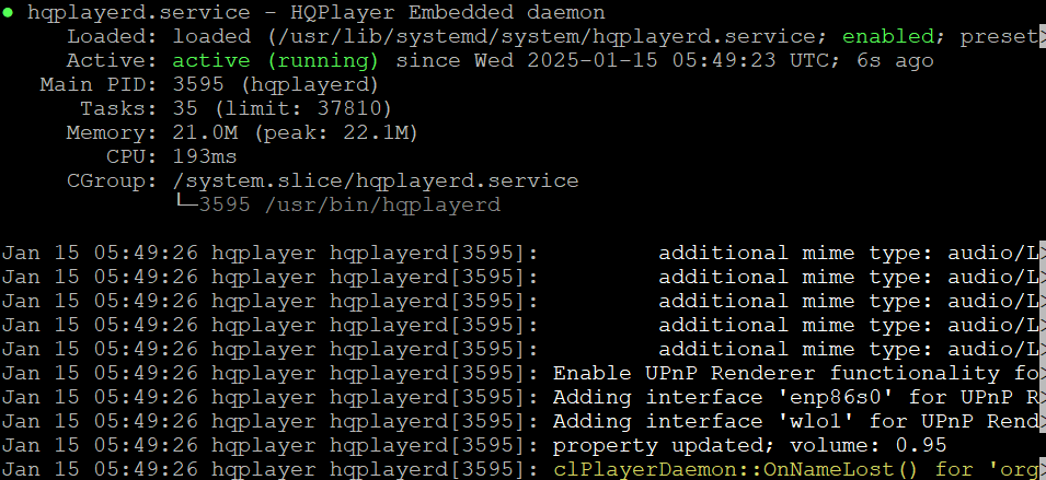

$ sudo systemctl status hqplayerd

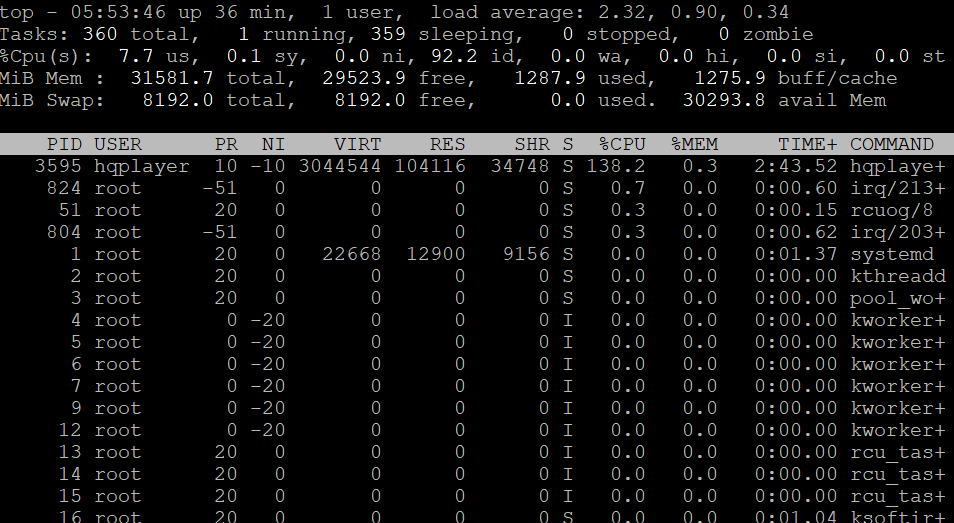

$ top
$ hqplayerd hqplayer hqplayer
What is this? What are you trying to do?

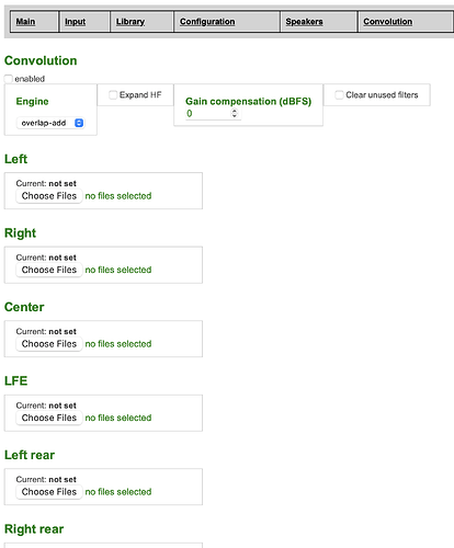

And you don’t have anything under matrix/convolution/speaker configuration?
Nothing. just wanted to show you the information as much as I have. I found this command on the threads

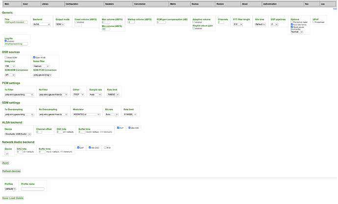

I didn’t change anything. Here are the screen shots
Matrix
Convolution
Speaker
PCM and SDM using ASDM7 work fine. But all the other modulators e.g. ASDM7EC, ASDM7EC-V2, ASDM7EC-ul have the async issue.
But you don’t want to run a second copy as normal user while the service is already running. That mostly looks like setting web interface credentials for the first time, but missing the “-s” argument.
