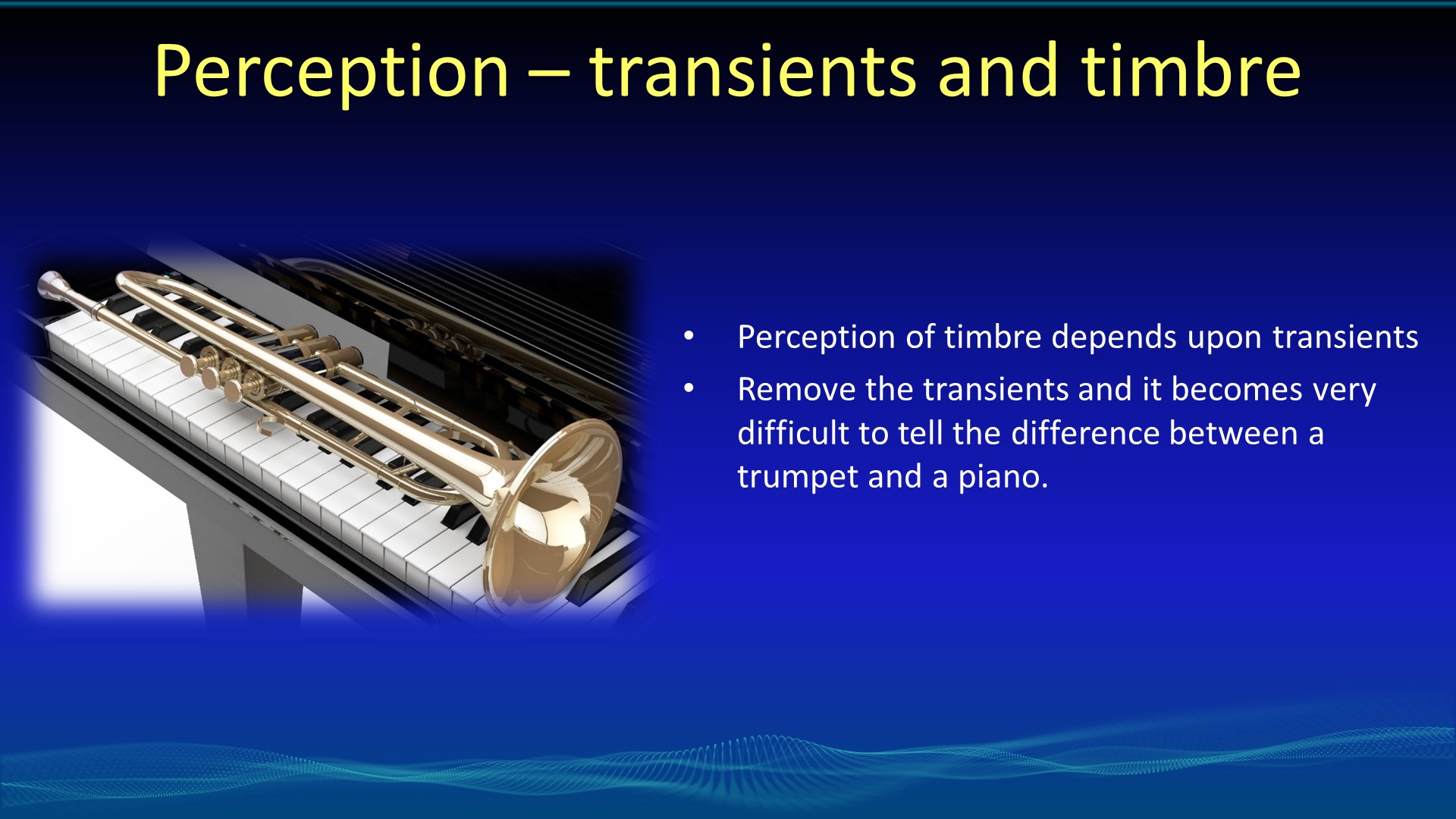

On the topic of pre-ringing… check out this video from 6:10 where Rob Watts discusses issues with removing pre-ringing and he refers to an experiment with bass guitar and trumpet and piano.
Here are the relevant slides…

The pre-ringing in the case of a sharp high pass filter with transition band placed within the audible range is much more likely to be audible. Therefore a mix engineer should stick to minimum phase for any sharp (high Q) filter that is within the audible range. Often this kind of high Q filter would only be used on a particular track of a multi-track recording (fix one bad instrument/microphone recording but leave everything else unadulterated). In general, for mastering and any work involving the entire final mix or any work with low Q filters there is a tendency to always prefer linear phase because it preserves the original time domain relationship of the frequencies: imaging, amplitudes and timbre.
If we look at digital playback, the accuracy of the original signal is best replicated by a linear phase filter with a transition band that is entirely above the audible range, with the lowest passband ripple and the highest possible image foldback supression: this preserves time domain information within the audible range perfectly and any pre-ringing will be at inaudible frequencies.
Rob Watts is correct about a few things. The idea that you need such high sample rates (768KHz) to temporally define transients within the audible range to less than a 1usec is unfortunately an obvious big blunder. Ordinary CD well defines transients to less than 1 usec.
The approach of using a good FPGA with high tap linear phase filter to have better filtering than what is on widely available DAC chips is good design. Whether 1 million taps is necessary is kind of like how many angels can dance on the head of a pin. The fact that Rob has designed his own filter partially using science but partially through listening tests, suggests that the sound is tailored a bit to his taste. The approach looks more rigorous than MQA. MQA appears best suited to poor quality D to A converters. MQA might make run-of-the-mill converters with cheap DAC chips with poor filter design sound better. MQA can only make a well designed DAC with proper FPGA designed filtering sound worse.
