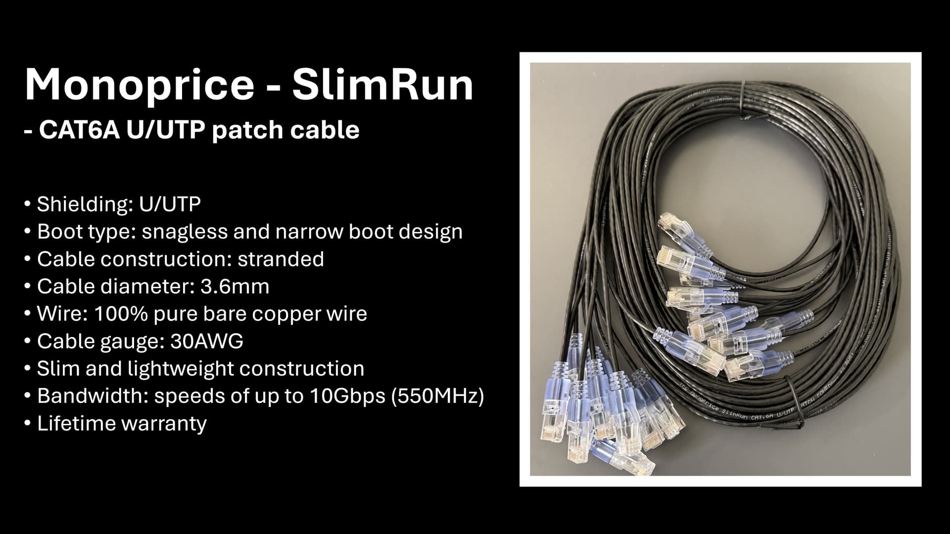

Hi Günther
Great :slight_smile: Make sure to use U/UTP cable between the switch and your Linn
I use this:
Or any other U/UTP cable. Just make sure it is U/UTP
Torben
