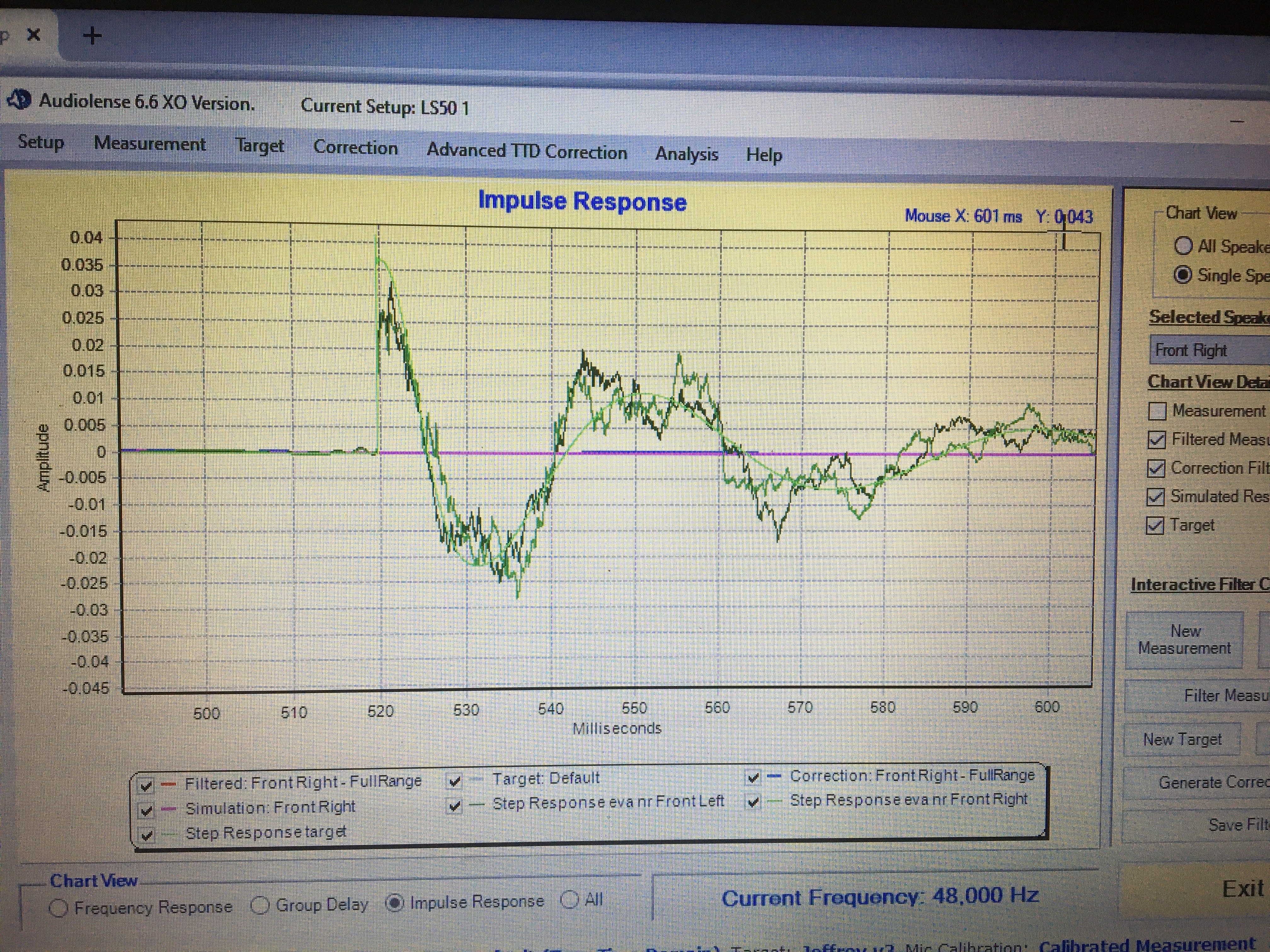

To give you an idea of how good Audiolense works, below are the measurements for 2-channel in my second system — LH Labs Geek Pulse Xfi DAC, Marantz AV-7702 prepro, Carver AX-705 5-channel amp, Carver Sunfire True Subwoofer Mark IV And KEF LS-50 mains. Sounds great. JCR
