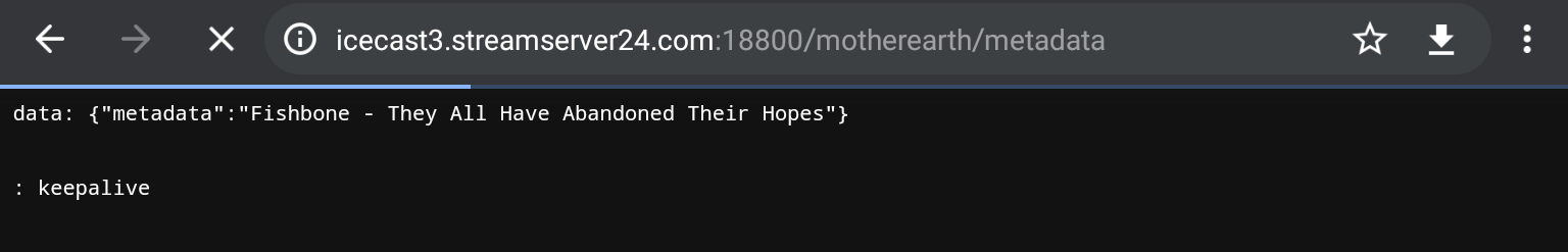

we have upgraded the radio to RSAS, Roon should be fine now.
Anyone interested could add the station via this adress:
http://icecast3.streamserver24.com/motherearth.pls

Does the cover-art get through to you guys?
No it doesn’t Florian. At present Roon can’t process that and relies on identifying the track and artist and presenting the user with an appropriate album.
I’m curious as to where the album art is - I don’t see it in the stream or your website.
Brian
I was just curious; since i serve files with cover-art embedded to RSAS, i was hoping cover-art would make it into the stream - yet it doesnt look like it for a start.
I’m new to Rocket Stream Server so i was just checking!
Thank You indeed Brian!
I don’t think it’s there
Nothing else advertised.
EDIT
I don’t believe Icecast type streaming can deal with cover art. The only way is to send separate flac files with embedded art (which is where we started).
So, did Roon give you some artwork by identfiying track and artist?
Would it then be helpful to try and get the “album”-tag included?
