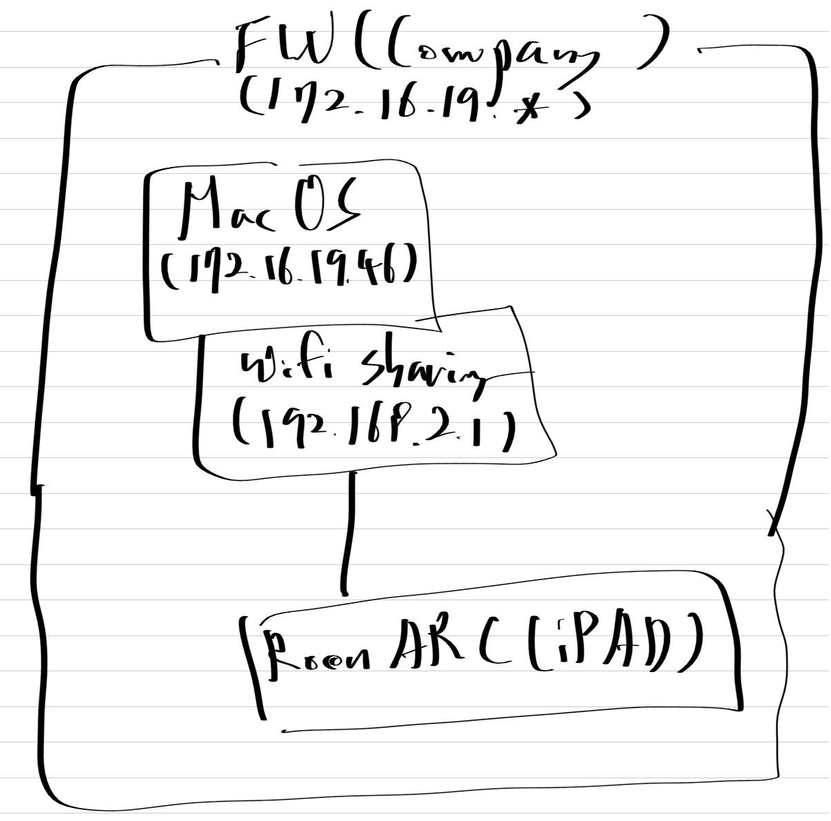

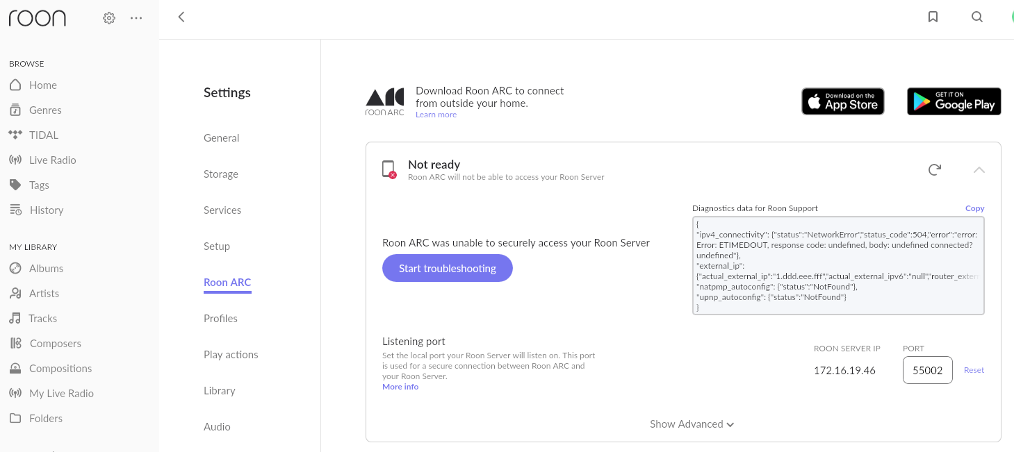

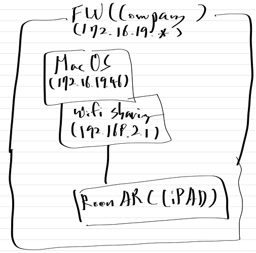

Local Roon ARC fail to connect to local server but success from local network
I’m confused that from my roon server, Roon ARC menu shows “Not ready”
but Roon ARC of same network successfully connect to Roon Server.
what can I do more?
I think changing roon server IP can be solution, but unable to change Roon Server IP
Yes, it is perfectly normal for Roon ARC to be able to connect when your phone is connected via WiFi to your home network. This error message is telling you that you won’t be able to connect remotely (i.e. when outside of your home network and using mobile connectivity services.
PS - I’ve moved your post from Uncategorized to the ARC: Port Forwarding Help category of the forum to bring it to the attention of the Support team.
Please post more details of your setup, including who your ISP is. Thanks.

unable to change anything for the firewall because it is company firewall.
if you mean roon remote as roon client, it is running well.
but I want to run RoonARC remotely (iPhone, Astell&Kern SE300 DAP via iPhone)

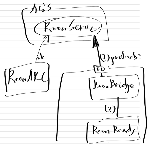

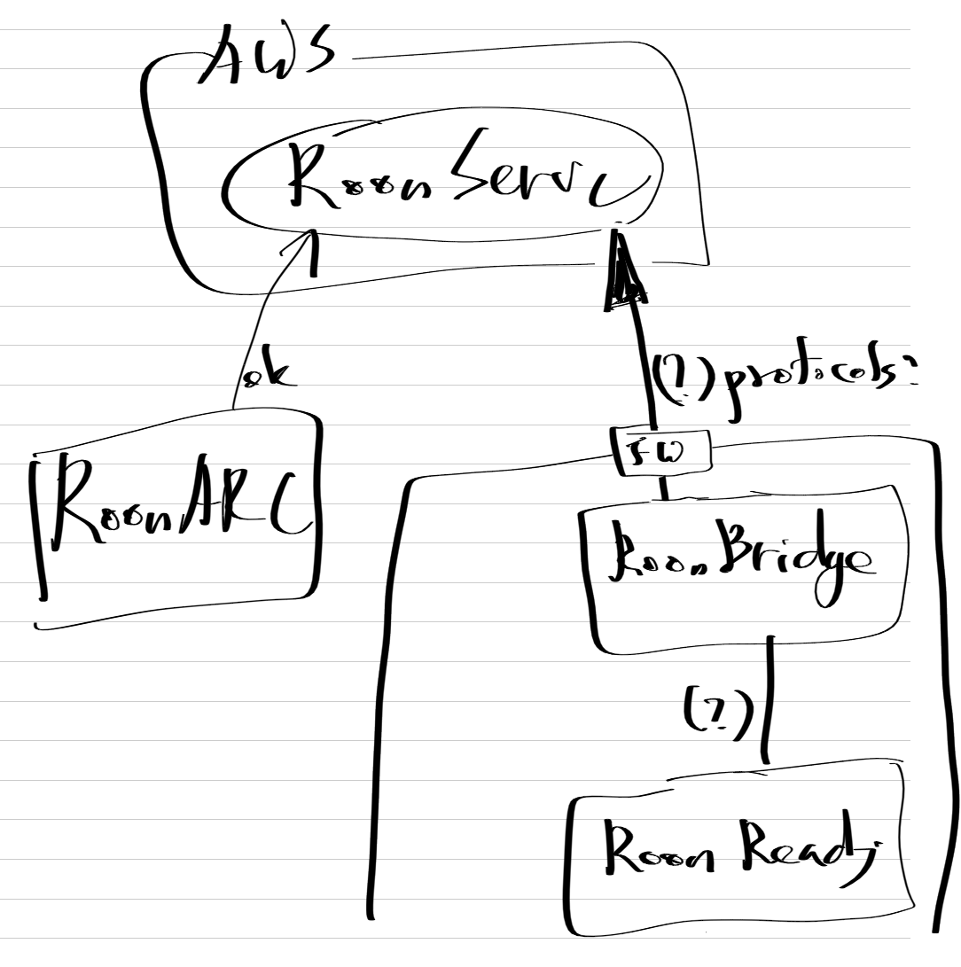

any other possibility using roon Bridge locating out side of company network? but still protocols are unknown between roon bridge and roon server.

installing RoonServer at Cloud such as Amazon web service
installing RoonBridge at company network inside playing local music players and speakers.
RoonARC access to Cloud RoonServer.
is it possible scenario?
Not possible
