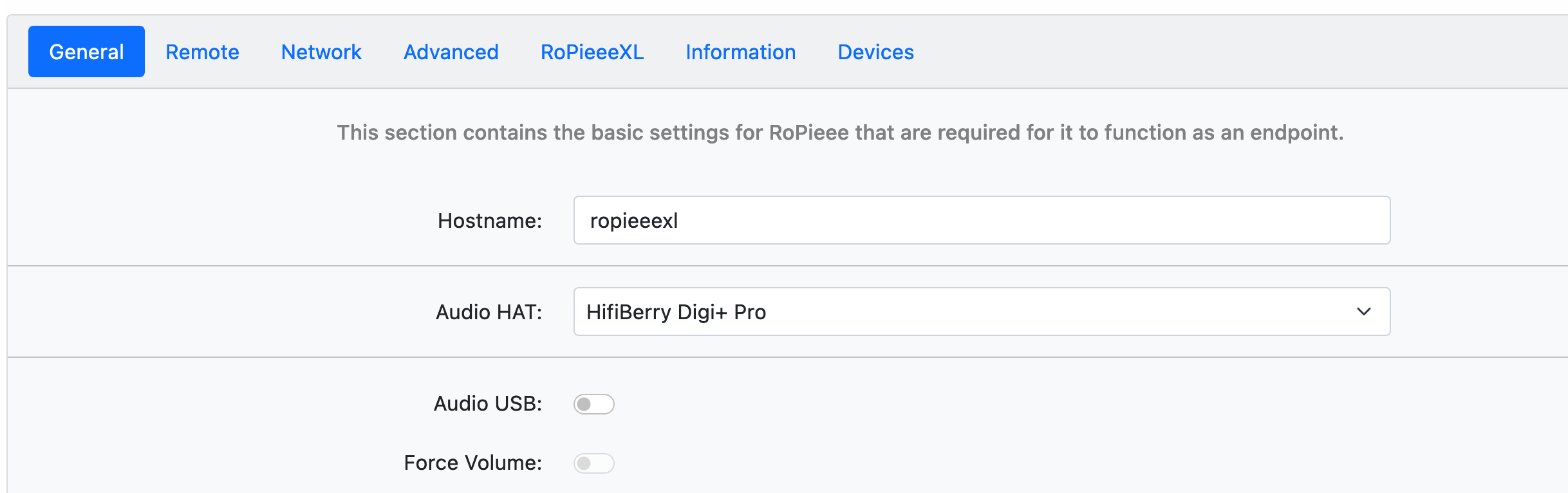

How can you have both on the same Pi 3?
There is only one HAT on the pi. Audio HAT is what the driver is called in the RoPieeeXL web page and I wanted to use the same nomenclature:

@mSpot, I tried what you said and changed the RoPieee to have no hat configured, turned on USB Audio, and left the HAT physically connected.
I was consistently able to get music to play, but would occasionally get errors about the file loading too slowly, where then Roon would skip to the next track. I would think this is probably due to a transfer rate issue because of the wifi connection, but I won’t have time to move it closer to my router for the next couple of days.
