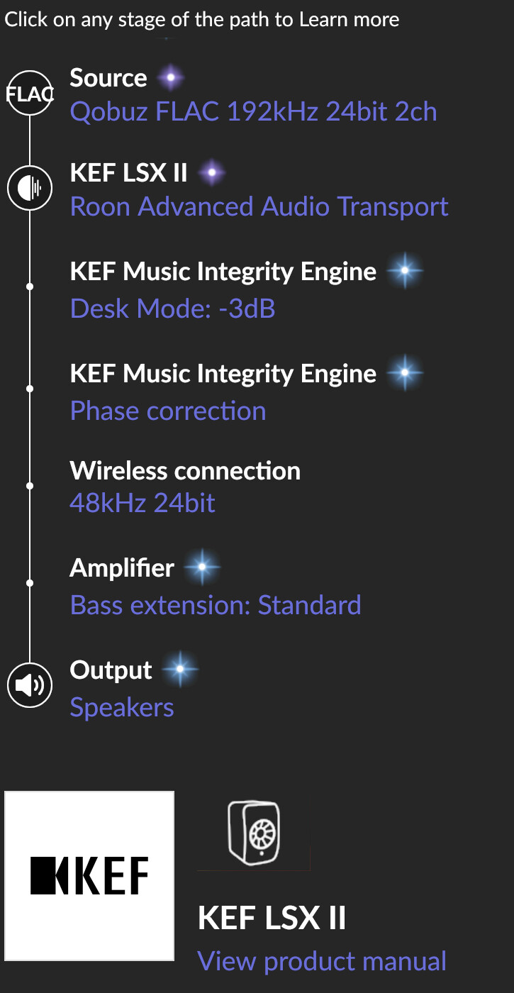

I’m inclined to believe at the moment that the wi-fi implementation is weak rather than faulty, as they do play flawlessly over Google cast at 44.1 and 48kHz.
I can either accept downsampling the occasional hi-res album or (if test 2 works) invest in a third disc for the bedroom to ‘expose an ethernet jack’ as the Roon help pages put it. (I think that help page led me to add discs when I moved house).
