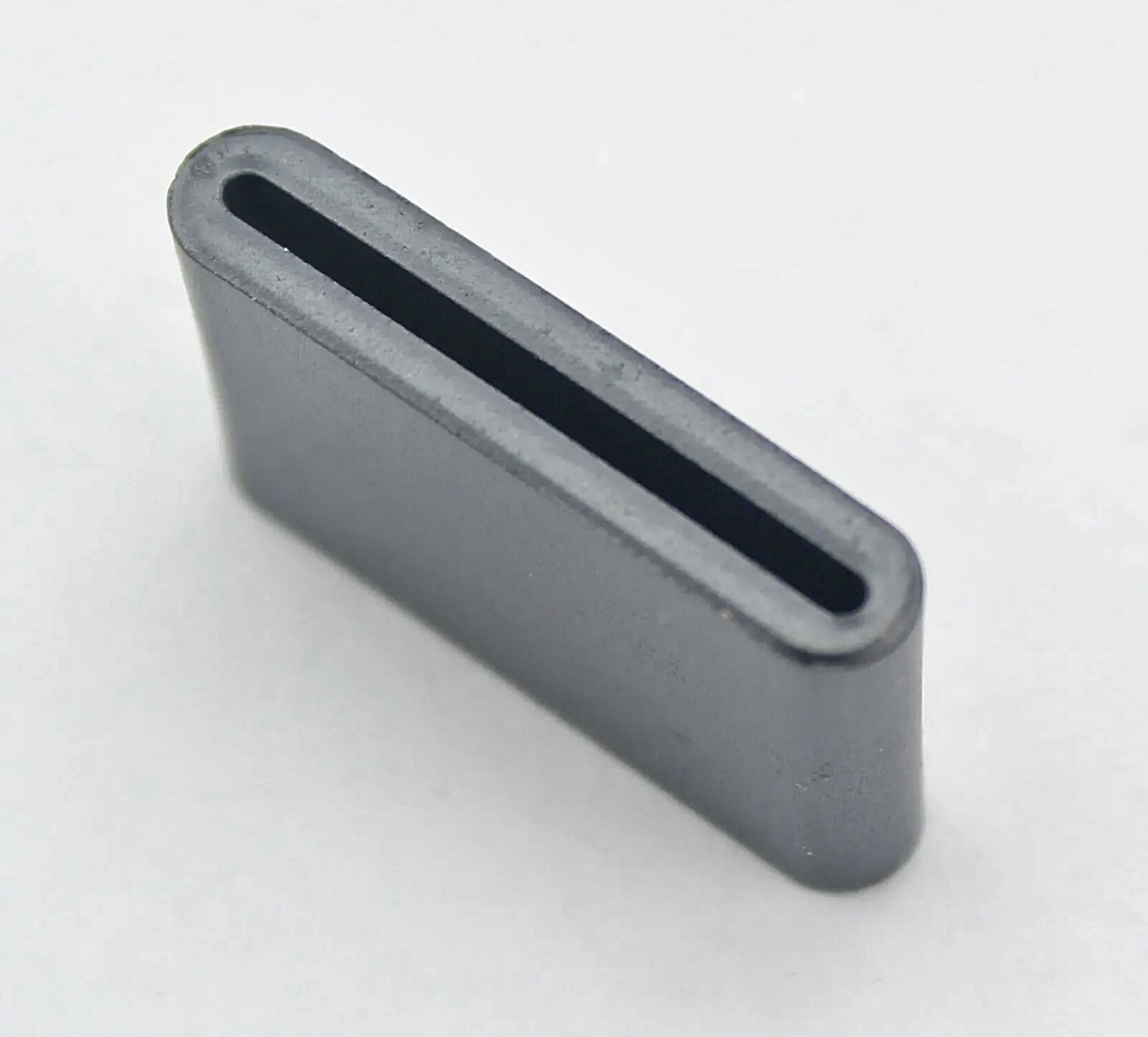

However, the ribbon-cable ferrites made some really nice improvements in space, dynamics, tonal purity, air, and blackness. Further, there is now zero audible difference between screen-off & screen-on, whereas before it sounded subtly better with the screen off. This is great, because I love having it on. :sunglasses::+1:
