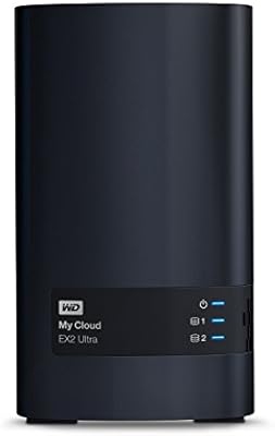

How is the L1 different from this product:
WD 4TB My Cloud EX2 Ultra Network Attached Storage - NAS
