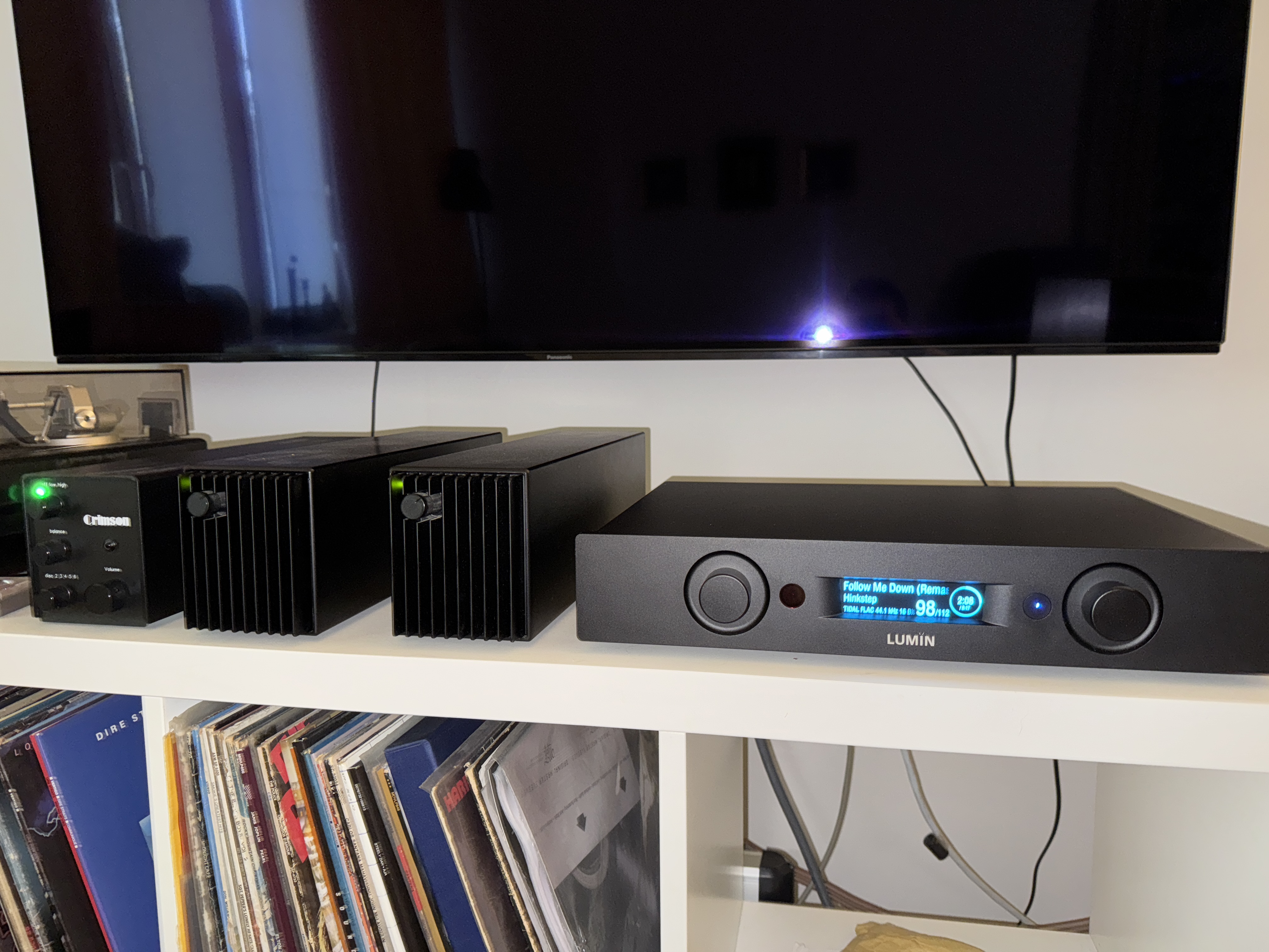

I noticed if I use the Lumin preamp and turned up to about 90%. It starts to distort. And it’s not loud at all. When I hook my preamp to the Lumin everything is fine. I can list to music much louder and no distortion. Could there be some power issue ?
You’re experiencing clipping.
Please state the brand and model of your amp and preamp, and whether you’re using XLR or RCA connection.
Crimson 610 preamp and 630c mono blocks.
For P1 (Mini) RCA connection to Crimson CS630C, in Lumin app please set Analog Output Level to Low, and a Maximum Volume % to 95.
I gave that a try yesterday setting analog output to low and that did help a little. But over all the volume is too low meaning even when I turn up the volume to 90 it’s not that loud. Not that I even like listening to loud music. When I use my preamp everything is great. At all volume levels.
RCA connections
Couldn’t ask why those settings you suggested?
Calculated by the input voltage sensitivity in specifications so that your downstream equipment is not getting a higher voltage signal that it cannot handle (i.e. clipping).
