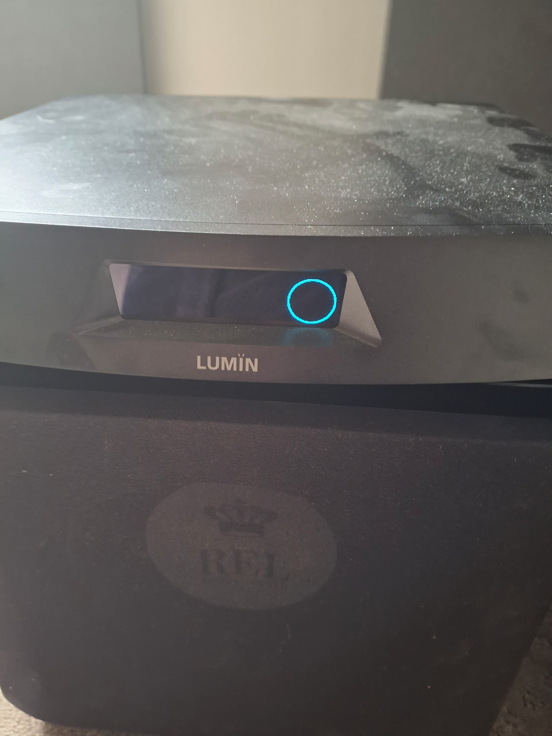

Hi Peter,
the pic shows its not Connect correct?
I have performed this:
If you are having Qobuz Connect discovery trouble, turn off Lumin Streaming (AirPlay) and Tidal Connect.
Turn off Qobuz Connect, wait for a few seconds, then turn it back on
If it still doesn’t work, wait for a minute, then power cycle the Lumin hardware
If all else fails, re-enable Lumin Streaming (AirPlay) and Tidal Connect. Check that your network infrastructure supports these discovery protocols using iOS AirPlay feature, and Tidal app (requires a paid Tidal account).
Especially if you have multiple Lumin devices, rename the Lumin device(s) to something different
and this: * Make sure you have a required Lumin model for Qobuz Connect: X1 P-series U-series T3X T3 T2 D3
  • Make sure you’re running Lumin Firmware 19 or later
  • Make sure Qobuz Connect setting is turned on in Lumin app (with the latest Lumin app version)
I dont know how to check qobuz app
Thank you for your help
Cheers
Andy
The picture shows you’re playing nothing. In Qobuz app Version 9, while playing a track, tap the speaker icon.

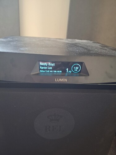

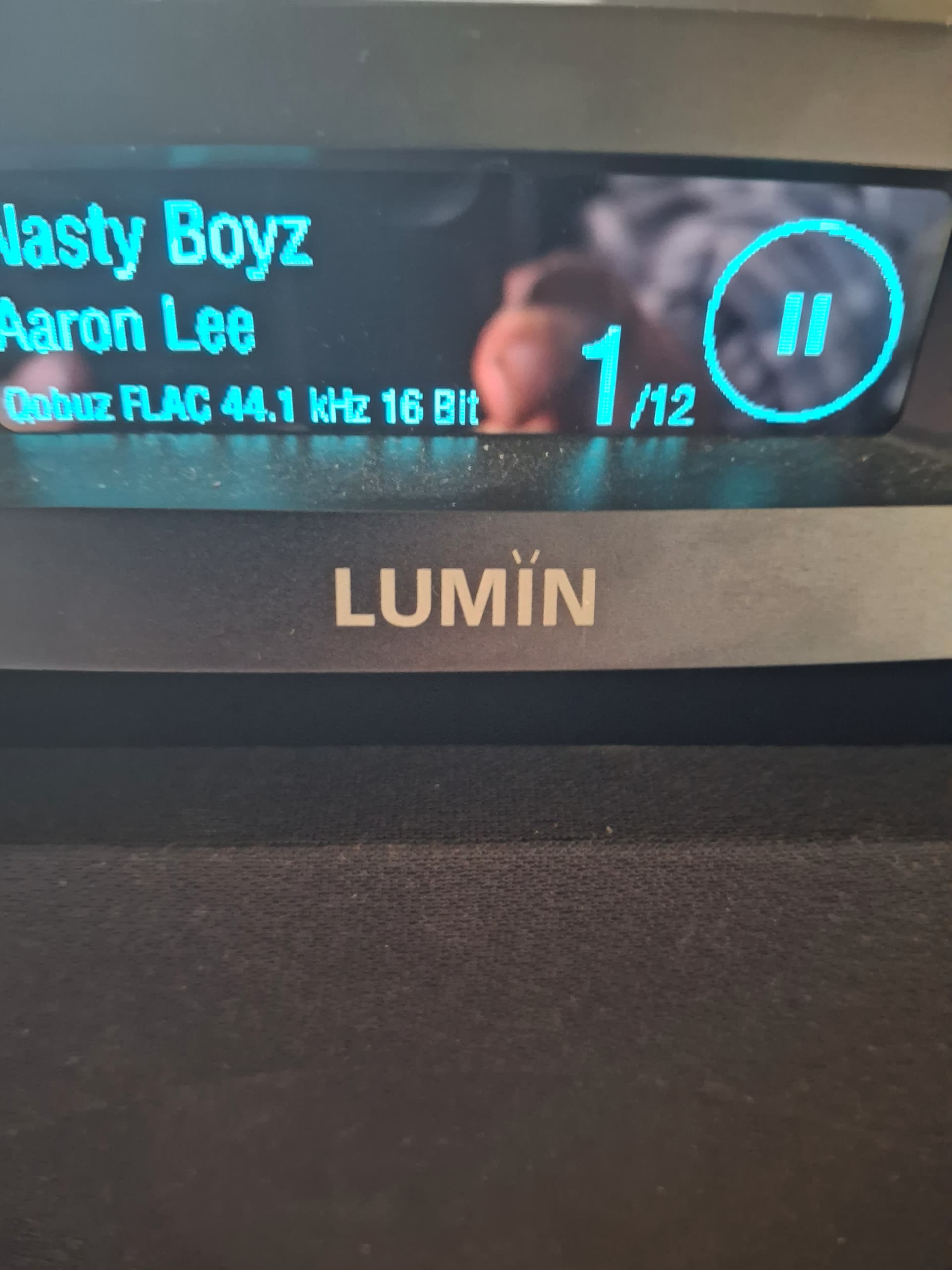

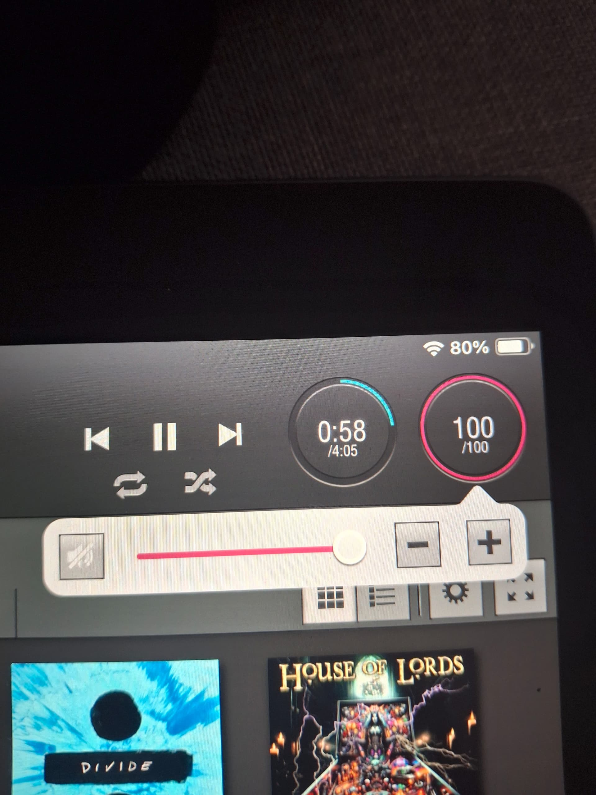

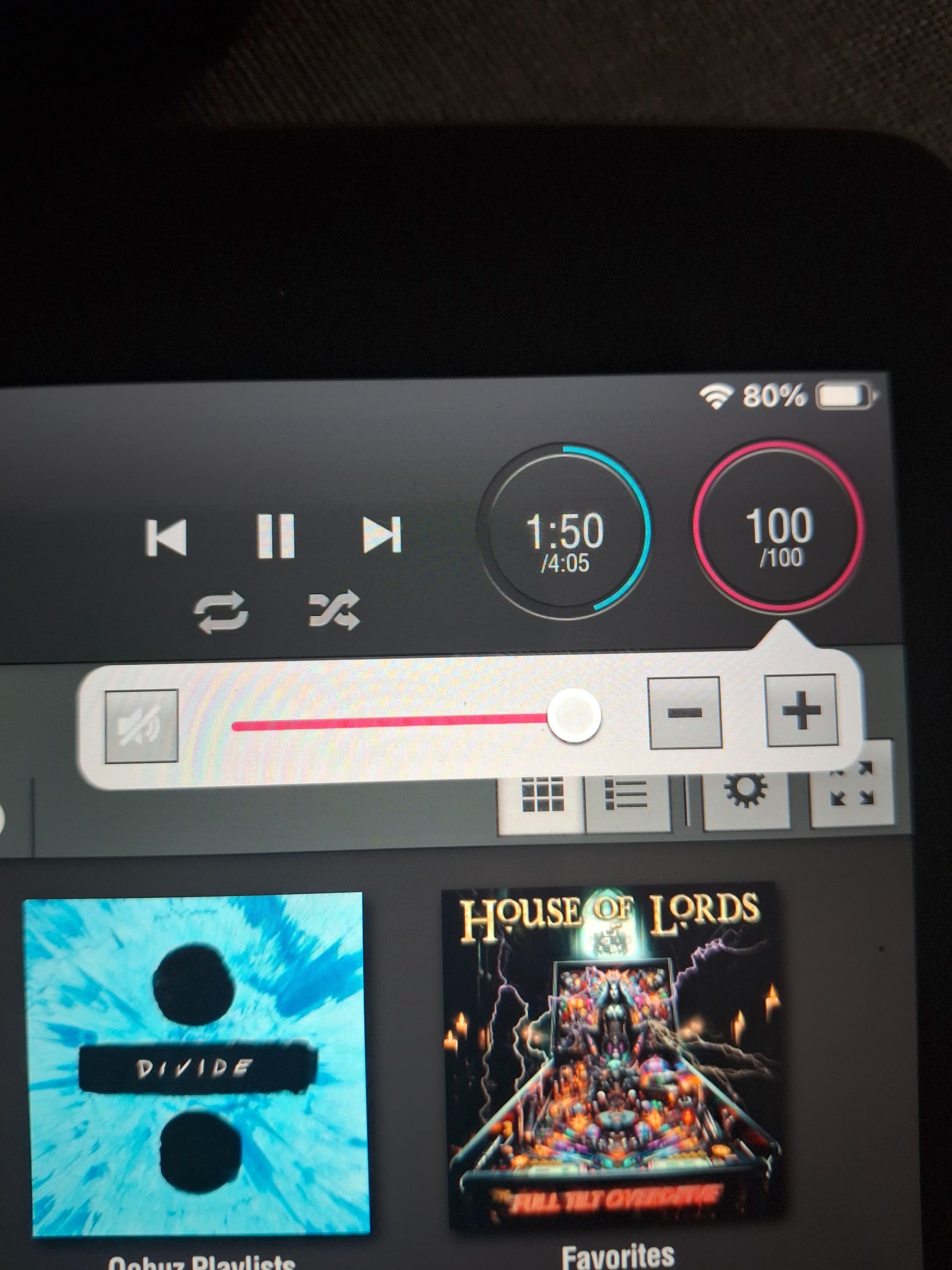

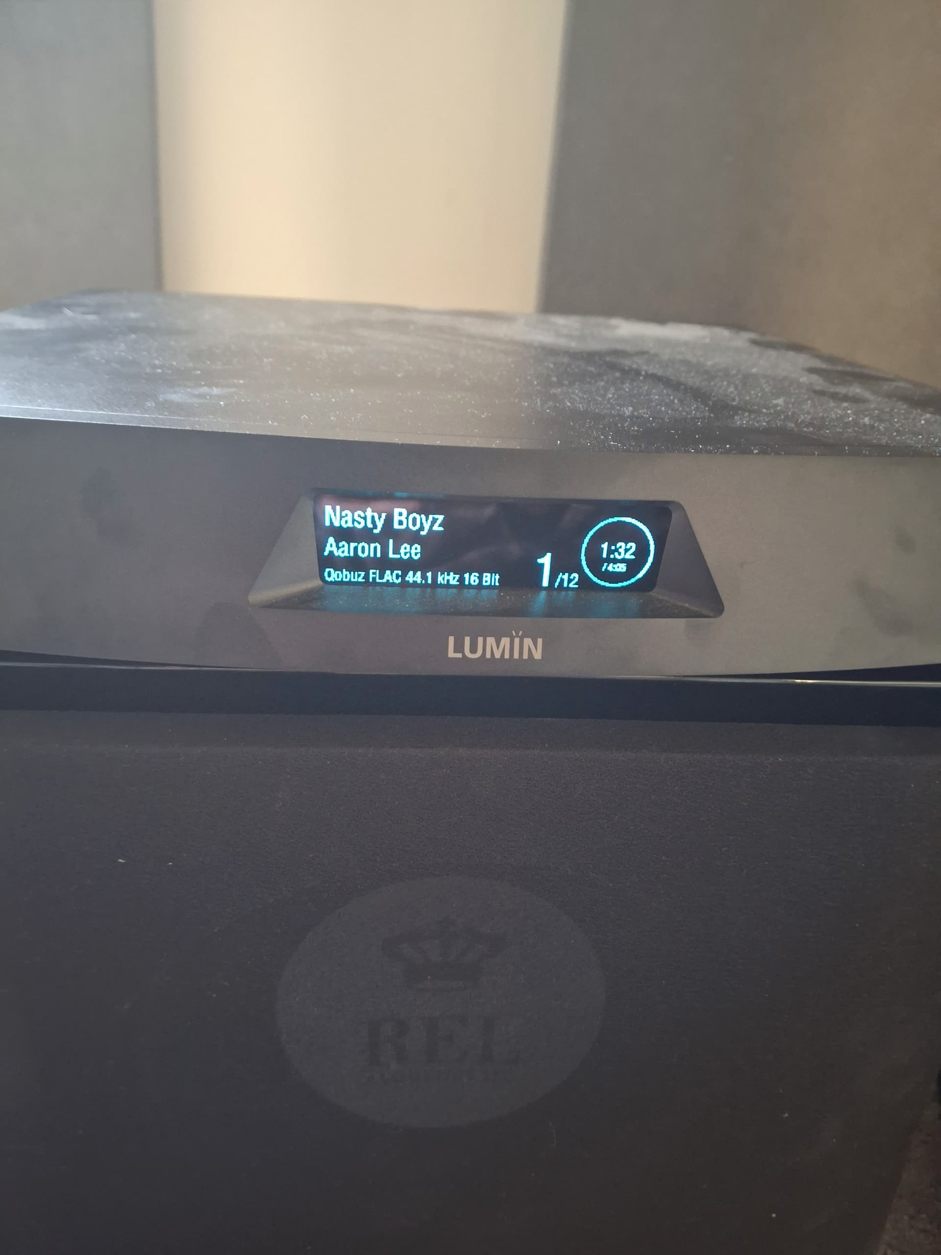

Are these the photos you are after Peter?
or maybe these:
