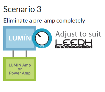

I run Roon on a Mac mini, into a Lumin U1 (then directly into my DAC then Power Amp, without pre-Amp), and configured the Roon Volume Control on the Lumin U1 as “Device Volume” to set volume with Lumin’s Leedh Processing implementation. When I check the signal path (which is otherwise qualified “Lossless”), it is now qualified as “High Quality”.

When I first got my D2, I also noticed that with Leedh turned on, the Roon signal path suggested the output was no longer lossless, hence the description changing from “lossless” to “high quality.” I left it like that for three years and never thought about it, but now I’m learning what Leedh is and why it’s there and seeing that @wklie confirmed the analog output is still lossless, I turned it back on. I have the configuration in the attached pic.
Screenshot 2025-04-13 011015
I suspect Roon won’t label it as lossless because Leedh is a proprietary tech and they don’t know what it’s doing to the signal, so they won’t guarantee that it’s bit perfect, but if that were the case, couldn’t you say the same about MQA? Roon does leave MQA as lossless.
Side tangent: I have power amps that have a fixed gain of 30dB, which I am now learning is way above average. So I’ve turned the D2 to low gain and changed Roon volume leveling up to -14 LUFS from -20LUFS. I suppose the less gain you have to add through the signal path, the less distortion there will be, and this configuration, with having Leedh back on, sounds really good. I’ve also recently added absorption panels to my room and got lower gauge speaker cables. In conclusion, if this hobby is all about tinkering and finding what sounds best, then it’s never too late to make improvements to your system!
