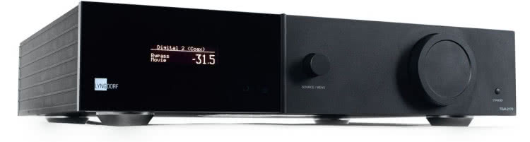

I would like to connect my allo usbridge to a lyngdorf tdai-2170.
lyngdorf tdai-2170 is not roon ready so i don’t know if i will have problem using it.
Can someone help me before i buy a new lyngdorf?
There is no USB input unless you buy the optional USB module.
Without that upgrade module, Allo’s USBBridge won’t work.
Perhaps Allo’s DigiOne?
Yes i know i would buy the usb module
If your using the Allo it doesn’t matter about the amp not being Roon Ready as the USB Bridge is when you install Roon Bridge. The amp will just act as a DAC.
The TDAI-2170 resamples everything to 96 kHz, so you may want to save the money for the USB card and get a streamer with SPDIF output instead. I use a Bluesound Node 2i, works like a charm.

where did you read that it resamples at 96khz?
the USB module info:
Streaming USB input module (≤384kHz/32 bit + DXD / DSD64 / DSD128)
I am using a TDAi-2170 with a USB module for several years now. I connected it to a Synology NAS with Roon Core running on it. The Synology NAS recognise the TDAi-2170 automatically.
This setup delivers a very good sound quality. I think this is because the USB module galvanic isolates ánd reclocks (!) the incoming signal. As with all other USB DAC’s it is important to use a good USB cable.
It also accepts 192/24 on the coax SPDIF input, but that doesn’t mean anything…Roomperfect seems to operate at 96 kHz.
Have a look at the frequency responses in the reviews below - they are limited to 48 kHz, indicating a 96 kHz sample rate:
There also is an old Roon community thread on this:
Finally, the coax SPDIF output operates at 96/24, no matter what the input signal is (I use a RME ADI-2 DAC to feed active speakers; there is no 2 channel Lyngdorf preamp, so that was my best oprtion back when I needed a fully digital replacement for my Lyngdorf RP-1).
But don’t let that dissuade you from buying the TDAI-2170 - the room correction works very well, and that has a far bigger impact than crazy bit depths / sample rates.
Resampling is an absolutely normal design for DSP room correction amplifier, DSP speaker or AV receivers, because it is completely unpractical otherwise, regardless of 384kHz PCM or DSD128 input. Some may have higher internal resampling rate, one popular DSP speaker (USD12500) resamples at 48kHz.
Trinnov ST2 does the same thing, and that are not cheap - but supposed to be very good.
